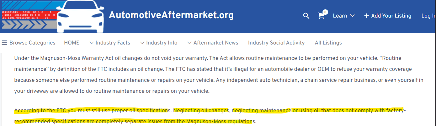

That danged M-M act gets tossed around like a rat by a pack of dogs but few have actually read it or the interpretations by the FTC and others. Here's the facts from an automotive after-market organization -
AMSOIL is MISLEADING by saying "you can use any brand you want" - well, in a SENSE you can, but IF and ONLY IF that other brand's oil meets the OEM specs for oil/fluids.
So they are telling you a lie of omission in AMSOIL marketing BS - they imply it's ok to use any oil. They leave out the part that says it still must meet specs. By saying you can use any brand oil (or other fluid) and leaving it at that, they are suggesting you can use their fluid even if it doesn't meet specs.
The M-M act only restricts on brands, trade names and so on - it doesn't prevent any manufacturer from requiring certain specs. It only says the maker can't restrict by name.
And AMSOIL is lying through their teeth when they say that you don't have to follow the manufacturer's maintenance interval - AMSOIL says you can extend it out if you wish and the M-M act says so. That's a crock. FTC says you must still follow maintenance intervals.
Jeep says no more than 10,000 miles for oil changes. AMSOILL says you can extend that out, it's your right, and the M-M act gives you that right.
Two lies from AMSOIL - even this organization says you must comply with specs and intervals.
