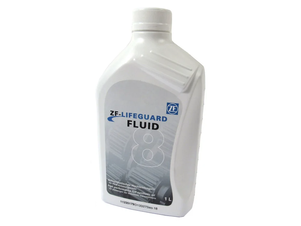

I can understand why someone might want to stick with ZF Lifeguard fluid, especially those of us with a 5 year/100,000-mile powertrain warranty. I had the fluid changed at 89,167 miles and took a sample:
Manufacturer: ZF
Component ID: 8HP70 T
Secondary ID: Ram 1500 EcoDiesel
Product Name: LifeGuard Fluid
Date Sampled: 10/22/2020
Lube Time: 89,167 miles
Unit Time: 89,167 miles
Lube Changed: Yes
Filter Changed: Yes
"Flagged data does not indicate an immediate need for maintenance action. Continue to observe the trend and monitor equipment and fluid conditions. Bushing/Thrust metal is at a MODERATE LEVEL; Aluminum is at a MODERATE LEVEL; ALUMINUM source in GEAR SYSTEMS may be BUSHING/THRUST metal, ALUMINA SILICA (Dirt), HOUSING metal or contamination from ALUMINUM COMPLEX GREASE; Gear and/or bearing metal is at a MINOR LEVEL; Please submit a new (unused) sample of this fluid for BASELINE REFERENCE. Lubricant and filter change acknowledged"
Wear Metals
Iron (185 ppm) - Flagged on High End of the Normal scale
Chromium (0 ppm)
Nickel (0 ppm)
Aluminum (47 ppm) - Flagged on Low End of the Abnormal scale
Copper (71 ppm) - Flagged on High End of the Normal scale
Lead (1 ppm)
Tin (4 ppm) - Flagged on Low end of the Abnormal scale
Cadmium (0 ppm)
Silver (0 ppm)
Vanadium (0 ppm)
Contaminant Metals
Silicon (10 ppm)
Sodium (6 ppm)
Potassium (4 ppm)
Multi-Source Metals
Titanium (0 ppm)
Molybdenum (0 ppm)
Antimony (0 ppm)
Manganese (2 ppm)
Lithium (0 ppm)
Boron (150 ppm)
Additive Metals
Magnesium (2 ppm)
Calcium (533 ppm)
Barium (0 ppm)
Phosphorus (550 ppm)
Zinc (6 ppm)
Fluid Properties
Viscosity (5.1 cSt)
Acid Number (1.37 mg KOH/g)
Oxidation (20 abs/cm)
Jeep Gladiator FCA Canada voids transmission warranty for using AMSOIL. S671.090.312-01
