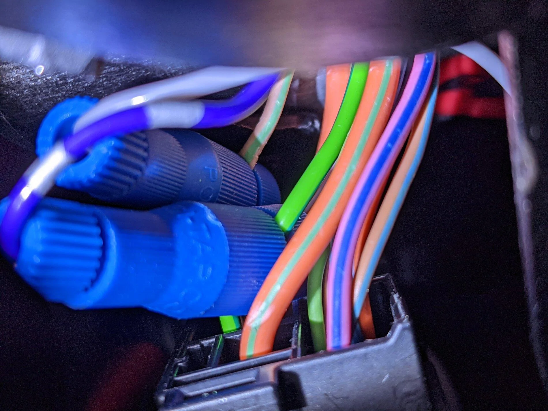

Kinda bummed.... Took the trouble to follow instructions,rip apart everything required, tap wires, put it all back together and nothing windows operate normally, I get nothing from the key fob sequence...... Was gonna do a reverse install and start with the wire taps......
Jeep Gladiator FINALLY Automatic UP/DOWN ALL windows! PXL_20210308_004524798
have I got the correct wires? Checked power with meter, haven't checked the 25 amp inline fuse yet, that seems excessive but guess I could've blown it..

Update, rechecked the posi taps and now it's working........... Now I'm big pimping like the cool kids! Thanks again for the write up on install, those pics were clear as a bell, better than their video and still haven't found any written instructions!
Glad you got it working…still amazes me that we have to do something like this when it should come like this from the factory.
