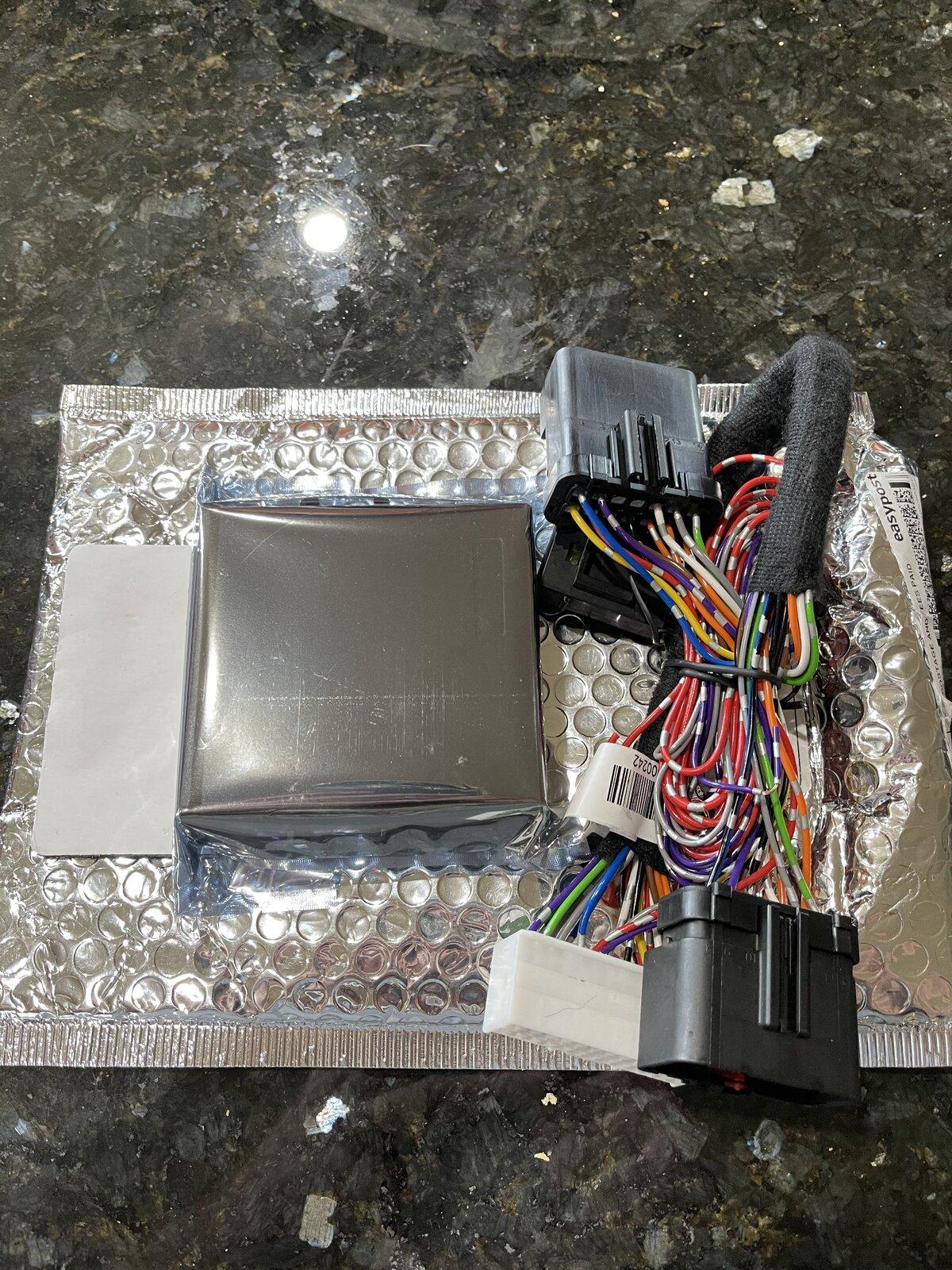

My module arrived today, so I got it installed. I had already modified the 12V power plug for constant 12V, and I added something like this:
https://smile.amazon.com/Power-Adapter-2018-2020-Wrangler-Gladiator/dp/B0886DNNSP
today to facilitate wiring the 12V (it also gives me a very convenient 12V tap for the future.)
Anyway, all went well following this thread...
https://www.jeepgladiatorforum.com/forum/threads/jt-3wliners-window-control-module-install.40950/
...and once I remembered to plug in the 12V fuse (D'OH!) it all worked fine.
I discovered that not only can you control global window functions from the remote, and with the exterior front door handles (provided you've the Proximity Entry option or mod.,) the interior door lock buttons will also control the windows.
So, want all the windows down while sitting inside? Unlock, lock, unlock, and down they go!
Cruising around with the windows down & it starts to rain? Double tap the lock button, and up they go!
