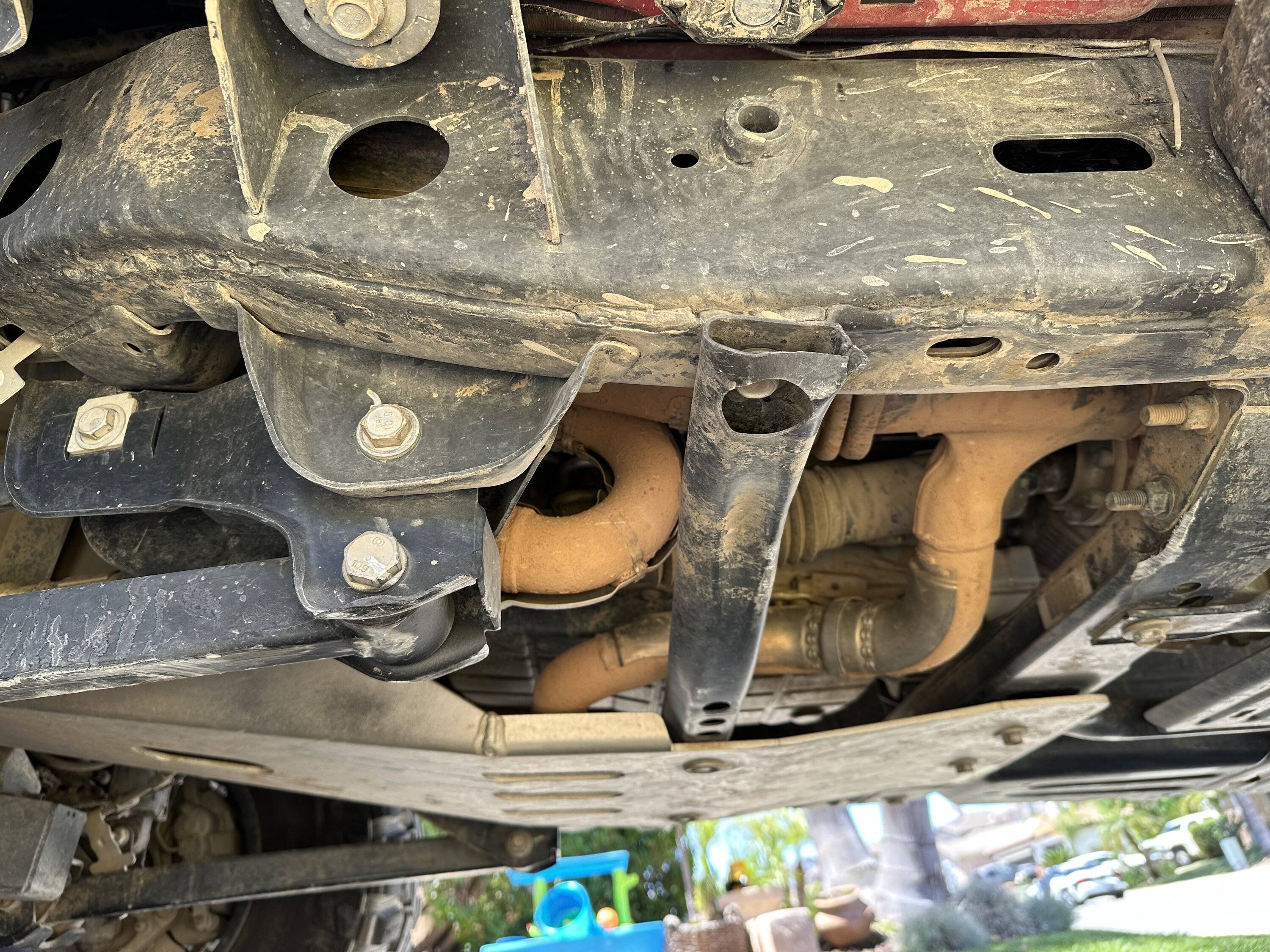

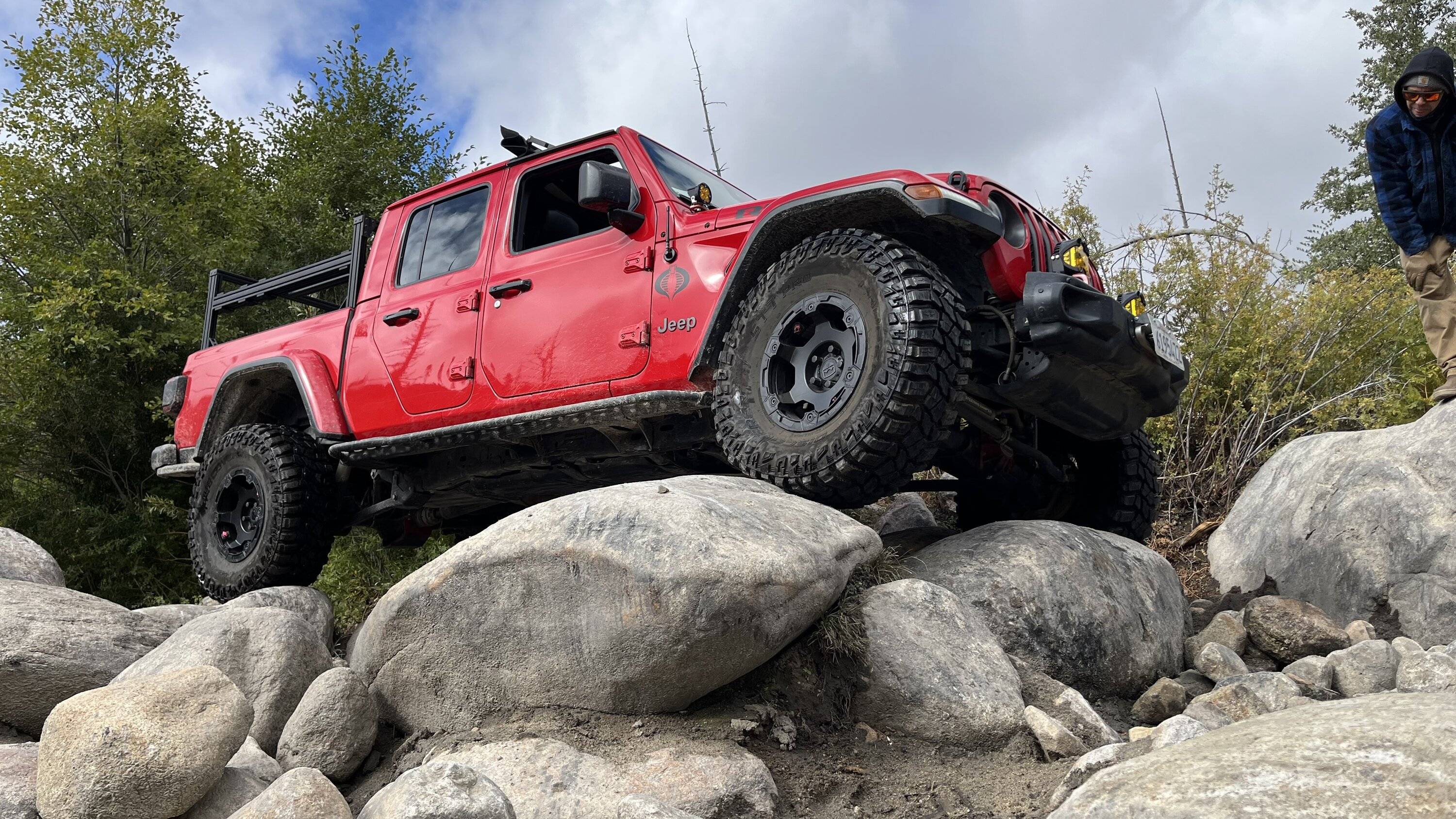

As far as hitting things, brackets are not as low as your diffs, frame, rock sliders, belly on breakover, etc. I’ve hit them once or twice on badge trails when I basically had the whole belly hitting boulders. And those other spots hit about 50 times more often, most trips don’t touch the brackets but rip up my sliders or diff skids or whatever. There are zero situations where you would hit a geometry bracket and not also grind on your frame or rock slider, or more.
I can appreciate that people may justify other options, but do NOT believe the brackets are off limits for rock crawlers.
You already have arms so drive it and see if you like it and leave it alone if you do.?‍♂
Jeep Gladiator Finally geometry brackets data IMG_3933
Jeep Gladiator Finally geometry brackets data IMG_2012
Edit: pic is to show those brackets are the least scratched thing on the whole jeep?

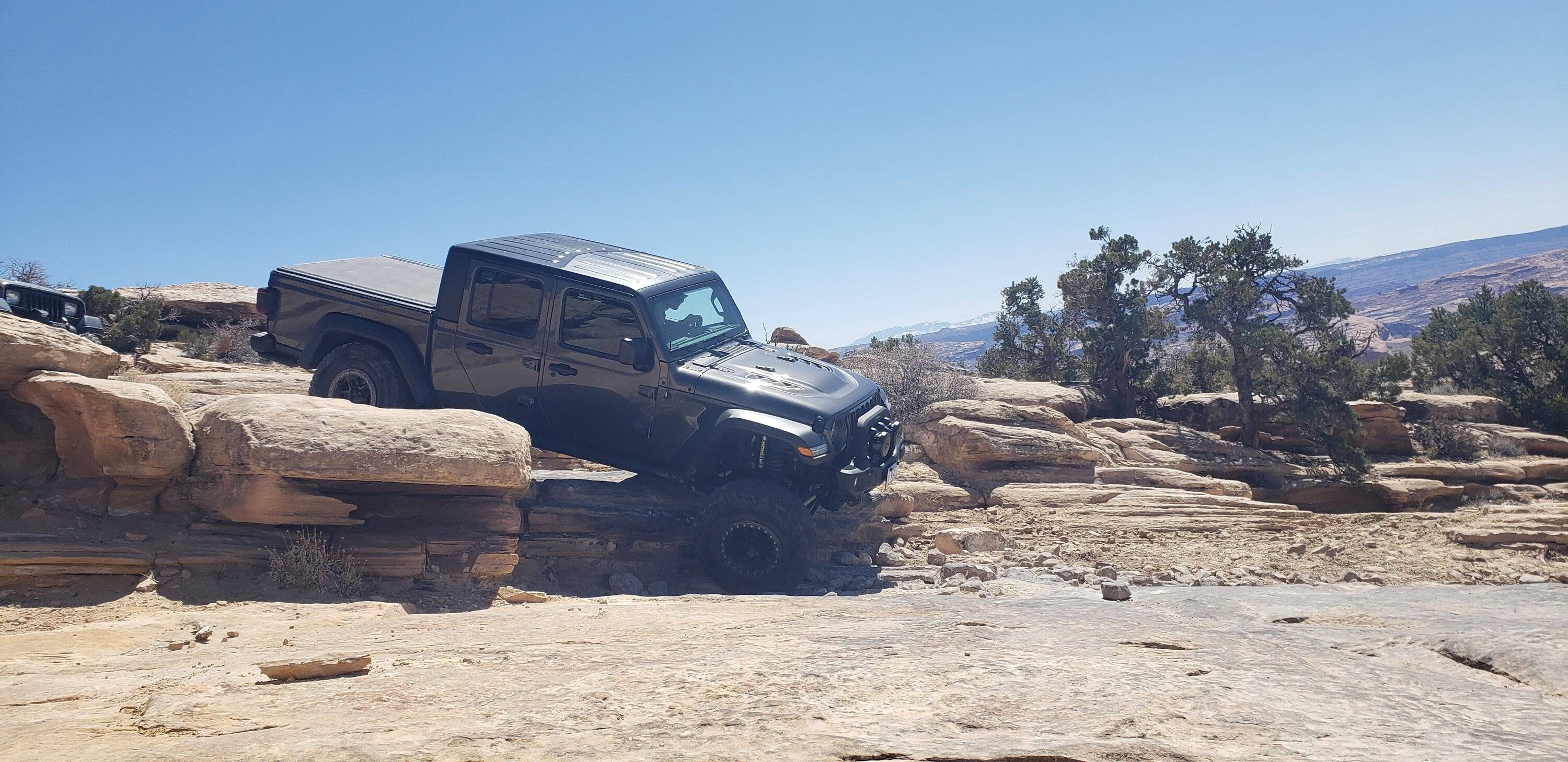

I took my AEV brackets up Potts Mt. in Va. (there’s a Mall at the top of the mountain). It’s supposedly the hardest trail in the state with lots of rock gardens. It’s not Gladiator friendly. It breaks heavily modified rigs. I ran it alone. I scraped up a few things under the truck on 37s. Yes, the brackets got dinged and scratched.
Jeep Gladiator Finally geometry brackets data 1701019676182
Here’s another thing to think about. Some people (me) prefer these brackets for a secondary reason other than being sacrificial: I get to keep running stock control arms that ARE NOT adjustable. I greatly prefer this to adjustable control arms because I’ve had multiple adjustable lower control arms fail on past Jeeps with long arm lifts, at the threaded adjuster. This happened with zero outside evidence of a problem, they were lubricated and the lock nut was tight and checked routinely. I’m a maintenance obsessive. I don’t live in the northeast where they frequently salt the roads. I will always run non-adjustable control arms if I can. I wish more manufactures (any?) would simply set the length for caster and make their LCAs non-adjustable. If you have adjustable control arms, you should take them off and inspect them regularly. I don’t have to worry about any of that with my stock control arms.
I DO have to worry about the FAD which anyone not running aftermarket axles should be much more concerned with than drop brackets. I remember the good old days when part of the whole off roading thing was applying skill to avoid the more sensitive parts of a vehicle rather than fruitlessly trying to eliminate every dangly bit on your rig.
