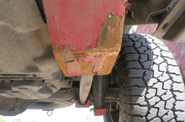

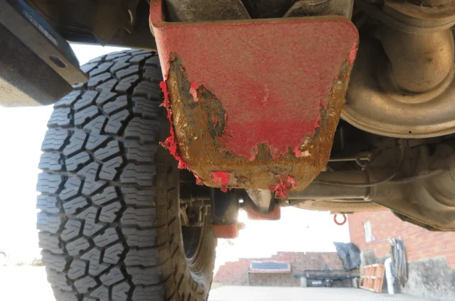

It's the break over point where the brackets will get hit. This is what everyone forgets about.
Yeah, they’re not in a great spot, but neither are the stock brackets. After Potts mountain I considered welding on some $40 skid control arm plates but never got around to it. Maybe in the spring. I came down hard on mine. There’s quite a bit of lip protecting the control arm joint itself (the part to be concerned about) on the AEV brackets. Mine got scratched and the very ends a wee bit dented. Not bad for coming hard off a rock with probably 1500lbs of gear in the back and a heavy diesel in the front. I hit em’ with some touch up paint. They had zero issue supporting 1/2 the weight of the truck. The bigger concern to me is them gouging into the rock rather than sliding off of it, hence the skids. I definitely don’t think they’re a liability that will get someone stuck or stranded.
I’ve slid down boulders on my front long arms on my TJ lots of times and scratched them all up. To me all of this is just par for the course when rock crawling. Smashing into control arms and control arm brackets just happens. Neither are the components that concern me breaking when off roading since either typically has no problem supporting the weight of the vehicle. In my experience, wheeling both Wranglers and now the Gladiator, they’re the least of my concern. I’m much more concerned about high centering in the middle of the truck on the skid plate or frame cross member and getting stuck because it’s so damn long. I’d much rather hit the LCA bracket because I can leverage or winch myself off of that. Also, they’re following the track of the tires. It’s all that shit in the center that doesn’t follow the tires which people should be worried about. My spring plan includes a full belly skid from Next Venture for this reason. I’d spend the money on that and diff sliders before worrying about the control arms or brackets beyond some cheap LCA skids.

There is other parts of the JT that get beat on other then the geo brackets. The rear front lower control arm mounts take a beating.
