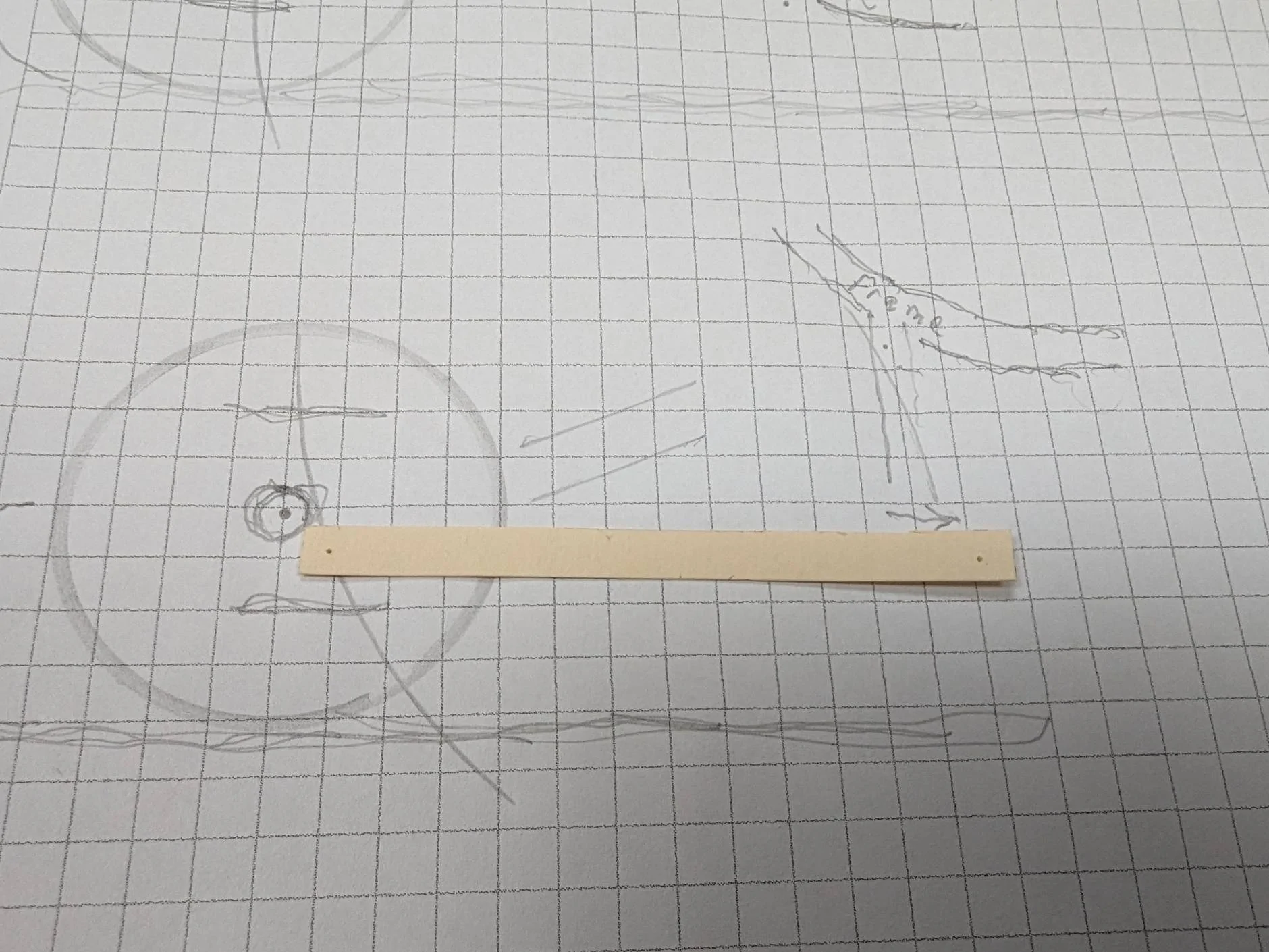

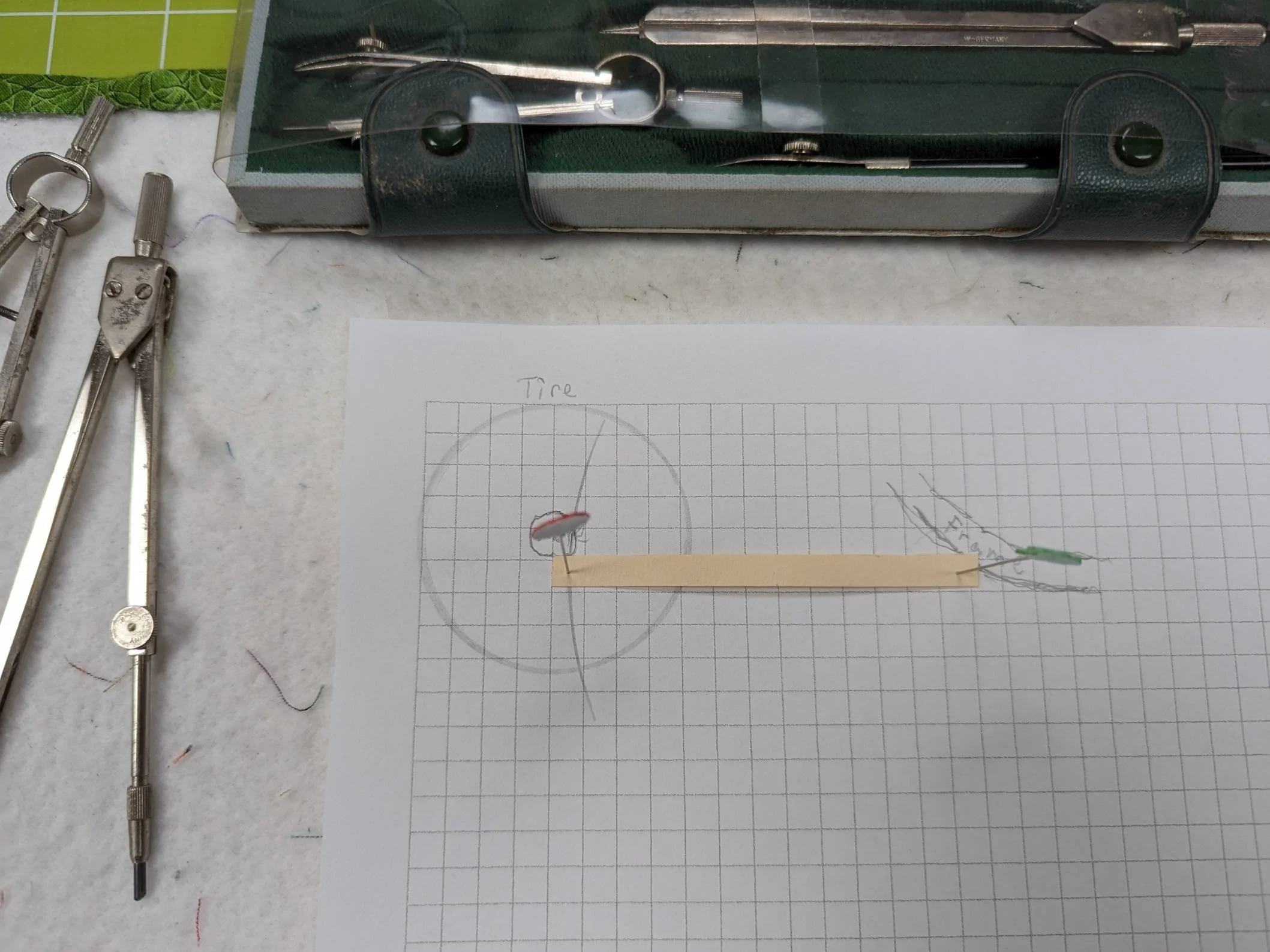

I hope my extremely crude drawings will help those who tend to "get it" with visuals or pictures.
I'm that sort - once I see it, I've got it. For me a picture can be worth a whole book of explanations.
I "borrowed" my wife's quilting prototype board - don't tell her of the pin holes it has in it now.
I dug out some of my old drafting tools to make lines I could not draw out on my best day.
Sorry, today is one of those extreme dizzy migraine days and the tremors are horrible on days like this so lines are terribly squiggly and rough.

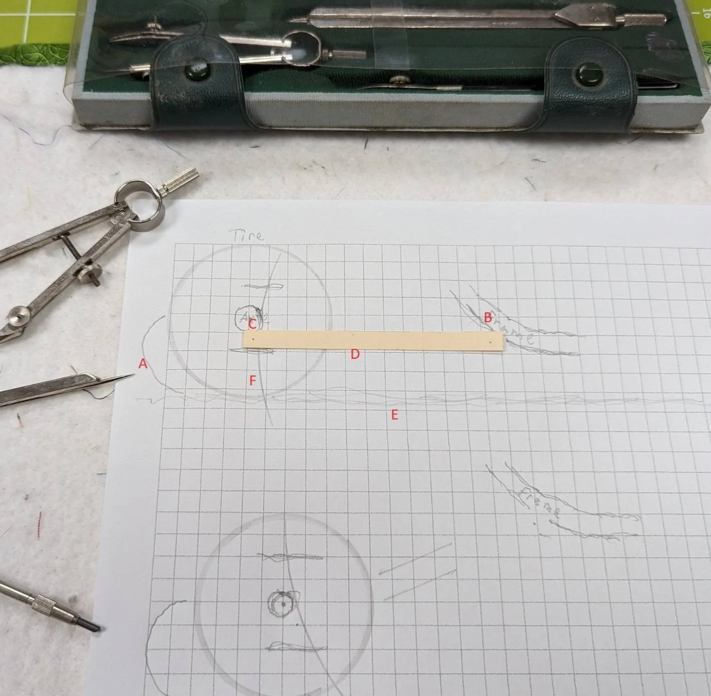

We'll start with my very rough rendition of a "Jeep" showing the lower control arm (D), frame (B), axle (C), tire, ground (E) and finally the arc the axle, and thus tire, swings as it goes up and down over holes and bumps (F)
A is stuff like rocks and bumps in the road, anything that pushes back against the tire rather than simply rolling smoothly under it. So - this can apply on the highway around Indianapolis or some off-roading, lumber trails and so on as well as a decent stretch of road.

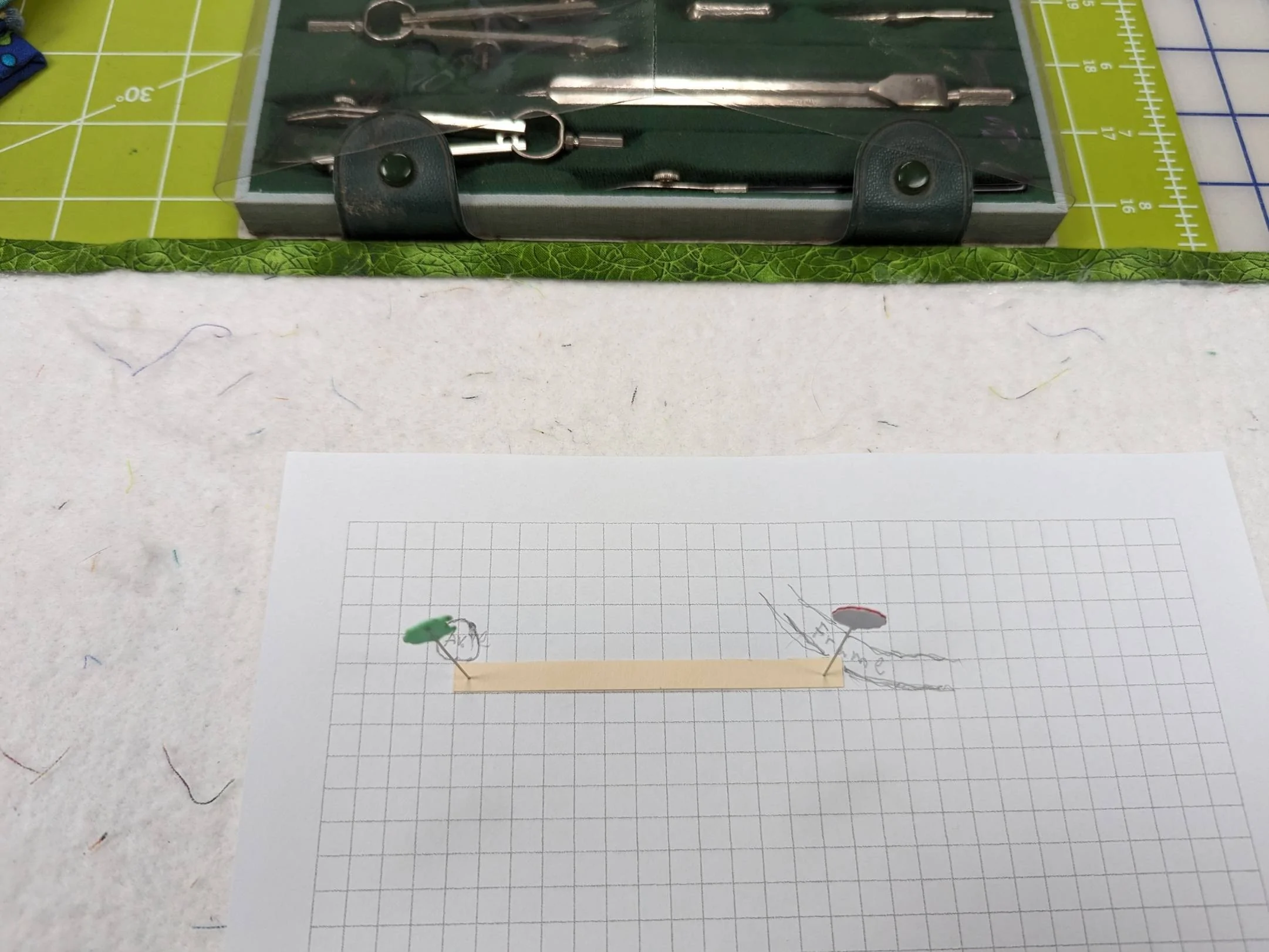

As it comes factory - the control arms are parallel to the ground for the most part. (and ideally, parallel to each other - top picture. The snip of file folder is the control arm. The pin holes are where the bolts go through holding it to the frame and axle.
Note as the axle moves up and down (I have drawn short horizontal lines for that up and down movement) how little it swings forward or rearward. It's nearly straight up and down along the line F which is the arc in which the axle would travel, pivoting at the frame mounting point B.

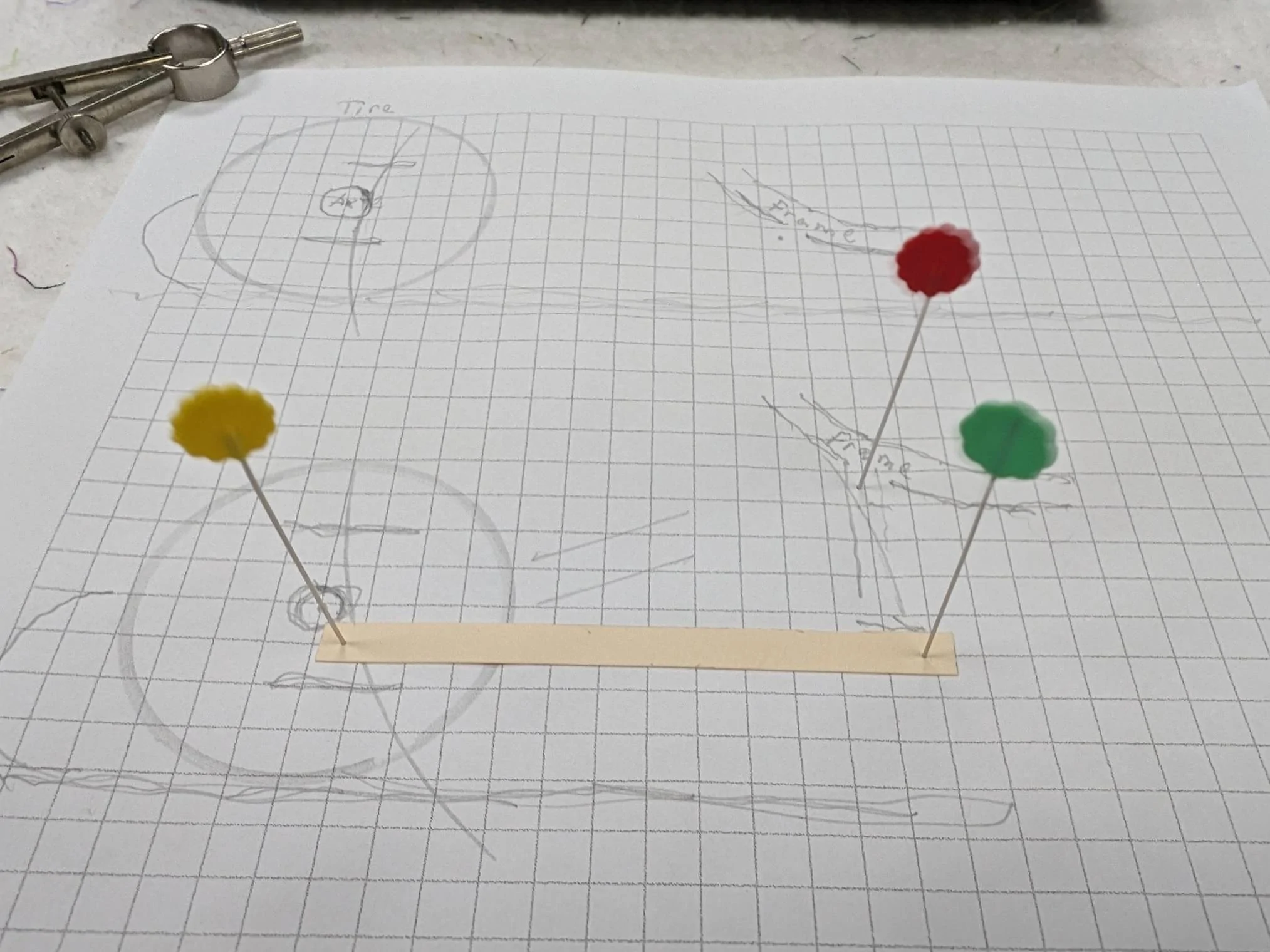

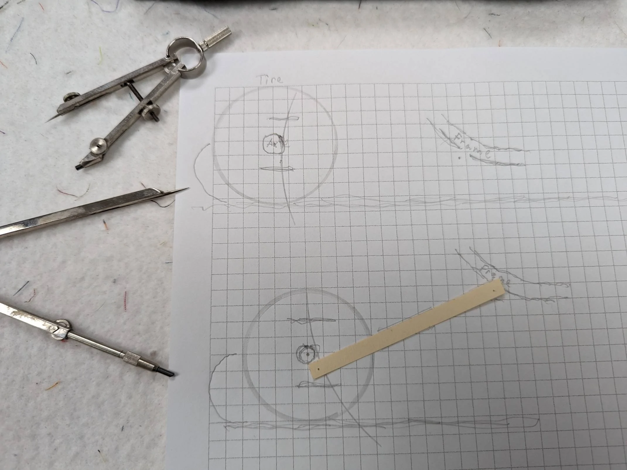

Now add a lift - the axle sits a lot lower below the frame, the swing in the arc of the control arm pulls the bottom of the axle back, removing caster (caster is the tilt forward or backward of the upper ball joint compared to the lower ball joint)
Jeep Gladiator Finally geometry brackets data PXL_20231128_145852552
Jeep Gladiator Finally geometry brackets data PXL_20231128_150102797
Note on the far left I have sort of crescent lines, I marked one as A above for reference.
Compare the top drawing to the bottom.
Forces acting against the tire in the top picture will tend to life the tire and go under - not a lot of force will be transmitted back to the frame as things tend to simply run under.
On the bottom picture, the same things will want to push back against the tire - less able to lift and simply go under it. Force will be transmitted to the frame. A large enough object will want to push the vehicle upward through the angle of the control arm. Harder on things, rougher ride, less controlled, less smooth - on and off the road.
Note the arc the axle swings in now - a lot more rearward and forward movement, less straight up and down as the axle moves up and down over the rough.

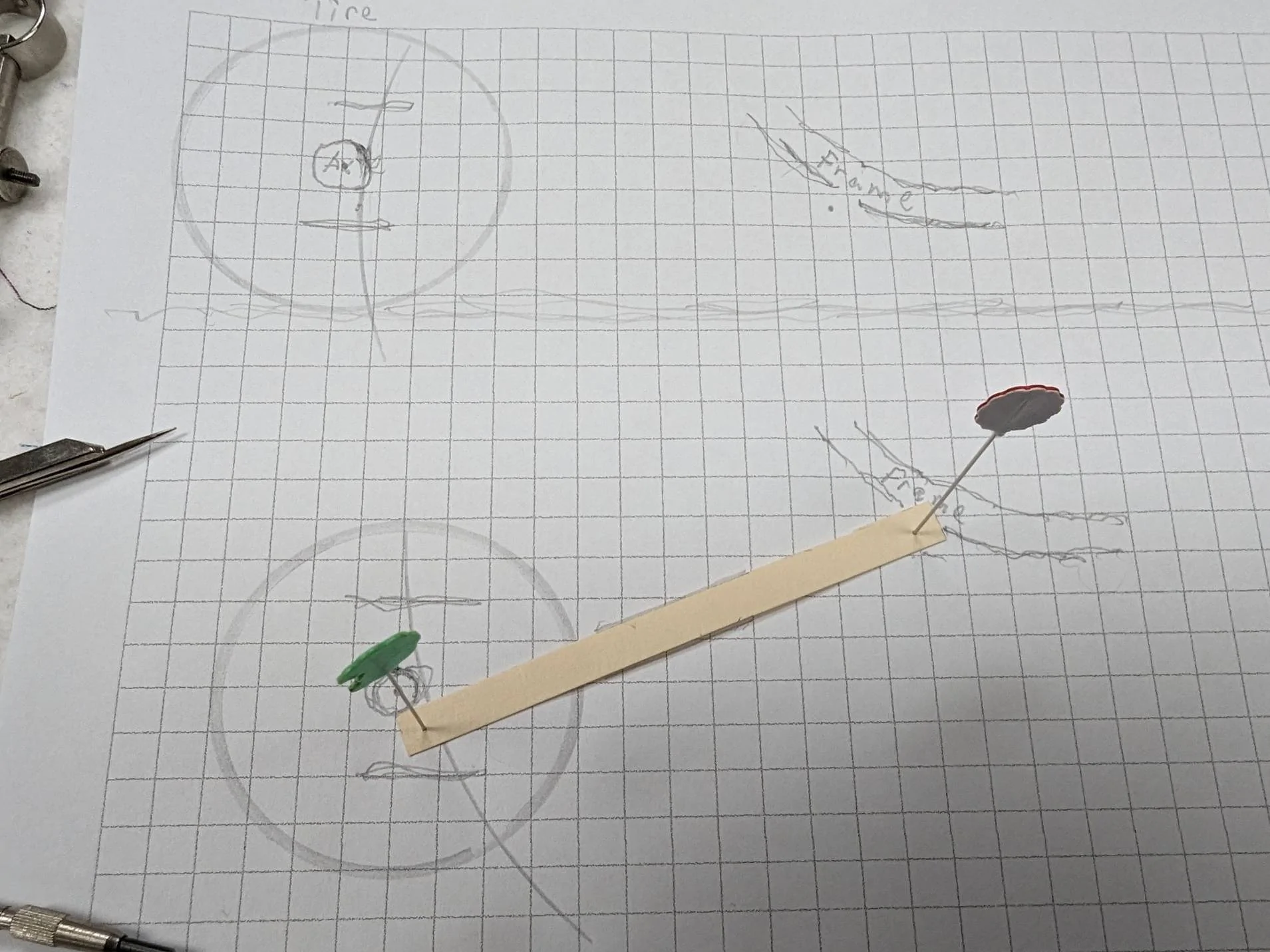

Now add geometry correcting brackets and move the arm more parallel with the ground again, compensating for the lift.
Red pin is the original attachment point to the frame. Note how the arm swings in an arc as you move it downward to attach to the bracket sitting lower - it moves rearward as well. Since the bracket hole is straight down from the frame hole (well, mostly, some vary) this means the control arm is pushed forward, moving the lower part of the axle forward again, putting the caster back in that was lost when the axle went down with the lift.
Now as the axle moves up and down, with the control arm being more level or even with the ground, it won't move forward and backward as much, it will move more straight up and down and obstacles will again tend to want to roll under the tire and not shove up against the frame through an angled control arm.
Jeep Gladiator Finally geometry brackets data PXL_20231128_150902993.LONG_EXPOSURE-01.COVER
So - it's hard to separate what they do totally - correct geometry, put the swing back into the correct part of the arc so there's not so much forward/rearward movement as things move up and down and put caster back because moving the rear end of the lower control arm DOWN forces things forward on the bottom of the axle, twisting the bottom of the axle forward, giving more caster.

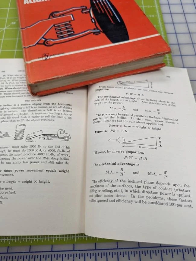

For kicks, my other chicken scratches and photos in case anyone finds them even 0.0005391% helpful...........

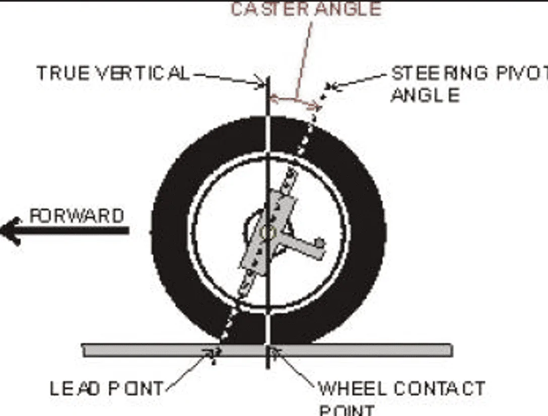

For reference - CASTER -
Because the tire's contact point is trailing the lead point, or the point from which the tire is being moved forward, the tire wants to follow straight. The more caster (TO A POINT) the more the tire wants to follow directly behind the lead point, or the line drawn through the ball joints (or king pins on a large or older truck, etc.)
It gets hairy and complex because other angles and yeah, geometry, interacts with caster, but to the point most of us have or need caster, it means that if forces try to move that tire off of a line directly behind the "lead point", the more it wants to fall back into line like a well disciplined marching band member.

Skip to 6:37.
Where the front tire is going up and over The ledge. Now reference again the above photo, object A, and the arc pattern in the below sketch of a lift with longer arms only. You should notice that because the arc pattern of the axle and wheel is different due to the control arm lift, before the axle and wheel can go up, it first must go forward a little bit. So due to this, additional force is being placed on all your components as the tire is forced into the obstacle even harder before the suspension can collapse and allow the axle to go over the obstacle.
This whole situation is also, in part, why long arm kits were made for the TJ. To reduce that steep angle and that forward axle arc movement before it collapses upwards to clear obstacles.
So in addition to the arms transmitting force into the frame, this just adds to that effect. And further, this is in part why independent suspensions are smoother and typically more comfortable than solid axle as the arc or travel of a IFS is not perpendicular to an obstacle, but more straight vertical.
