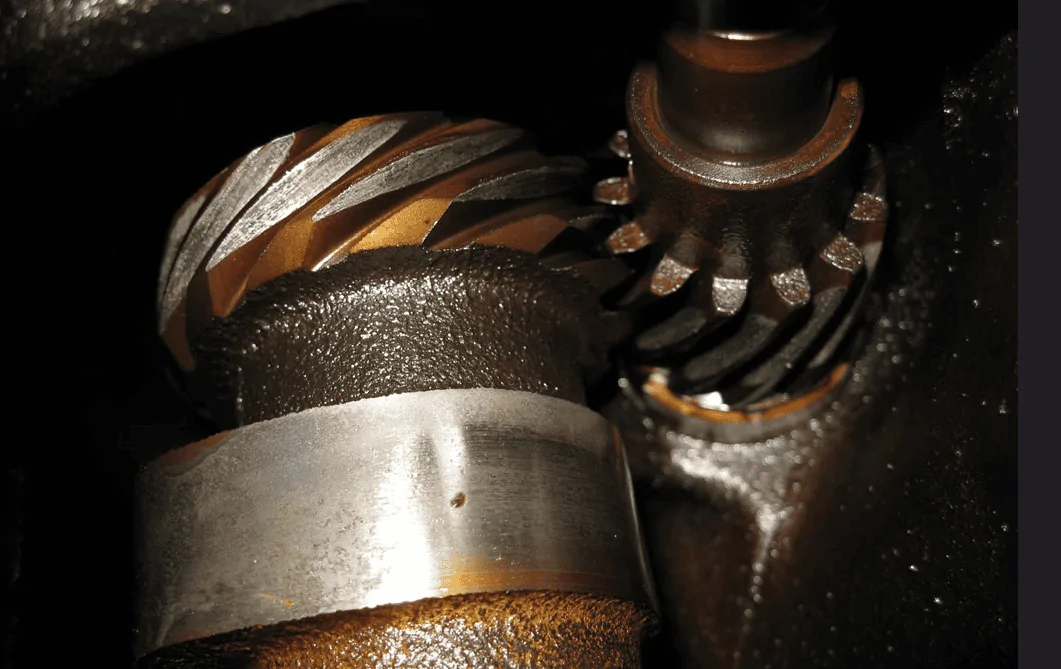

Maybe this guy's Jeep wouldn't have left him stranded........ metal particles so small a filter won't catch it will cut other parts as it circulates with the oil. He ended up toasting the oil pump, too as it's the first thing that sees the oil that these particles before a filter might catch it if it could.
What could have a series oil analysis' have done that would have prevented this failure? Would the owner have parked the car and rebuilt it? Maybe. I still don't see where the ROI is here.
When you find something out of the ordinary or abnormal, you troubleshoot, look into it.
It was too late and I didn't really care about the chicken or the egg in this case, but the wear could have been caught - and maybe negated a need to grind the crank, or bore the cylinders, whatever.
There's a reason fleet owners go through the process and keep records.
Maybe a better example is the engine from the 83 SX4 my son bought - the wear was so bad it ended up being a complete rebuild with new crankshaft and more. Likely the crankshaft could have been saved.
You can't just use the oil reports alone, you have to combine them with some skills and diagnostics abilities.
Silicone in the oil - look for a reason - air filter type, maybe a leak in the air intake system pulling dirty air, improperly installed or seated filter.
It's really hard to cover decades of troubleshooting and diagnostics in a forum post. You have to combine the reports with other abilities and tools.
If I sent in a sample and it showed abnormal amounts of certain metals - I might be inclined to pull a valve cover..........knowing that almost any failure in these things that results in metals in the oil is most likely valve train related.
If I had been doing oil analysis on my 70 Javelin 390, I'd have saved myself needing to sleeve 4 of 8 cylinders, saving a few hundred bucks. Instead, naw, it's just a minor misfire. No biggy.
The result - new pistons, 4 sleeves, cam and lifters, crank grind, etc.
