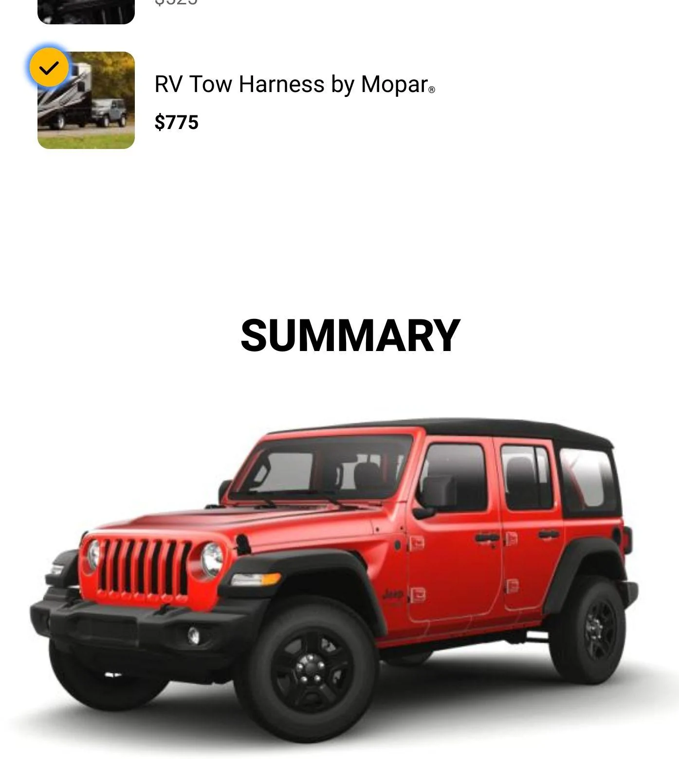

Mopar offers a flat tow setup on the Wrangler now. Since the front end is the same, I think it would fit. Maybe @AllMoparParts.com can help you out? It's $775 if you order a JL with it. But after sale, I don't know the pricing.
Is that for the entire set-up (connection points, brakes, lights,) or just for the light wiring harness?
That is for a wiring harness. I know after 2013. Jeep Grand Cherokees needed a wiring harness installed to be flat towed because of the electric power steering pump. Wonder if the same applies with the JT. My 2013 didn't need the harness
I don’t run the steering pump on mine, and it tows OK.
