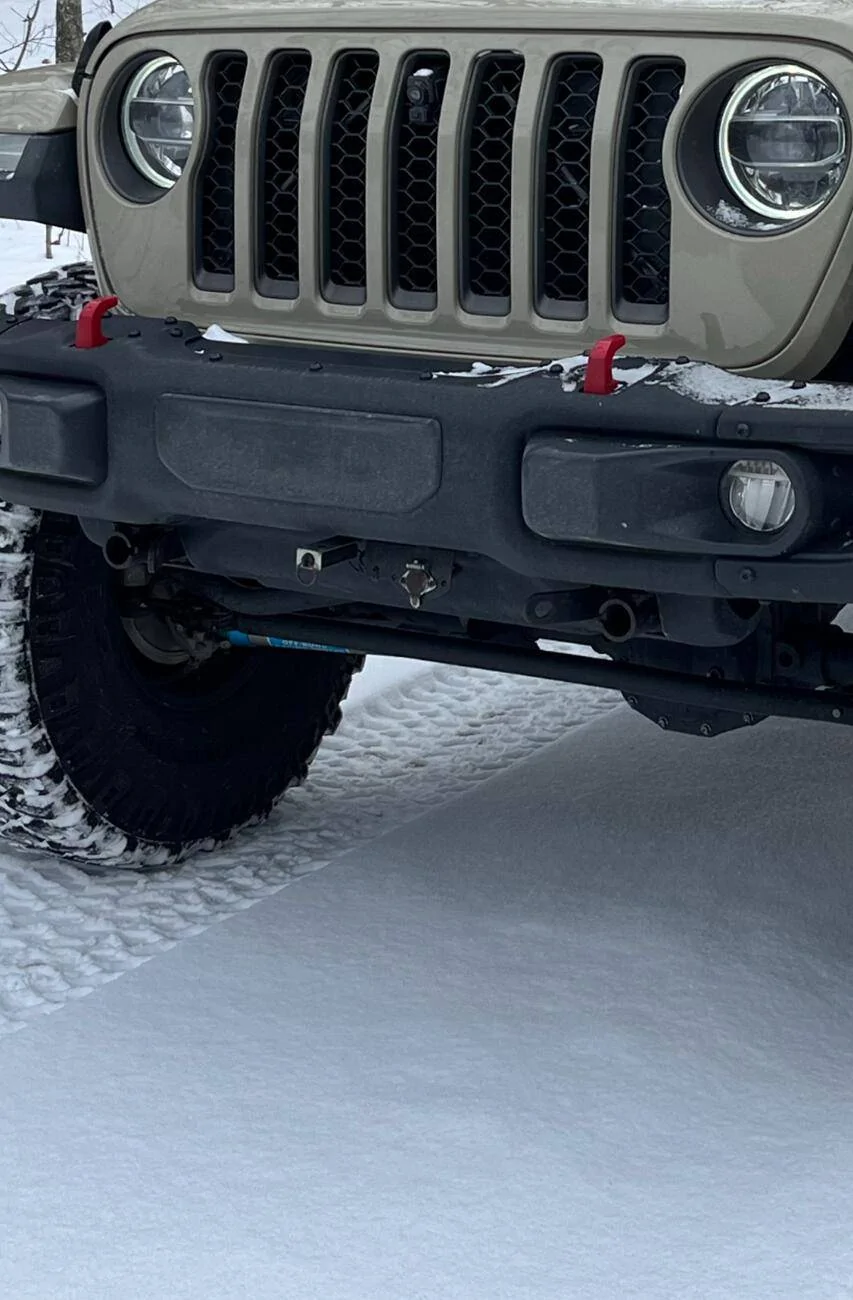

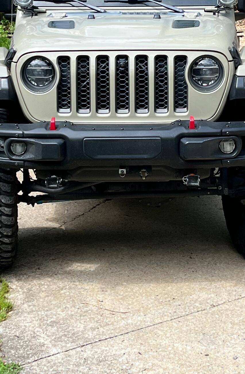

Not trying to steer you away from the D rings but I’m using roadmaster direct connects from e-trailer for my last 3 jeeps. Have been very satisfied with them and other than a little trimming of skid plate, pretty clean and not much overhang.
Pictures attached with and without connectors attached.

This what I am trying to avoid. The main connection structure is very exposed if you are offloading and it impacts your approach angle. If this piece gets damage, your stuck. If your not planning on doing offroad trails then this is fine, but that's part of why we want to tow the Jeep, to do back country exploring.

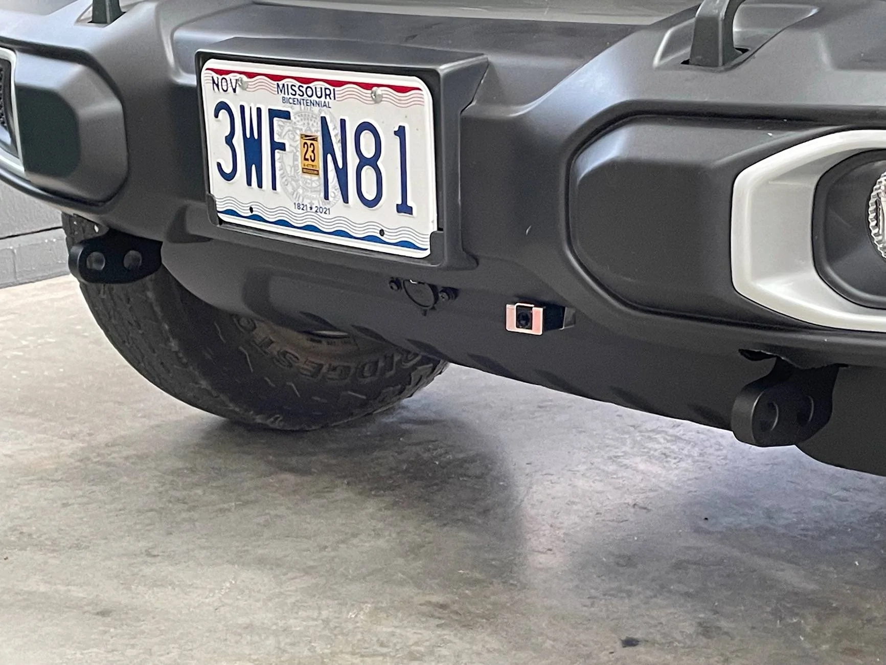

This was my solution, easy to install and almost invisible. 30,000 trouble free miles
https://www.maximus-3.com/product-page/jljt-flat-towing-kit-wo-adapters
I was an early adopter of those. They bent, and the company reaction was subpar to say the least. They spent months defending their design and saying it wasn't an issue (despite multiple other people on forums with the same complaints) and then quiety launched a tie bar to prevent the bending on their website with the note: "IF YOU ARE FLAT TOWING YOUR JEEP BEHIND A MOTORHOME/RV the Towing Tie Rod is MANDATORY FOR SAFETY."
No communication. No warranty. No standing behind the product they told everyone was safe and refused to listen (or at least admit wrong) when pushed back on this.
I refuse to do any business with them because of it, and suggest everyone avoid them.

I too was an early adopter. Used the tow hooks for 6 months when they contacted me and recommended the addition of the tie bar. I added that to mine as a precaution
I have had very good responses from them, as well as they listened to my concerns about the method of attaching the bar. They accommodated my request and I’ve had zero issues with the product or the staff.
They said I was the only one they'd heard of with the issue - despite many reports elsewhere.
They said that it was impossible to occur with normal use.
They said it was lack of maintenance (How, what do you maintain, here?).
They said it was a tow bar issue (Again, how?).
They said it was a brake controller issue (first, that I didn't use brakes when I always did).
Then they said it was abuse.
No thanks.
They spent months ignoring calls/emails, occasionally gaslighting me, and skirting around any admittance of issue at all. All I was asking for was a refund or replacement. I received neither. This was well before they quietly released the tie bar on their site.

you are correct in part. I did not order or install until 12/2021. I was early on the tie bar. Sorry if I miss spoke. However they did reach out as they were developing the bar, and I did obtain one after they addressed my concern about both ends being removable.
sorry yours failed. Mine has not and has been a great means of flat towing my gladiator.
I had no issues without the bar. It was installed correctly and torque was checked regularly
