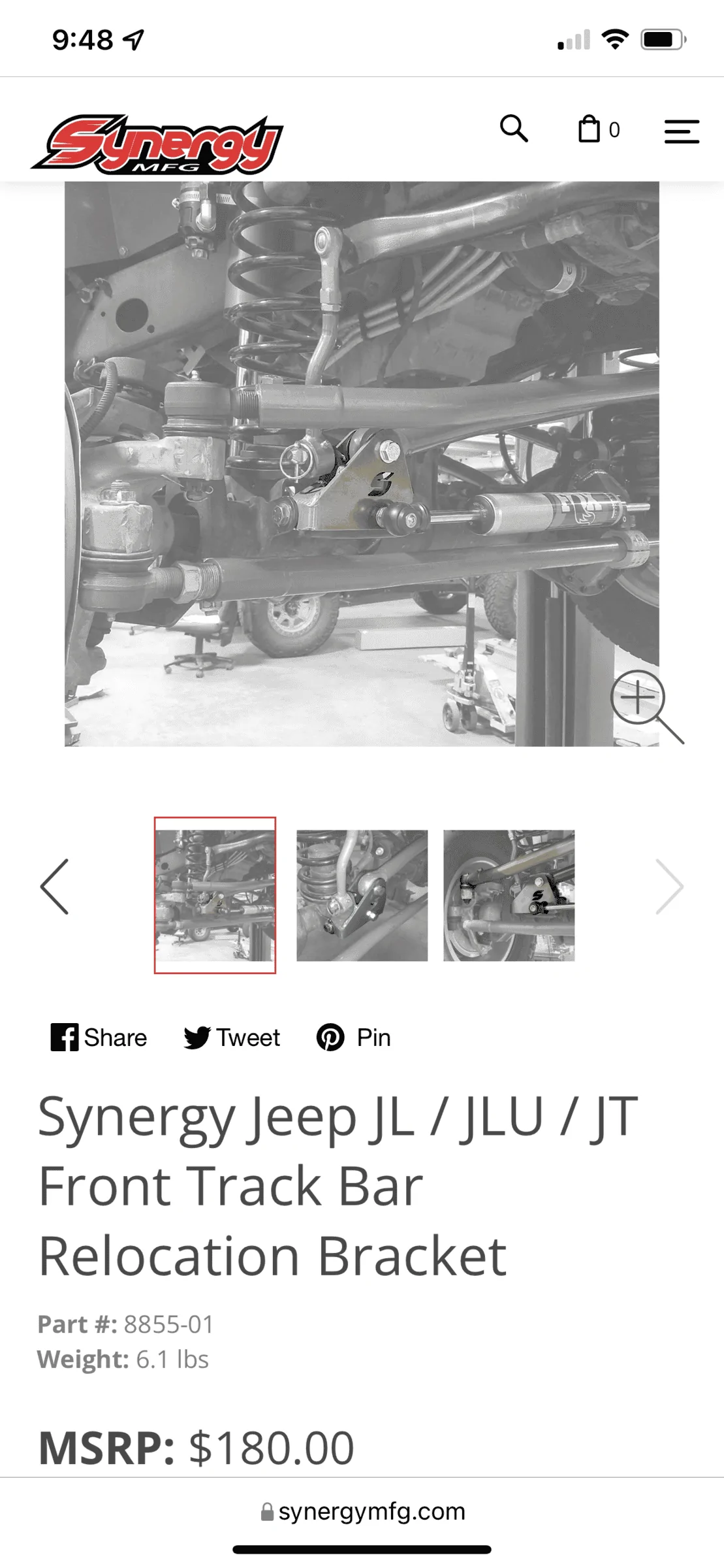

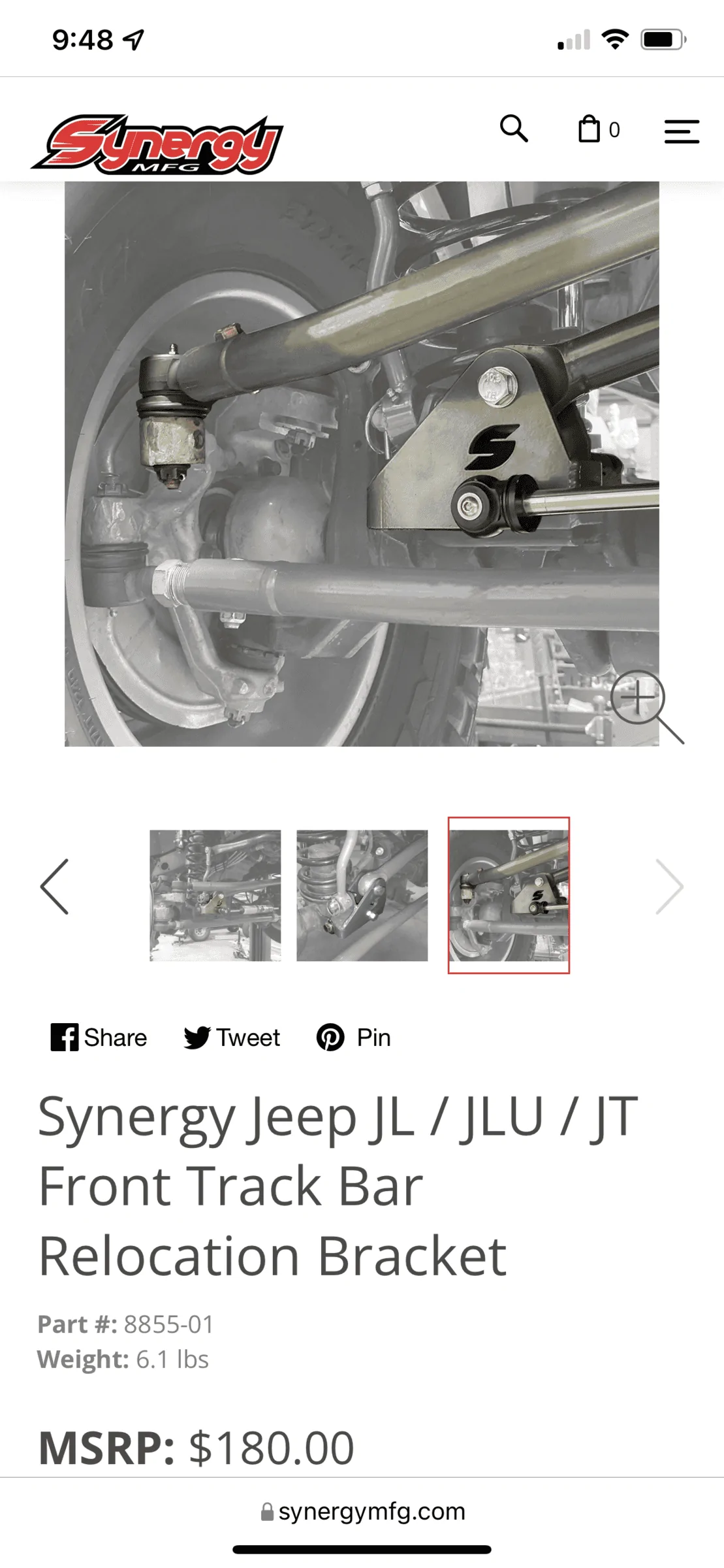

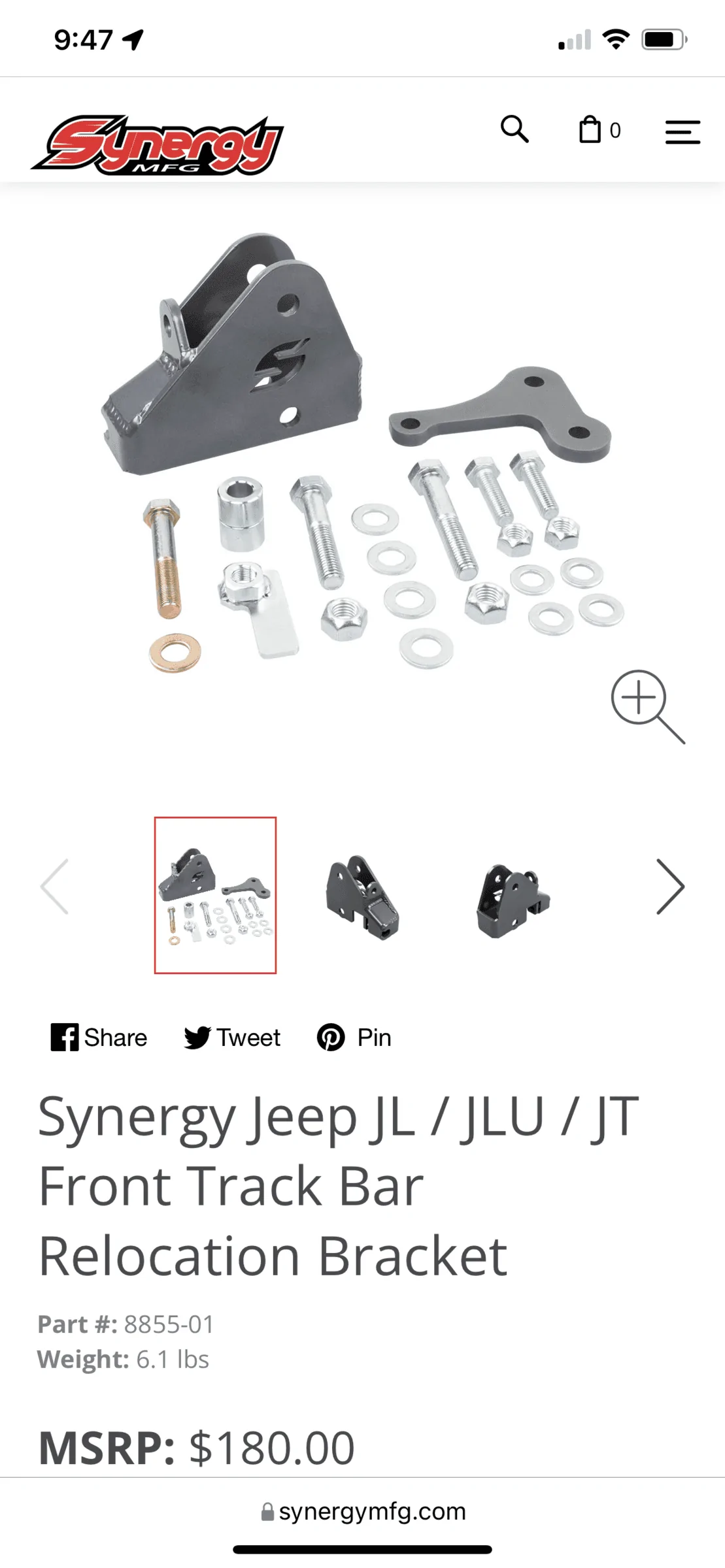

I ordered a JK Fox Steering Stabilizer for my Jeep. It’s the Fox 2.0 TS design. I installed the new bolt that goes through the Trackbar and when I went to turn the wheel to the right to set the tie rod clamp the body of the SS was hitting the tie rod link. Is there something I’m over looking? Sorry I didn’t get any pictures and ended up putting the stock stabilizer back on.
Bracket
Jeep Gladiator Fox Steering Stabilizer Clearance Issue 4EE46795-F37A-47CA-B973-62EE3AFFA6EF
Jeep Gladiator Fox Steering Stabilizer Clearance Issue 4D3A862E-329E-4843-9BD1-443473C0561C
Jeep Gladiator Fox Steering Stabilizer Clearance Issue 7E3572A8-8326-4526-AEAC-96E74E9684BD

Well this morning I ordered a Steering Stabilizer relocation bracket from Clayton, which should help with my clearance issues. It will be here Wed so I’ll keep everyone updated.
