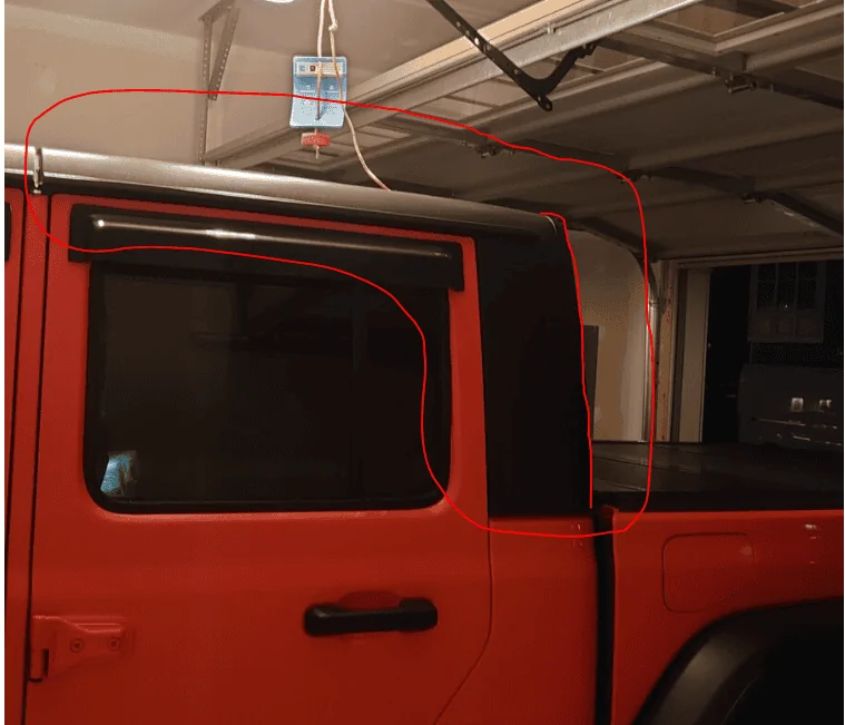

I have to back my Gladiator in to clear the door - I don't clear the opener. I use a J-barr to attach. Then I have a chain from the ceiling that holds the J-barr directly over the spot that it needs to be to attach. Then mount hoist to the ceiling about 6 feet back to the rear of garage or attach to the top of the wall at rear of garage.
Therefore, when you activate the hoist it doesn't pull the top straight up. It pulls the top at more of a 45 degree angle up and back. Therefore, if you raise the top 2 feet it will also pull it back toward the rear of garage 2 feet and clear the garage door mechanisms.
Works perfect for me. Backing in is key since the top doesn't go straight up it has to hoist itself only foot or 2 above the bed as it goes backwards.
