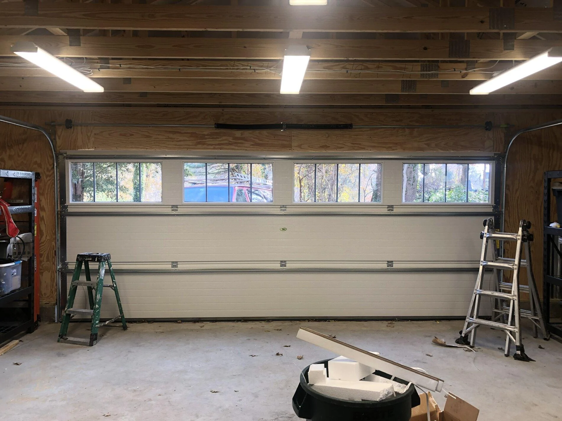

I don't know if it has been suggested but you can get high lift tracks and a jackshaft opener. that will get the door up closer to the ceiling and the door opener out of your way.

I agree with a new garage door opener. I just built my cave/garage 24x28 with one 18’ door and my opener is mounted on the wall next to the door and that helps open up room above where your motor is.
Jeep Gladiator Garage woes... DC431286-4CF2-4C52-9896-AB633EC57E1D

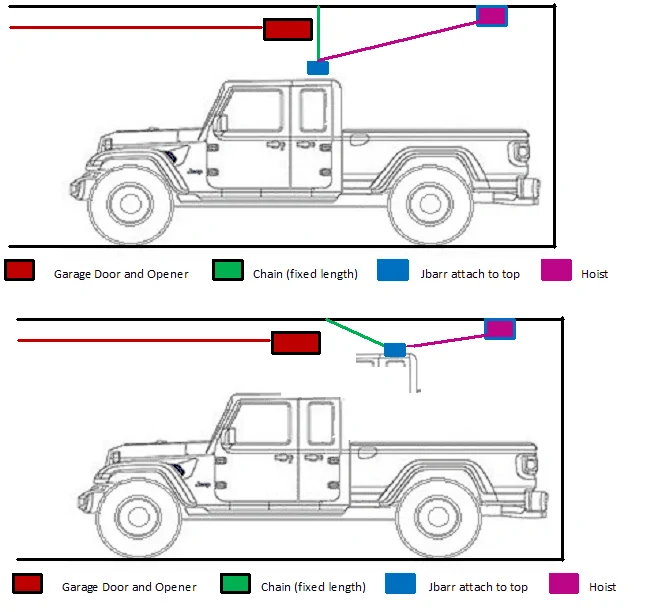

I have to back my Gladiator in to clear the door - I don't clear the opener. I use a J-barr to attach. Then I have a chain from the ceiling that holds the J-barr directly over the spot that it needs to be to attach. Then mount hoist to the ceiling about 6 feet back to the rear of garage or attach to the top of the wall at rear of garage.
Therefore, when you activate the hoist it doesn't pull the top straight up. It pulls the top at more of a 45 degree angle up and back. Therefore, if you raise the top 2 feet it will also pull it back toward the rear of garage 2 feet and clear the garage door mechanisms.
Works perfect for me. Backing in is key since the top doesn't go straight up it has to hoist itself only foot or 2 above the bed as it goes backwards.
I made up a crude photo example of what I'm doing (attached)

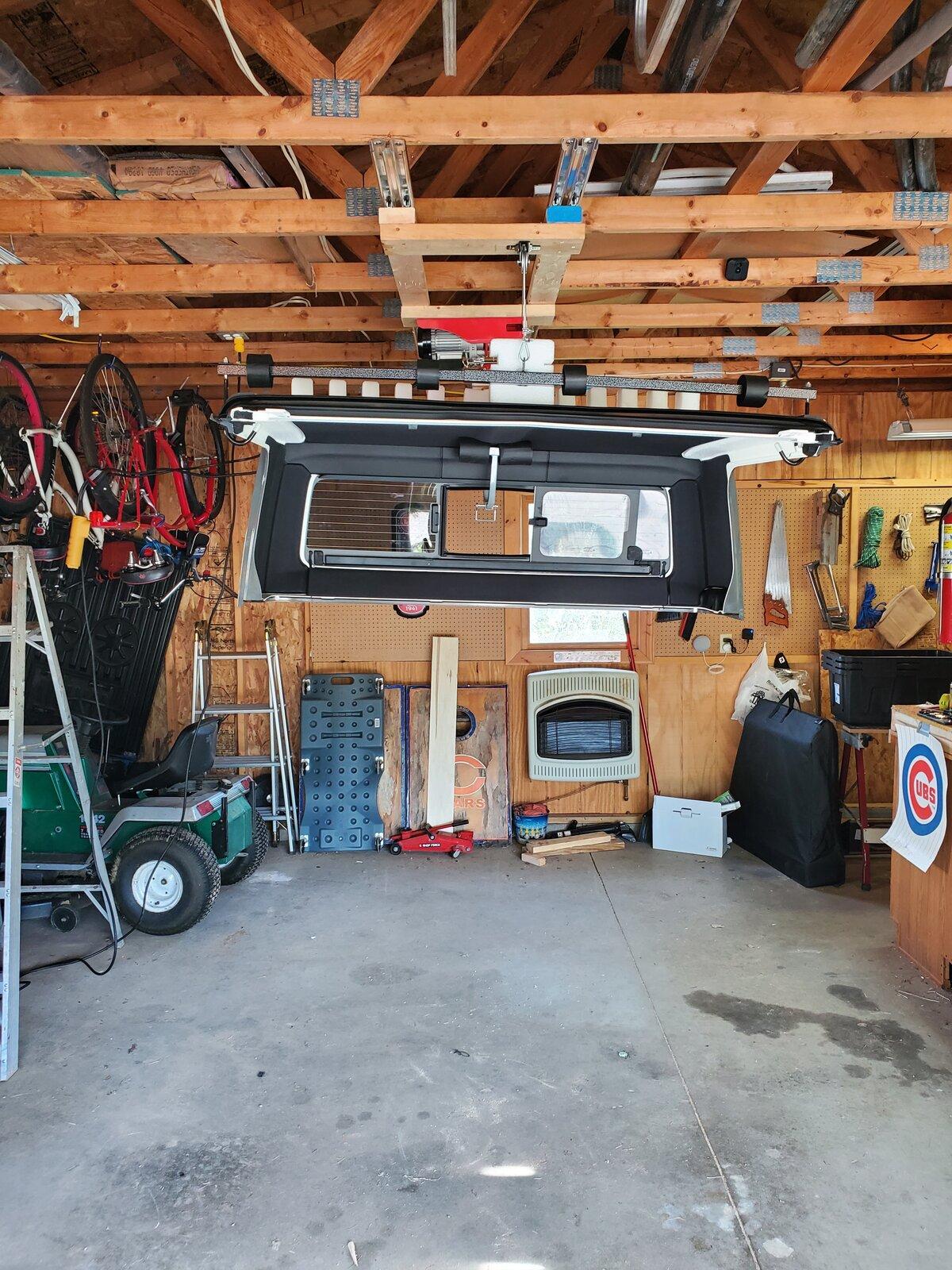

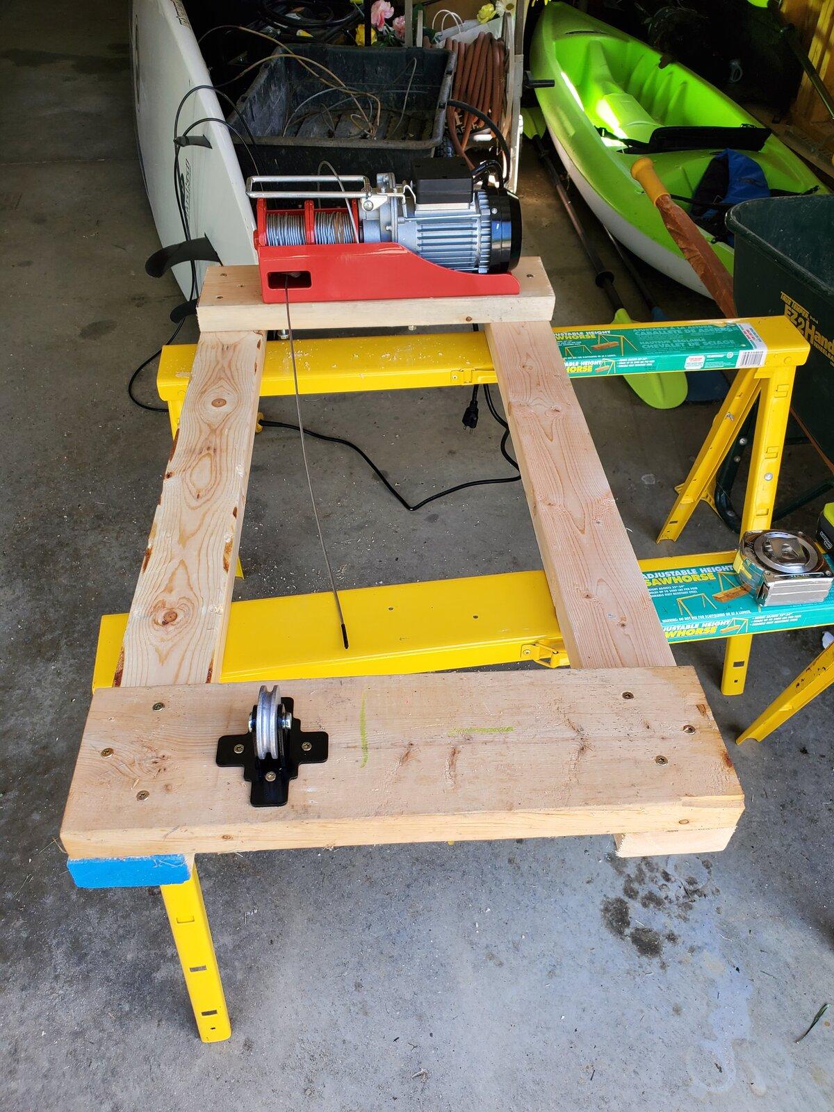

I put my lifter on a rail system like mentioned above:
I then back in and can lift it off, then slide it all the way against the back of the garage.
Jeep Gladiator Garage woes... 20200525_161145
Jeep Gladiator Garage woes... 20200525_183451
Jeep Gladiator Garage woes... 20200525_184708
Very cool. How'd you calculate if the rails and rollers would support the weight?
ChicagoJeeper
Craig
Feb 24, 2020
32
99
Chicago, IL
The top is like 60 lbs, plus the winch and lumber I figured 100lbs max, and each rail was rated at 100, so I've got 4x capacity easy. I probably could have done just 2 rails, but for like $30 each why risk it.

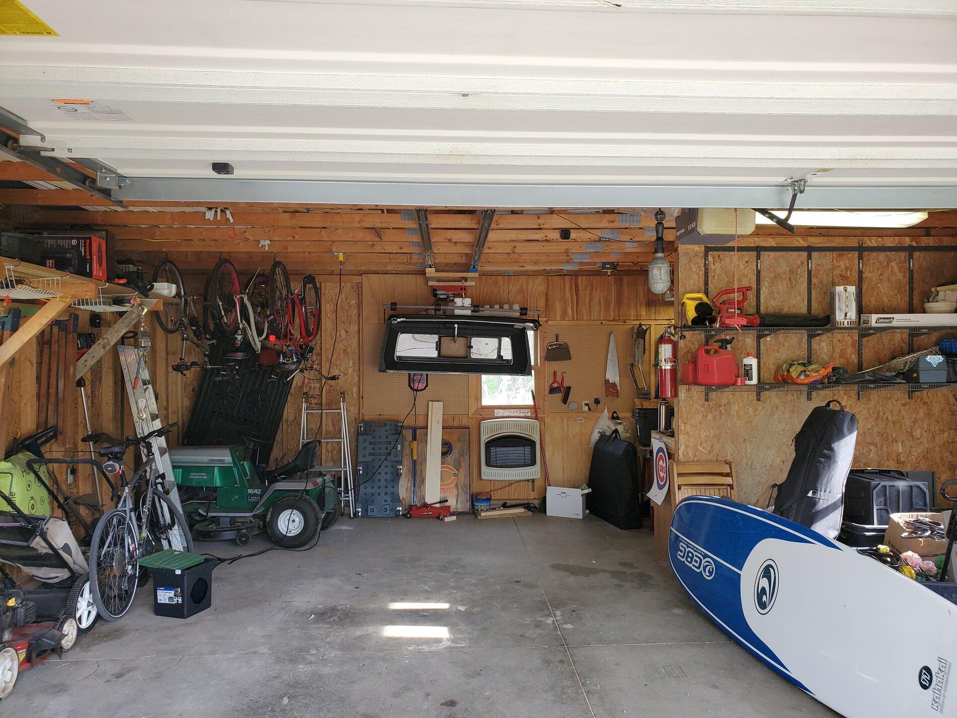

It should work if you back in. My front bumper is about an inch from my garage door when I'm parked and I can lower and raise my top with the it open.
Jeep Gladiator Garage woes... 20200816_100117

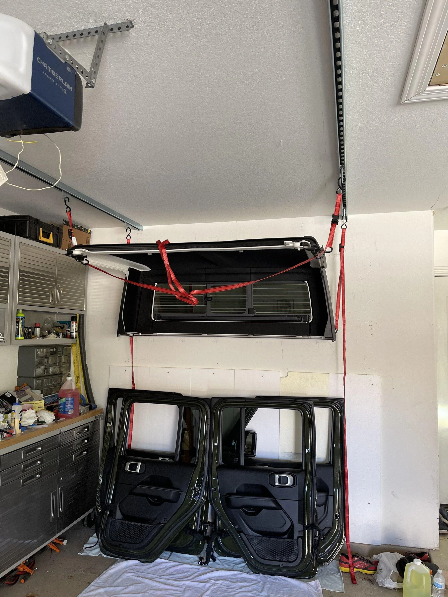

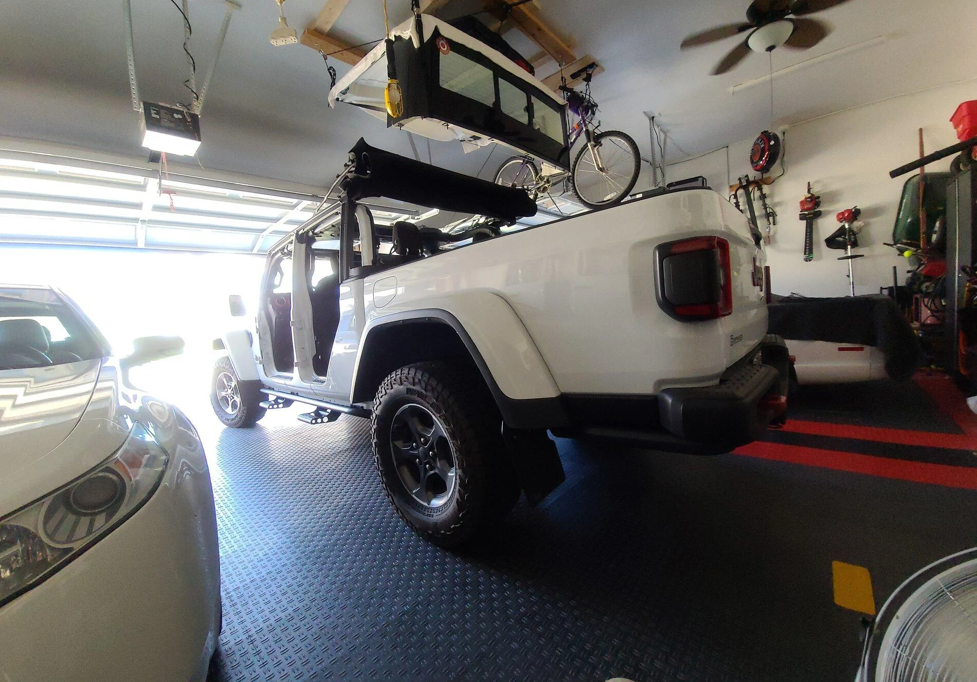

Like many other, I am limited by garage height. I mounted two pieces of unistrut on the ceiling. Using two trolleys on each side, I can lift the top off, then slide it back and raise it higher.
Jeep Gladiator Garage woes... 3837A0A8-EE3D-4AF9-888D-4F41593B4EB5
