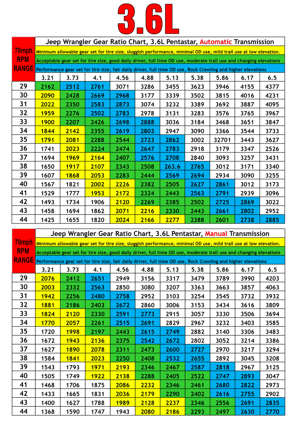

I am certainly no gear expert but here is THE information you want...
Hey these are not for the JL this is JK info and completely wrong for the JT and JL.
Can you remove it please. The final drive ratios are off by over 400rpms for most gear sets

So, looking at the above chart:
Stock 33" tires on a Rubicon with 4.10 gears = 2426 RPMs
And, running 37" tires at 2426 RPMs puts the gears in the 4.88 box
That chart is for the JK.
The JTR turns 1958 rpms in 8th at 70mph.
To match that on 37s you need 4.56 gears which will turn 1942 rpms at 70.
Or opt for a little deeper gears at 4.88 and turn 2078rpms at 70.
If you go 5.13 you will be turning the exact same rpms in 8th as you would be if you were using 4.10 gears and left it in 7th. I don't see the advantage of essentially removing the top gear.

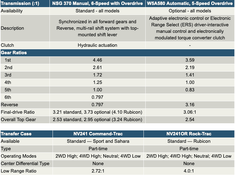

First Gear Ratio
4.71
Second Gear Ratio
3.14
Third Gear Ratio
2.11
Fourth Gear Ratio
1.67
Fifth Gear Ratio
1.28
Sixth Gear Ratio
1.00
Seventh Gear Ratio
0.84
Eighth Gear Ratio
0.67
Using these anyone can take the tire circumference and differential ratio and calculate RPM for a given highway speed.

@Oscar Indy is right; that chart is for the JK and is not applicable to the JT. There is a thread on the JL Forum where people were talking about recreating it for the JL/JT with the new transmission, but no one had done it so far.
I’d do it (it is a simple excel spreadsheet with conditional formatting), but I haven’t had time to dig into the gear calculators.

Well gee I posted the JT automatic transmission gear ratios for ya! What's the problem LOL
J/K
If we were talking 1:1 as in 6th gear, it would be pretty simple but 8th is what, .67:1? Then you would plug in the various differential ratios, tire circumferences, and so on. Where's the math whiz here.
What's the top transmission gear ratio in the JK compared to the JT? Guess I could go look that up........

Looks like this is it (FOR THE JK NOT THE JL/JT!!):
Jeep Gladiator Gears for 37" tires Screen Shot 2019-12-19 at 8.23.33 AM
