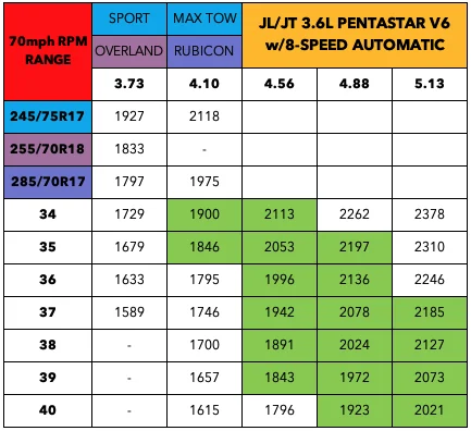

Ok y'all; first run at it. This is for those who want to try to maintain stock performance and fuel economy when going to a larger tire size.
I used the stock RPMs to determine 1800-2200 is the range to maximize MPGs since that is where the RPMs fall on the various models and I assume FCA felt 2000 RPM is the sweet spot for fuel economy. The green boxes fall between that range.
As per the discussion, this is just a rough starting point to see if you think regearing will help you to maintain STOCK performance on the highway at 70 MPH and regain/maintain all 8 gears on the automatic. IT DOES NOT APPLY TO THE MANUAL.
You'll notice that going to 37s with the 4.10s is not that far outside the range, hence why many feel it is unnecessary to regear - YMMV.
Edit: Note I included the stock Rubicon tire size with 3.73s for those who put take-offs on their Sport/Overland.

Excellent chart!
My conclusion is that I can keep the 4.10's with 37" tires as long as I do 80. Good outcome!

Excellent chart!
I linked a video earlier in the thread about trying to do 80 on 37s. The 4.10s don't have enough torque to hold 8th and 80mph. it'll do it perfectly flat and downhill. any headwind or SLIGHT incline and it'll gear down to the 7th or 6th depending on severity. I tried locking it into 8th and seeing what it would do. 71 is all it'll hold at my altitude.

Good intel, thanks.

Good chart indeed...
This also shows how horrible 37's and 4.10 gears would be.. Even more so, with a lower speed limit ( 100 kph (62mph here )
It is not holding 8th at 1746 rpm.....

See thats the problem with charts.
4.10 and 37s will turn 1877 in 7th at 60mph which is in the powerband that trans will try to keep the RPMs in anyway. The 8 speed is an awesome trans and the programming will keep it in the ideal band for the speed and rpm given if it can support it. at 60 4.10 were not a problem on 37s.
