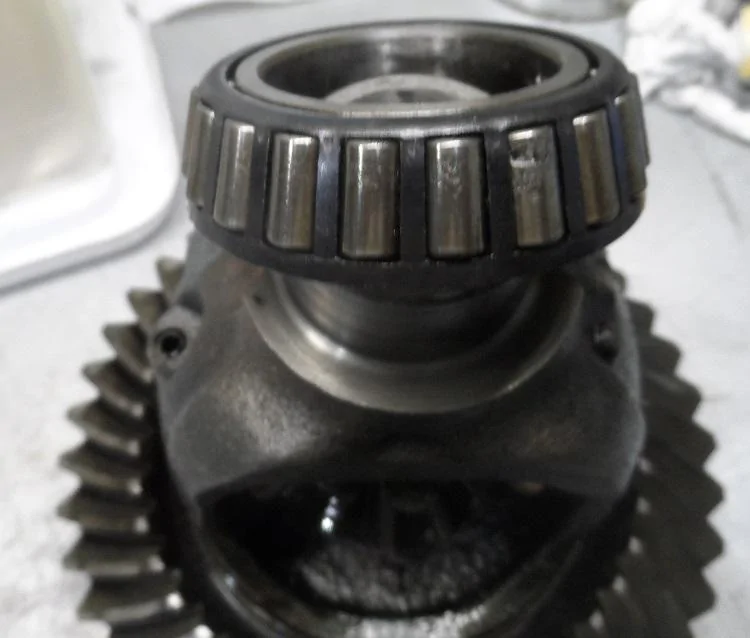

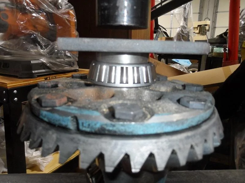

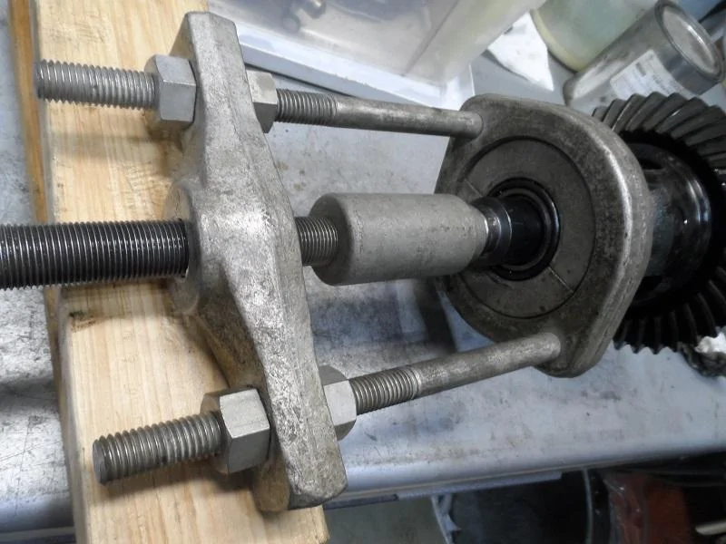

In these pics are the carrier and the ring gear still bolted to it - I'm rebuilding with new bearings.
I have pics somewhere of the limited slip differentials I have rebuilt but won't bother unless someone wants to see the disk type limited slip.
