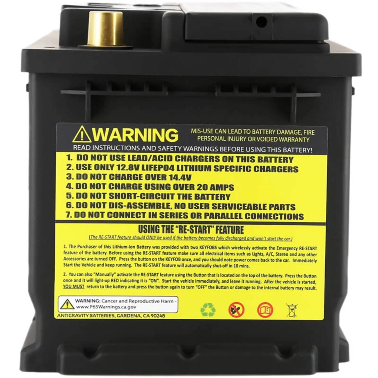

Careful... read the side of that battery.
Jeep Gladiator Gladiator EcoDiesel Rubicon - Quality & Efficiency Build Screen Shot 2025-02-11 at 8.55.34 PM

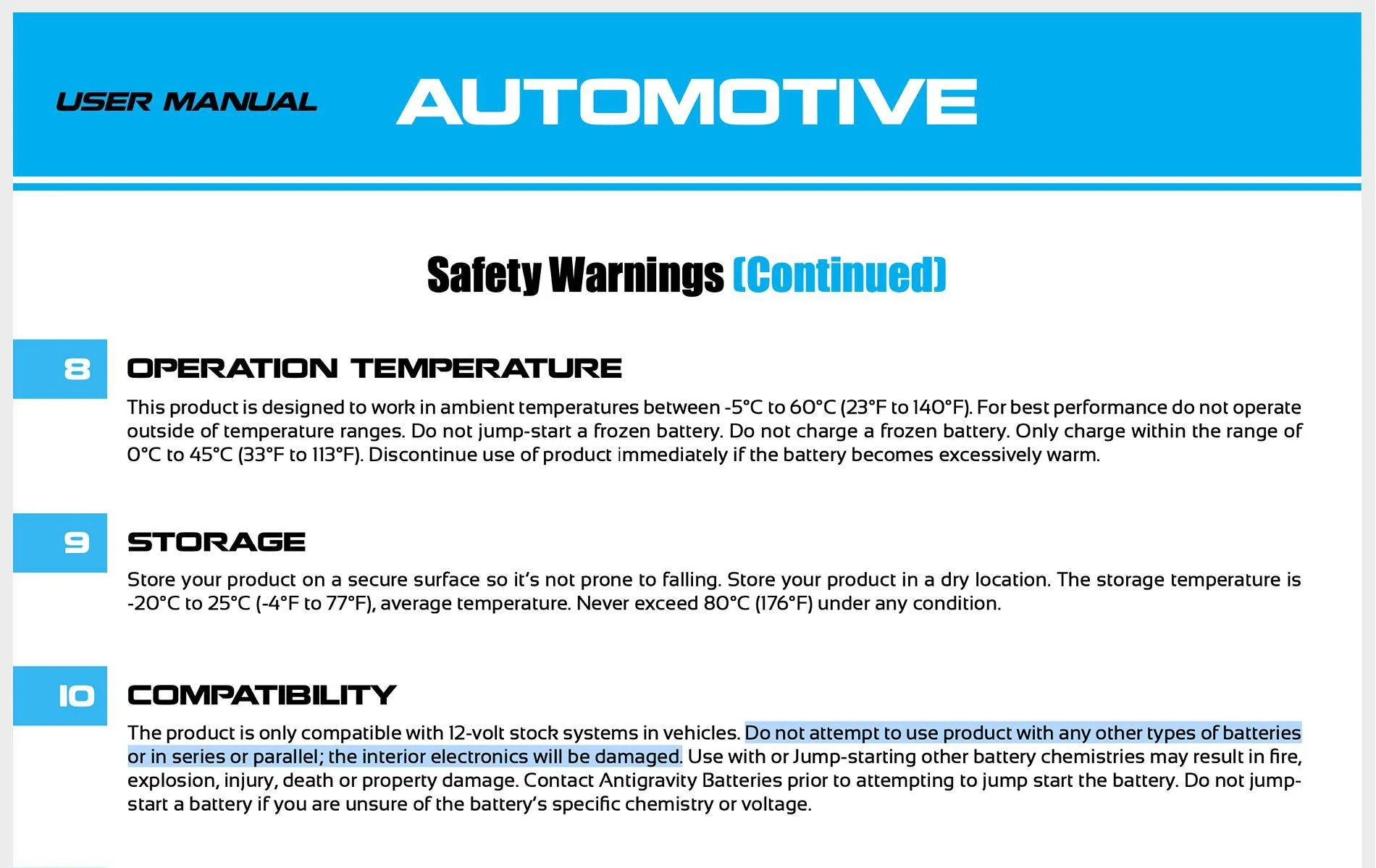

Also read the user manual.
Jeep Gladiator Gladiator EcoDiesel Rubicon - Quality & Efficiency Build Screen Shot 2025-02-11 at 9.29.04 PM
This is a factory engineered smart duel battery 12v system. I did see that but that not worried because this is regulated duel system from the factory already. No issues to report. I have thier monitoring app to see the volts and temps and other issues on the AUX.
This issues is if you do a parallel or series with a battery deigned for starting, for energy storage, that would be a bad idea. I only charge with their recommend Opti brand they sell as well.

but with standard alternator you will charge way over 20amps.
usually these batteries are used and 2nd batteries with a charge controller, like Redarc or such, which limits charging voltage.
Well these battery are not normally Lithium battery's for energy storage. These are the only one for automotive application with the BMS for it. As I mentioned, they supply to government as well.
You are speaking of energy storage batteries. These are a little bit smarter that energy storage batteries.
I'm been running an AntiGravity battery for about a month now and it's been doing what it was designed to do.

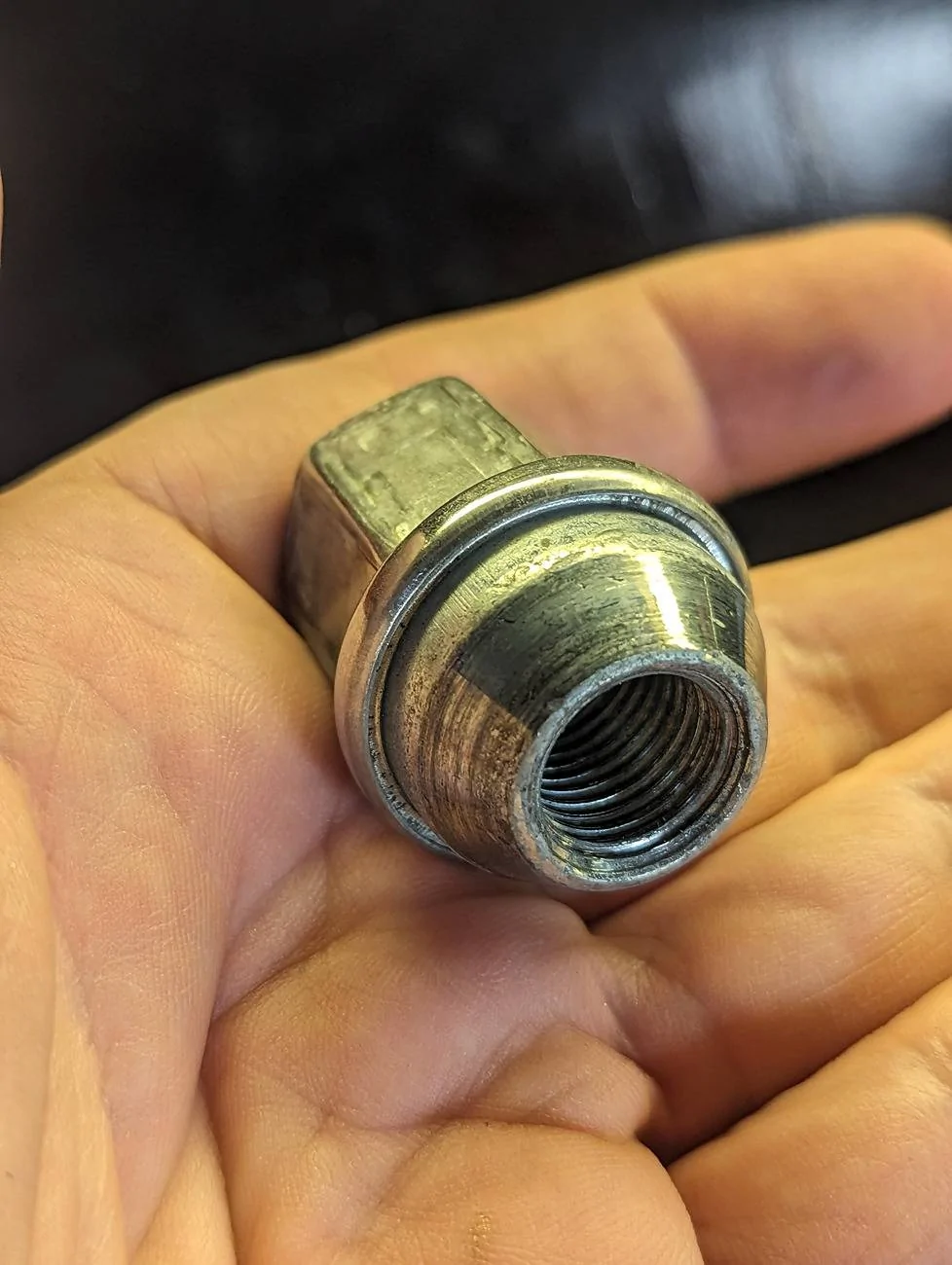

The biggest reason to replace the lugs is because the OE ones will rust inside the cheap sheet metal cap, swell up, and then become very difficult to remove because you can't fit a tool over them.

I'll validate the point on the lug nuts, the last oil change I had on my '14 Cherokee, had an awkward exchange with the mechanic, telling me they "couldn't rotate the tires because I had swollen nuts".......I had to take a moment to compose myself. Eh, about 1800 miles later it was someone else's problem. I don't think the lugs on my '22 JT are those sleeved or capped, pretty sure they are solid metal, they've had impacts and breaker bars on them plenty times, don't look much worse for the wear.
My 2021 came with the crappy lug nuts, Id consider pulling one and looking at it. You can see the sheet metal fold around the nut, just above the taper.
