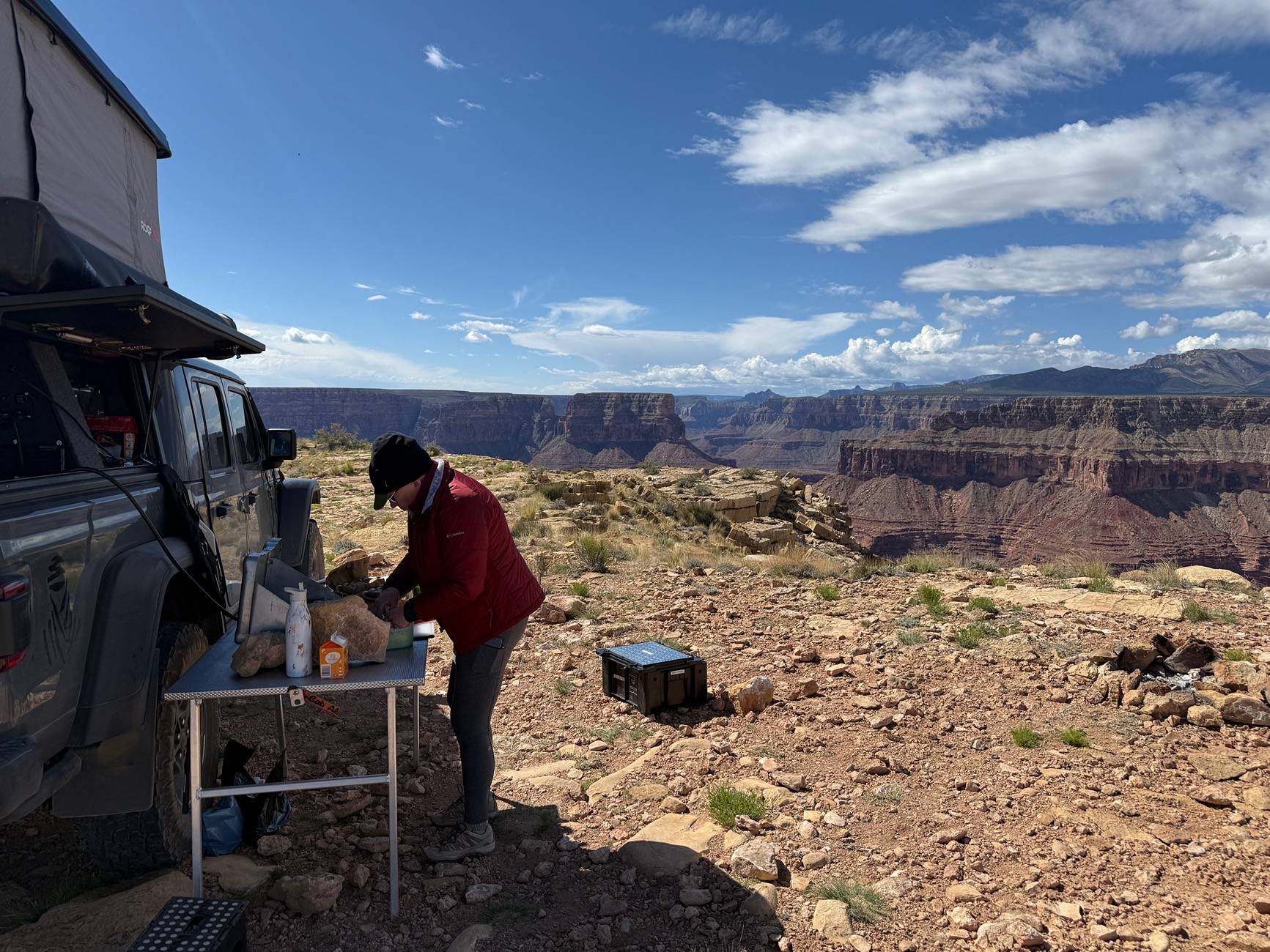

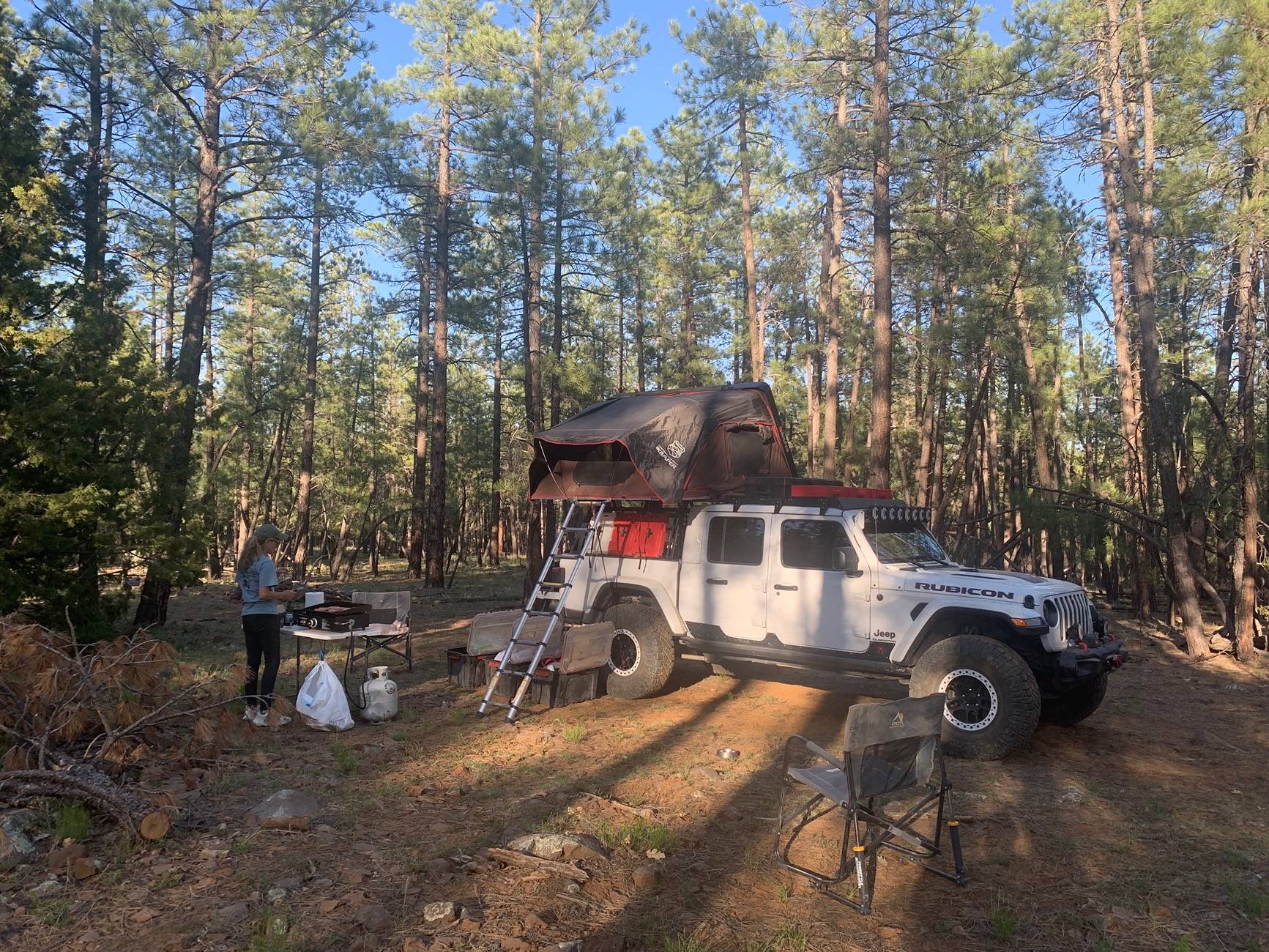

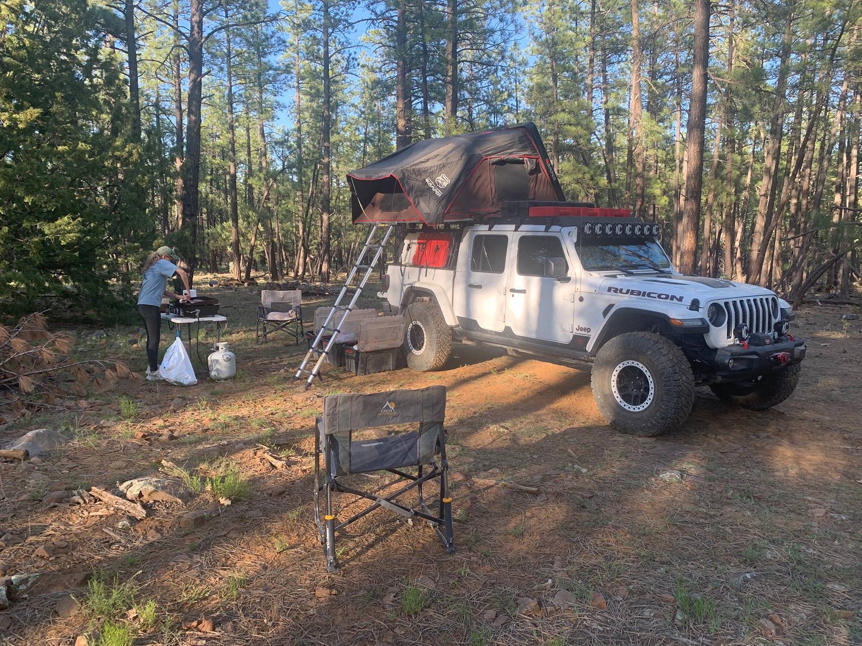

Tonight’s camp site.
Jeep Gladiator Gladiator Expedition Rigs IMG_2139
Jeep Gladiator Gladiator Expedition Rigs IMG_2141
Jeep Gladiator Gladiator Expedition Rigs IMG_2144

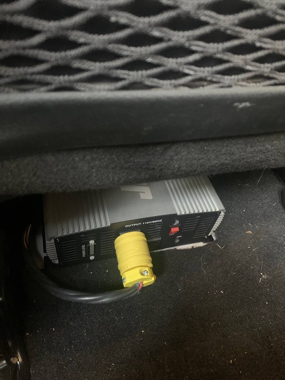

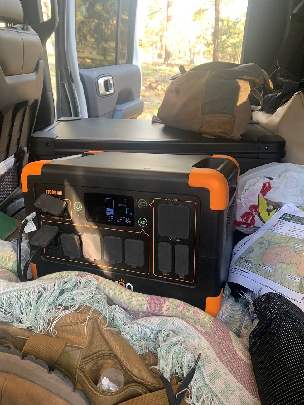

I have an issue with Pecron 1000. It won’t charge from the factory Jeep inverter or my 2000 watt inverter. I used the 12v cig port to charge it and it keeps fridge running all night no problem and we run fridge off Jeep inverter and charge Pecron during day while we ride so it isn’t too bad. Just wondering if I’m doing something wrong.
Jeep Gladiator Gladiator Expedition Rigs IMG_2149
Jeep Gladiator Gladiator Expedition Rigs IMG_2148

@Mules
I have the same issue with my Bluetti AC180 not charging off the Gladiators AC outlet. These power stations don't like the sinewave that the Gladiators inverter produces.
I wired a 12v outlet in the bed to charge my Bluetti when I'm driving. I also plug my refrigerator cooler into the bed AC outlet when driving and switch it over to the Bluetti when I'm going to be parked for a long time or overnight.

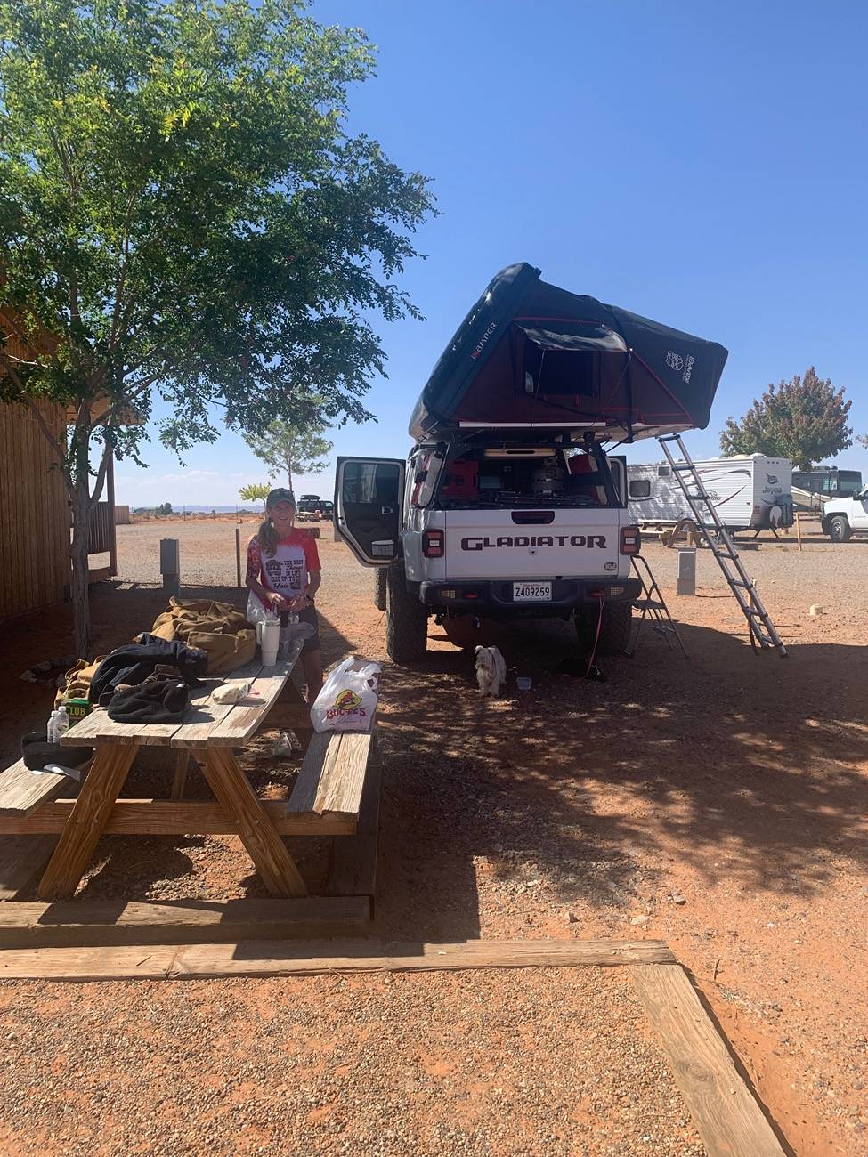

Went with a KOA tonight for convenience and to do some laundry but I covered the view.
Jeep Gladiator Gladiator Expedition Rigs IMG_2157
Jeep Gladiator Gladiator Expedition Rigs IMG_2159

@Mules
I would try 2 things to see if you can get the Pecron 1000 to charge from your truck's inverter or your installed inverter.
1) Go into your phone's smart app for the Pecron and see if you can decrease the 120v input charging to 400 watt. I think I saw a video about this, but I cant find it now. Then plug the charge cord directly into the truck's 400 watt inverter.

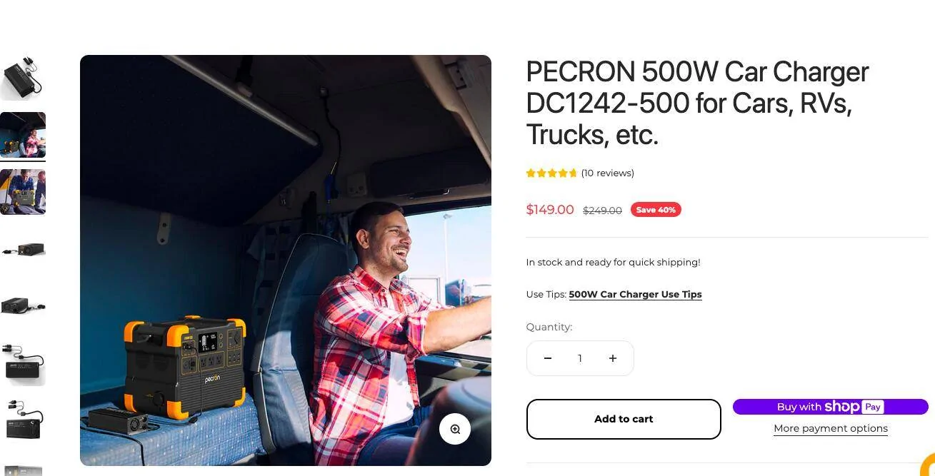

2) If you recieved a 500 watt external charger with the Pecron 1000, like the picture below, plug this into your installed inverter, to see if this works.
Jeep Gladiator Gladiator Expedition Rigs Screen Shot 2025-05-22 at 9.31.51 AM
Let us know if you get it working.
fourfa
Dec 12, 2021
1,134
1,445
CA
22 JTRD + ACCC
Inverter outputs might just be too square-wave for devices to recognize as AC. I have an electric fridge whose AC power supply happily runs on the Jeep’s stock inverter - but my EcoFlow battery box (River 2 Pro I think?) freaks out and shuts down with an error code if I plug it into the Jeep.
Here's the best way to charge a Pecron 1000 or larger. It may be included in the purchase of the Pecron, but I'm not sure. There are videos on Youtube of this powering other power supplies like Buetti.
https://www.pecron.com/products/pecron-500w-car-charger-dc1242-500-for-car-rv-van
