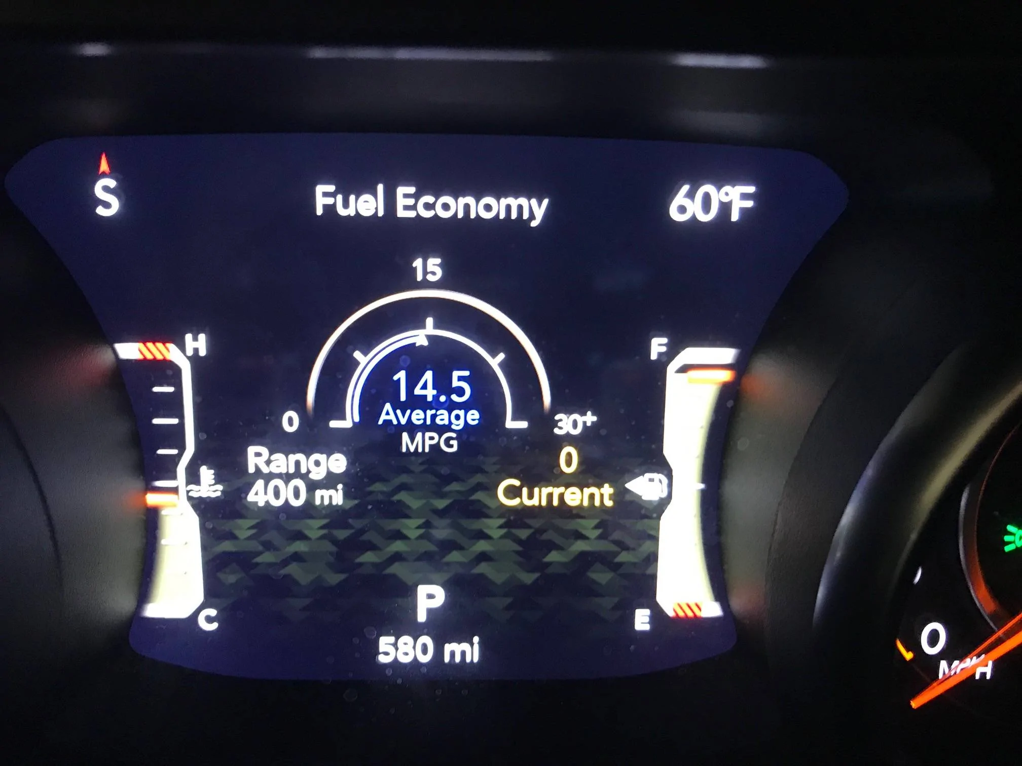

My issue is a tad bit different. I try to keep my gas tank full. I drove about 30 miles today and noticed that after I filled the Jeep, it did not register completely full. Maybe a little less than full. The last time I filled it up, the gauge showed full and the needle went all the way up. I just now after running another 30+ miles gassed it up as it was showing down about an 1/8 of a tank. Filled it completely again. Made double sure it was completely full. It still shows down just a bit from full. Have about 580 miles on it and this just started. Anyone that has had this happen, find a fix? It is minor, however I would like the gauge to be as accurate as it was before. Pic of a full tank below. The pic is not that good, but you can see the needle sure is not at the full mark anymore.

Additionally, I have a AutoStop Eliminator in the vehicle. I wonder???
Thanks!
TSB 14-006-23
