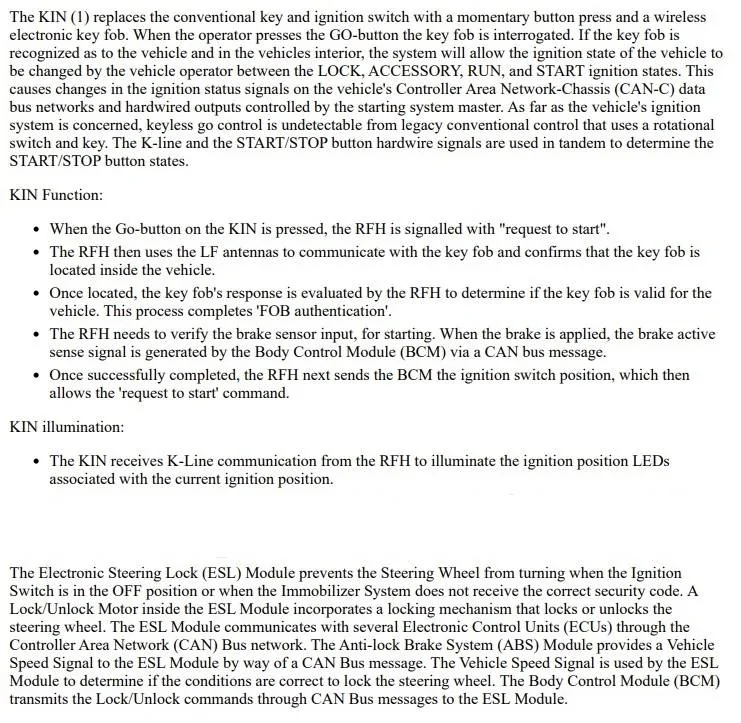

Not saying for certain that the BCM is the problem, but it is plausible. Before calling the BCM bad I would check that it is getting its proper power inputs and ground connections, and do what checks are possible on the CAN bus given the current state of operation of the vehicle.
Notes:
- The RF hub sounds like it's working based on the fact the vehicle locks respond to key fob lock/unlock commands.
- The KIN (keyless ignition node, aka, the ignition switch) may be suspect as it's unclear whether or not you're getting any response whatsoever when depressing the button, though it is clear that you're at least not getting any change in the status LEDs (Off/ACC/Run).
- The BCM is the component that controls the ESL and also coordinates with the PCM to actually put the vehicle into the Off/ACC/Run modes as well as operate the starting system based on inputs from the KIN and RF hub.
