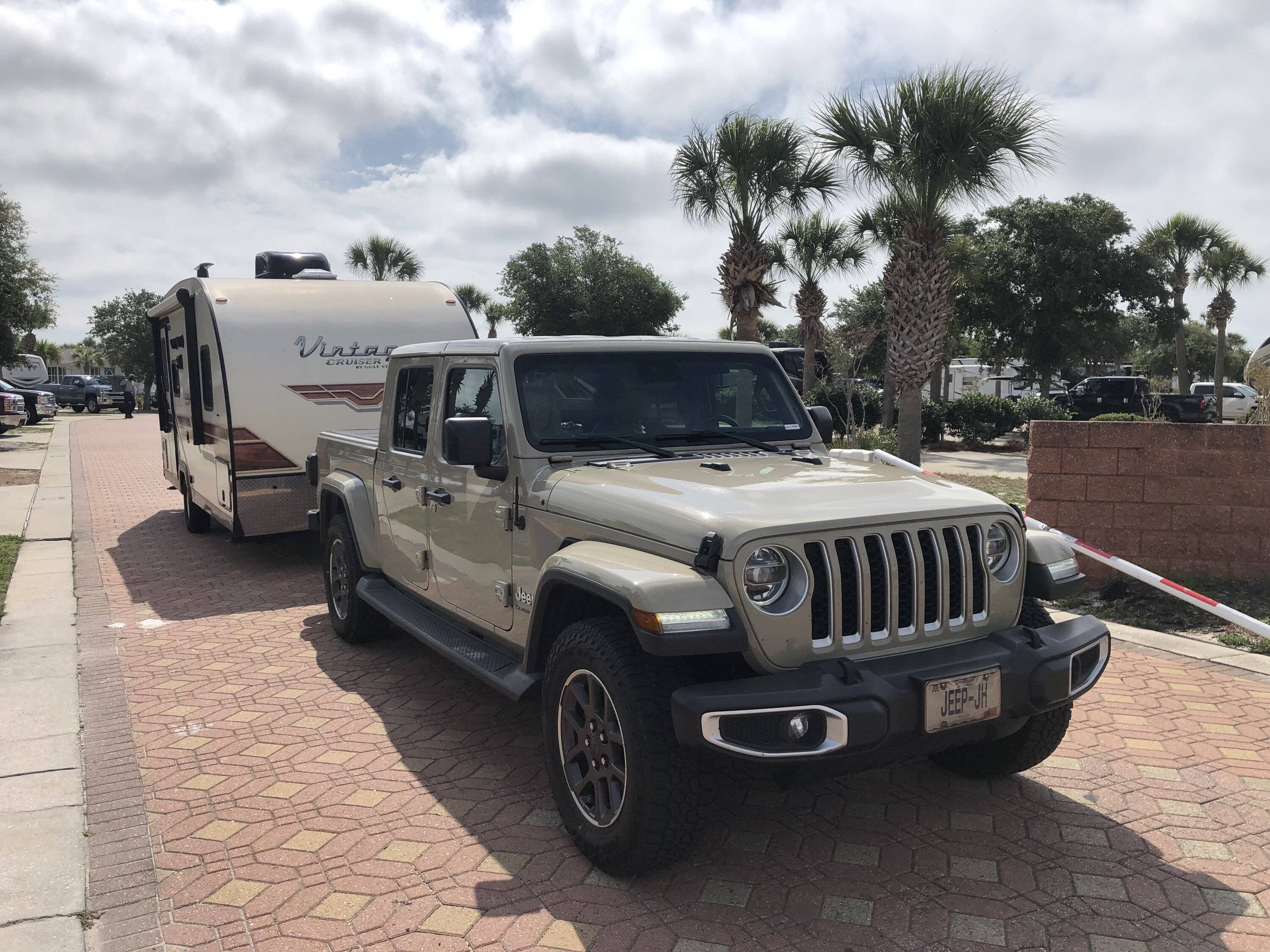

2020 Overland with tow package, no mods. 7,500 of our 44,000 miles have been towing our 19’ 3,500 pounds (dry) Gulfstream. No problems. Handles fine with an Equalizer tow/weight distribution hitch. Making our 4th 1,700 mile round trip to Florida this May. Cruise at 60 to 65 mph.

Hi all,
I have come to the conclusion that my Gladiator is crap for towing.
6 months ago, we travelled to California from Florida. 2600 miles. averaged about 350 miles a day towing 3500lb travel trailer (ultra light weight).
55MPH average. The ride was good .
When we got there trailer unhooked, that's when I found that the suspension was not right. It was like being in a boat.
So moving on.......... we were there 6 months. Sold the trailer.
December 2023 we moved back to Florida towing 'on a dolly' my wife's Hyandai Veloster. Not a heavy car by any means.
About 600 miles from home after travelling 2000 miles, I could feel the transmission struggling.
We made it home and I took the Jeep to dealer. They inspected and found transmission to be failing.
Thankfully it is under warranty so it is being replaced. My jeep has only done about 55k miles.
So after 55K miles the 1st and only times we have towed the transmission is done as well as the suspension.
I thought I would just post this to see if anyone has any input or has experienced similar issues.
(When i get it back from dealer I will be putting upgraded suspension on, but I don't want to lift it).

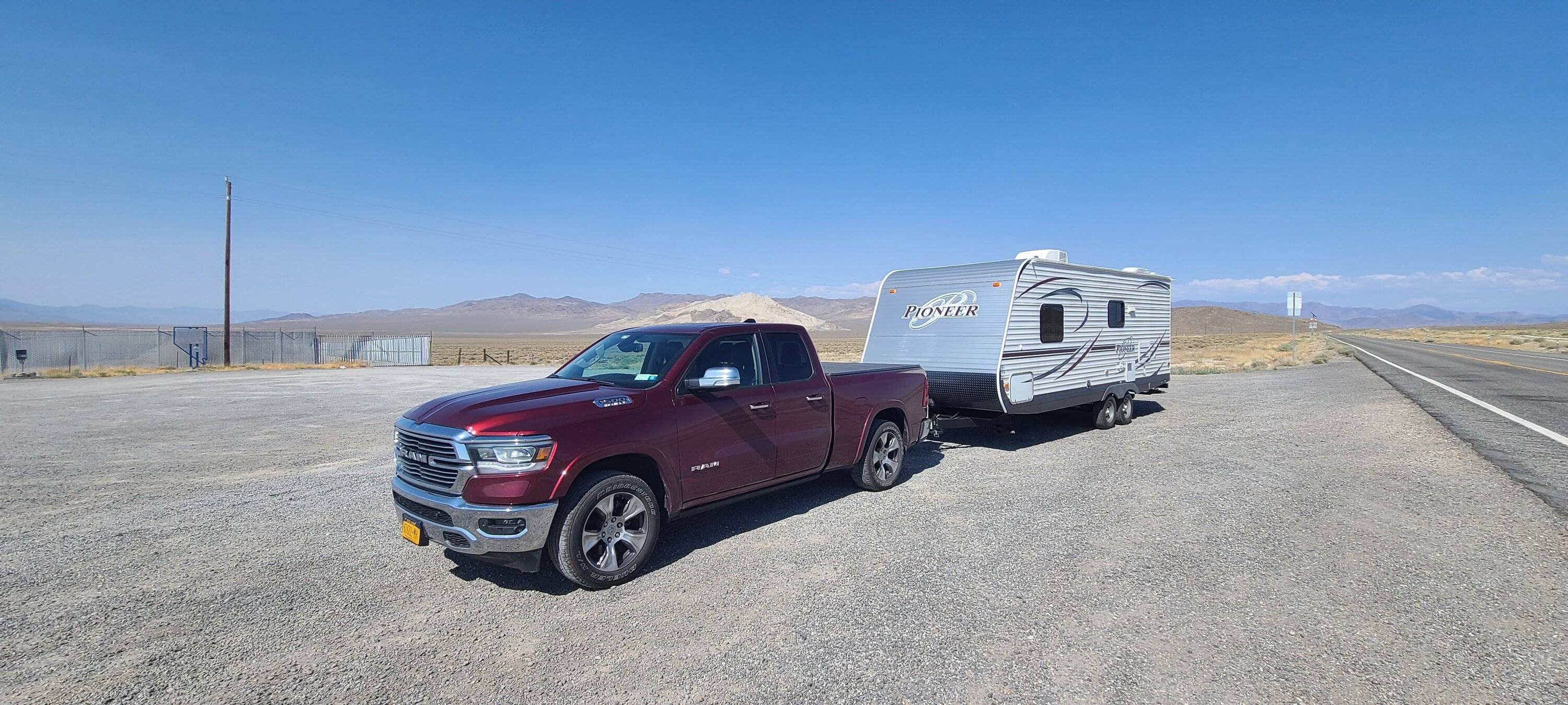

It's not so much the weight as it is the giant sail some of these campers create.
I towed a 26' 4500lb trailer across the US in 2020 with a 1500 Ram with the 5.7 Hemi and it was a long month and a total of 8200 miles. It towed it and made it but above 60 that Hemi wanted to be at 4000 rpms and just roaring. Going up mountain passes it was 45 to 50 the whole way. Up to about 40mph, it was effortless. But then once that wind drag hit the front of that it exponentially increased the drag and had to work harder. I can't see my Gladiator towing that camper at all.
I towed a car on a trailer with a total weight of 6800 lbs with the same truck and never even knew it was back there. No wind sail like the camper.
The biggest issue was gas. With the 26-gallon tank on the Ram and 10-11 MPG, I had to start looking for a gas station every 150 miles. On a 600-mile day, I had 3 to 4 fuel stops. Sometimes I would go 100 miles and not see a gas station and then one would pop up. I would pull in and top off just to be safe.
I think any amount of regular towing with my Gladiator with my current camper would be absolutely miserable.
Now a small lightweight teardrop camper that sits lower and doesn't create as much wind drag would probably be fine.
Pic is on HGWY 50 IN Nevada heading west not too long after crossing the Utah/Nevada border.
Jeep Gladiator Gladiator is crap for towing camper-nevada
