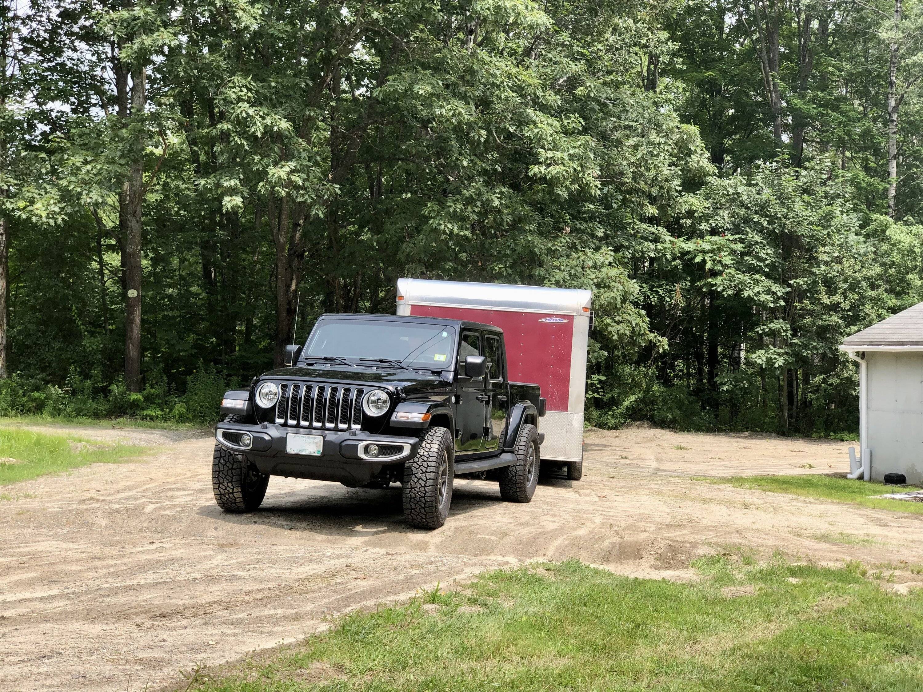

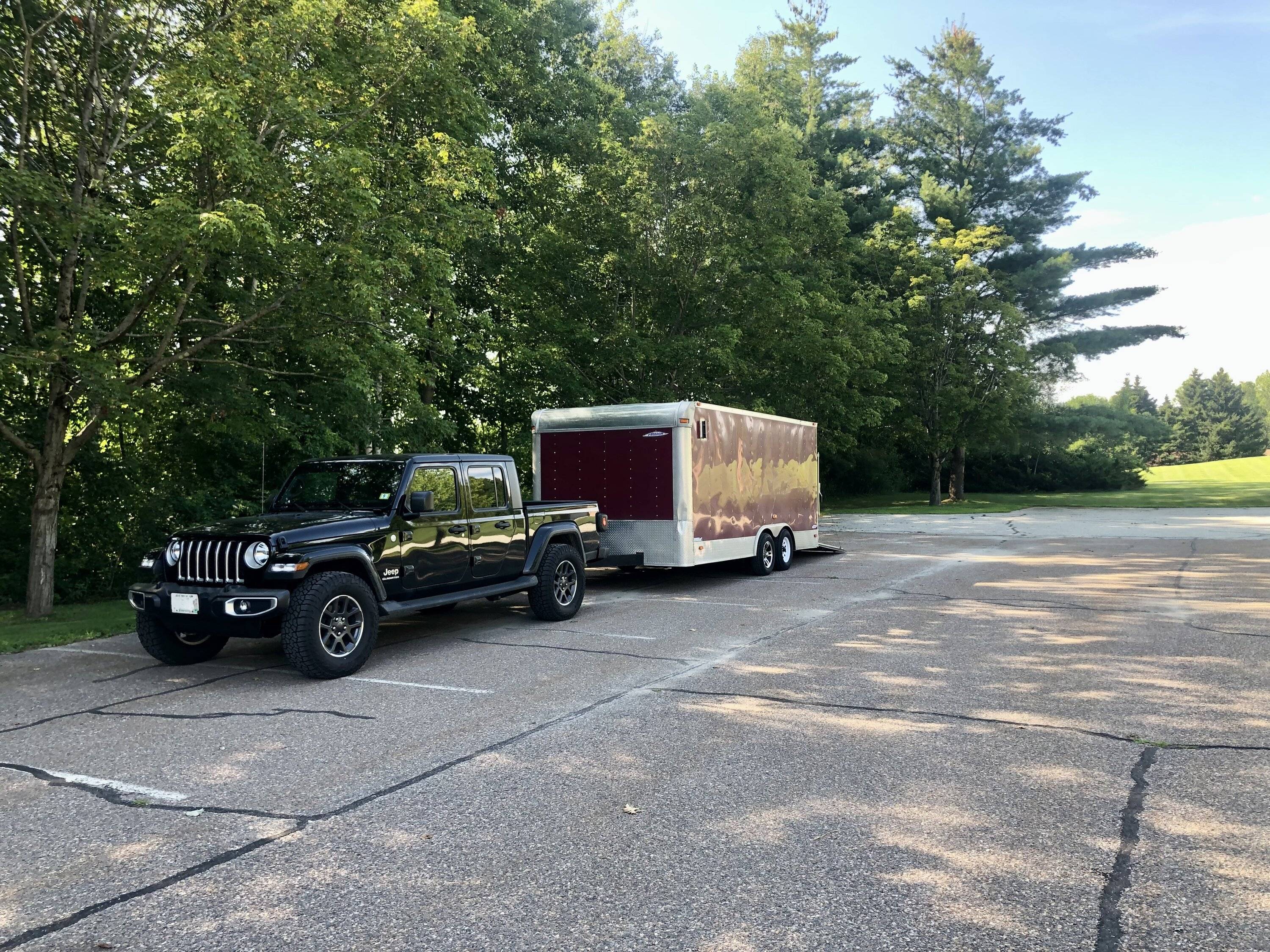

I think a lot of the opinion on here as to whether or not the Gladiator is a "good tow vehicle" comes down to what has the person compared it against? Below are a couple of shots of my Gladiator - a 2022 Overland automatic with the stock 3.73 axle ratio. Suspension is stock, I'm running 34.5" Wildpeaks and a 1.75" spacer on each wheel. The trailer seen here is a Freedom 20' long box trailer, 102" wide and 8.5' tall with a blunt nose. My Jeep has the factory "tow package" which means nothing more than the higher-wattage electric cooling fan and a Class IV 2" towing hitch on the back. My trailer - fully loaded - grosses at 8,000lbs or just under. I'm carrying mowing and landscaping equipment, including a 1300lb and 1500lb zero turn mowers, 5 trimmers, 3 blowers, a self-propelled blower, a variety of hand tools, a push mower, about 10 gallons of fuel, a toolbox, a small generator, hedge trimmers, a couple chain saws, power brooms, etc, etc. The trailer normally is pulled by my F-350 dually diesel. However, when that broke down and it took me a couple weeks to replace the turbo and other misc parts, I used the Jeep as my other dump truck was in use by one of my employees as was my other one-ton pickup. My Jeep is rated to tow 6,000lbs. I removed quite a bit of equipment when towing with the Jeep - one of the mowers, the self-propelled blower, a number of the small equipment pieces, etc. I weighed the trailer and it came to about 5200lbs. Given the width and height of the trailer, I knew this would still be a lot for the Jeep to tow. Since the Mopar factory trailer brake was on backorder, I bought the RedArc brake which is very similar to the factory setup. My tow route includes one 90 mile round trip tow, and one 100 mile round trip tow, and a number of shorter distance tows. I used the Jeep for two weeks, and it got the job done. I think the transmission is excellent in the Gladiator, and trans temps remained in a comfortable zone. The little Pentastar had to work very hard on the hills, revved up quite high and coolant and oil temps got very hot during these summer pulls. The Jeep was not super stable going 55mph with crosswinds. However, I was not using a WD hitch or stabilizer bars, so I expected it. The suspension is obviously soft and floaty feeling compared to the 350 dually. But power was never an issue, and neither was braking with the trailer brake installed. Frankly, I'm not that impressed with the RedArc - it doesn't work nearly as well as the built-in controllers on my HD pickups. But it worked well enough. The Gladiator has quite large rear brakes, much larger than a Wrangler. I would not say this is a poor towing vehicle. Would I purchase this truck to specifically tow this type of trailer? No. But it still tows pretty well, within the confines of what it is rated to do.
Jeep Gladiator Gladiator is crap for towing IMG_1537
Jeep Gladiator Gladiator is crap for towing IMG_1490
Jeep Gladiator Gladiator is crap for towing IMG_1506
