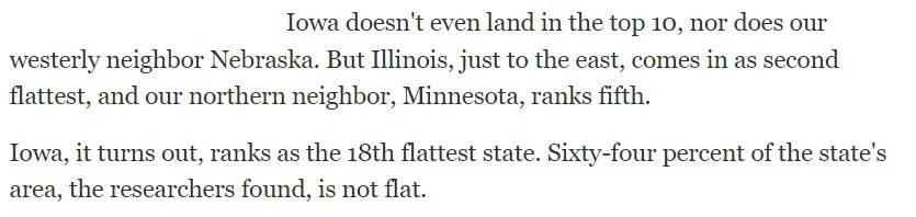

And before anyone jumps up and down and says "yeah, but........ Iowa, it's flat". I'll laugh in your face. You've not been through all of Iowa, obviously.
Jeep Gladiator Gladiator is crap for towing iowa-not-flat
Our non-flat 2/3 consists of some pretty good grades, including I80 east. Our "rolling hills" have decent elevation changes as shown on my JT's nav when watching the elevation numbers. So while I don't generally tow in mountains, I do tow where even the OTR guys have trouble keeping up speed and you constantly see and hear them shifting down and up.
