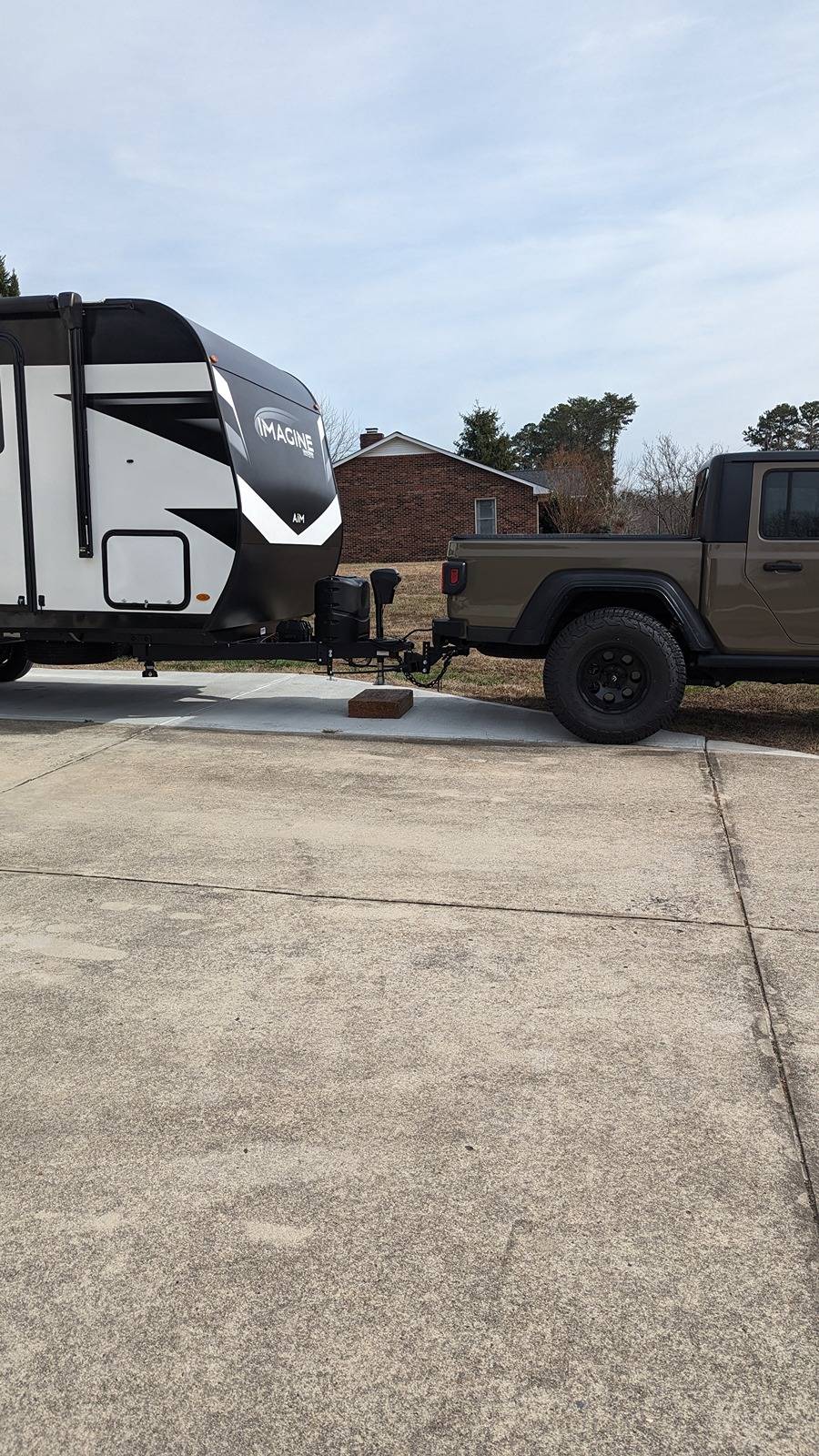

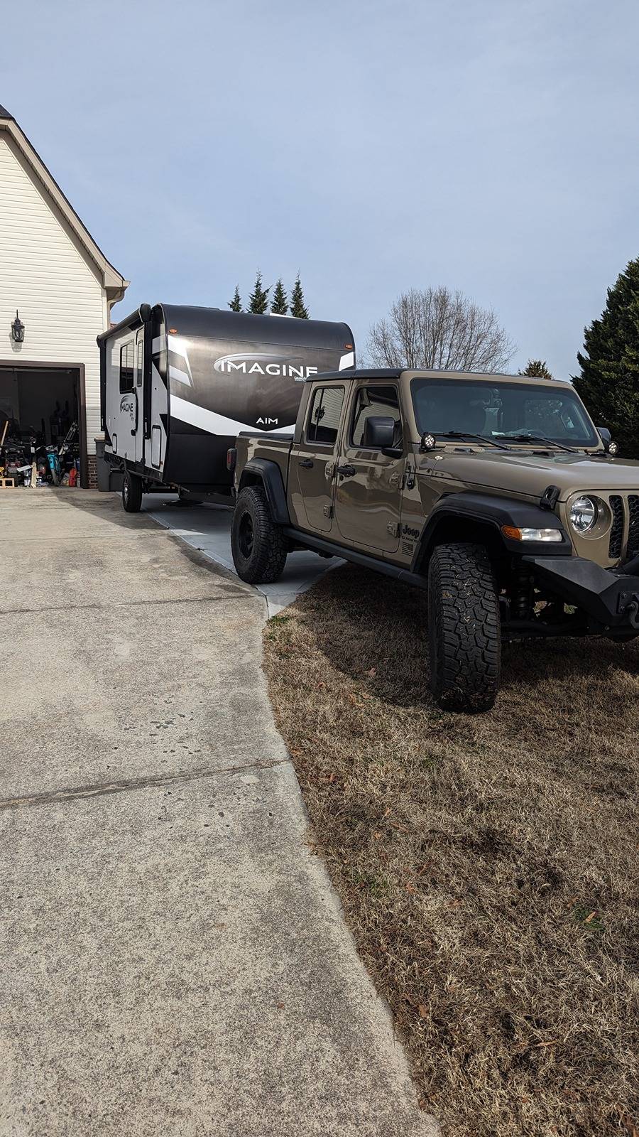

I tow a 6000lb dry weight camper and it does great. About 10-11 mpg at 60-65 mph on our 7 hour round trips to the beach and back. Define like crap?
Jeep Gladiator Gladiator is crap for towing PXL_20240328_234711471
That's on 37's. I bought 285 70 17 tires to throw on my stock wheels and I'm going to use those when I tow it and I should be closer to 12 or 13 I'm guessing once I put those on.
