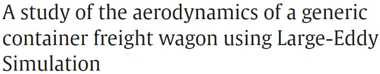

Jeeps are about as aerodynamic as a shipping grate
I've been trying to get some numbers on that, but so far this is the closest I can find -
Jeep Gladiator Gladiator is crap for towing 1705944485119
So i can't really say if it's as aerodynamic as a shipping crate or not.
