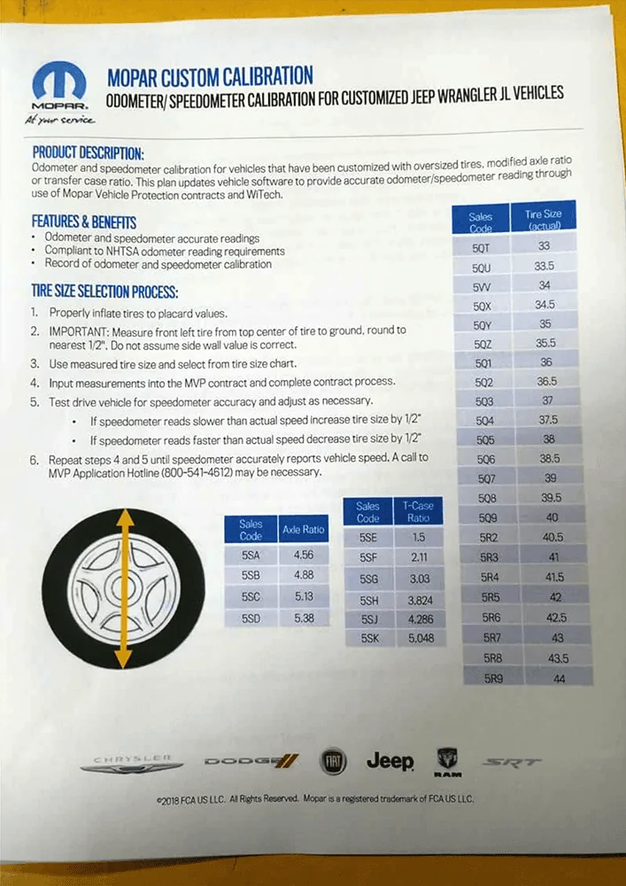

I tried pm messaging you and says I can’t . Do you happen to have those part numbers for speedo recalibration ? I think you posted them once here
There are no parts used to recalibrate the speedometer. It is done through a system reprogram with their computer.
There are sales codes for different gear ratios and tire sizes.
Remember you can buy a programmer for the same, or less, than the dealership will charge. The programmers have additional functions and can be used multiple times. The dealership is once and done, they will recharge you if you need it again after a system reset/flash etc.

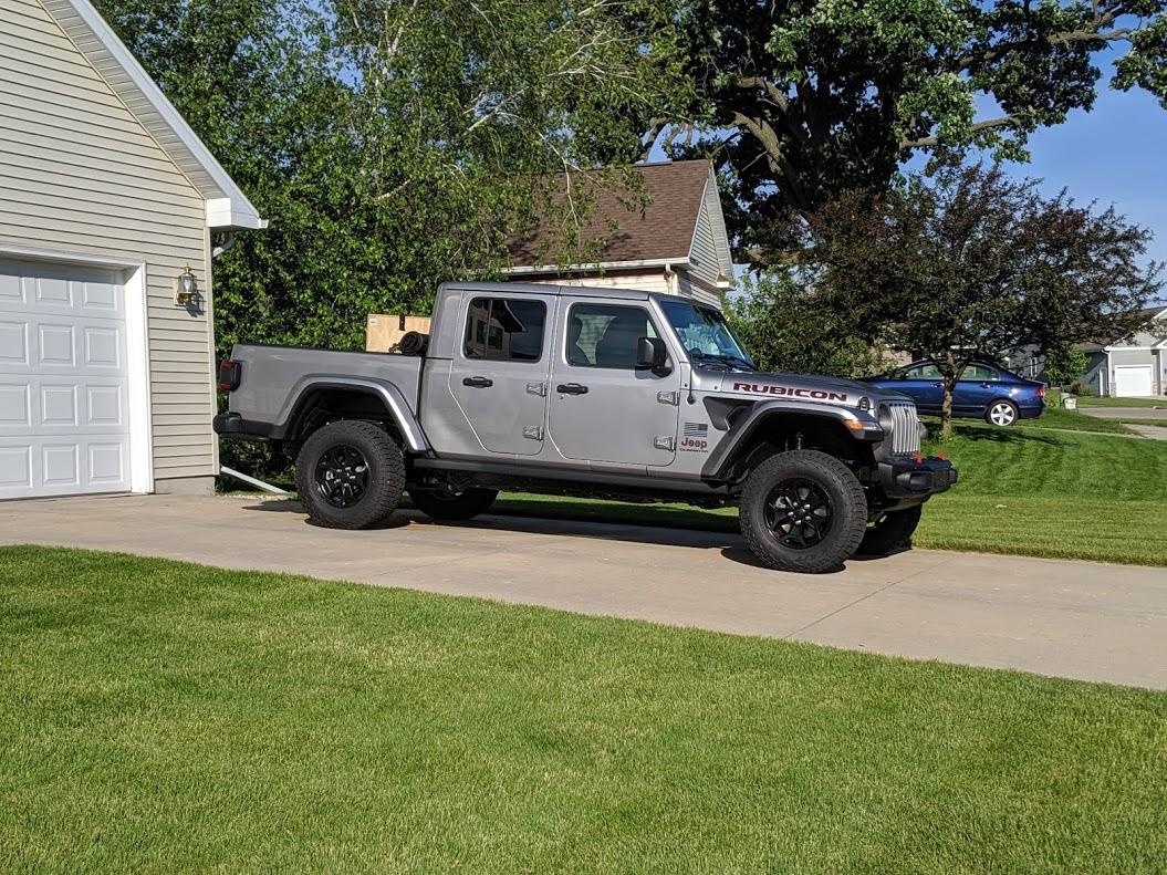

Does anyone have a picture of their rubicon gladiator with the 2 inch lift and stock tires? I want to upgrade tires and wheels latter but do not want the gladiator to look like the tires are to small.

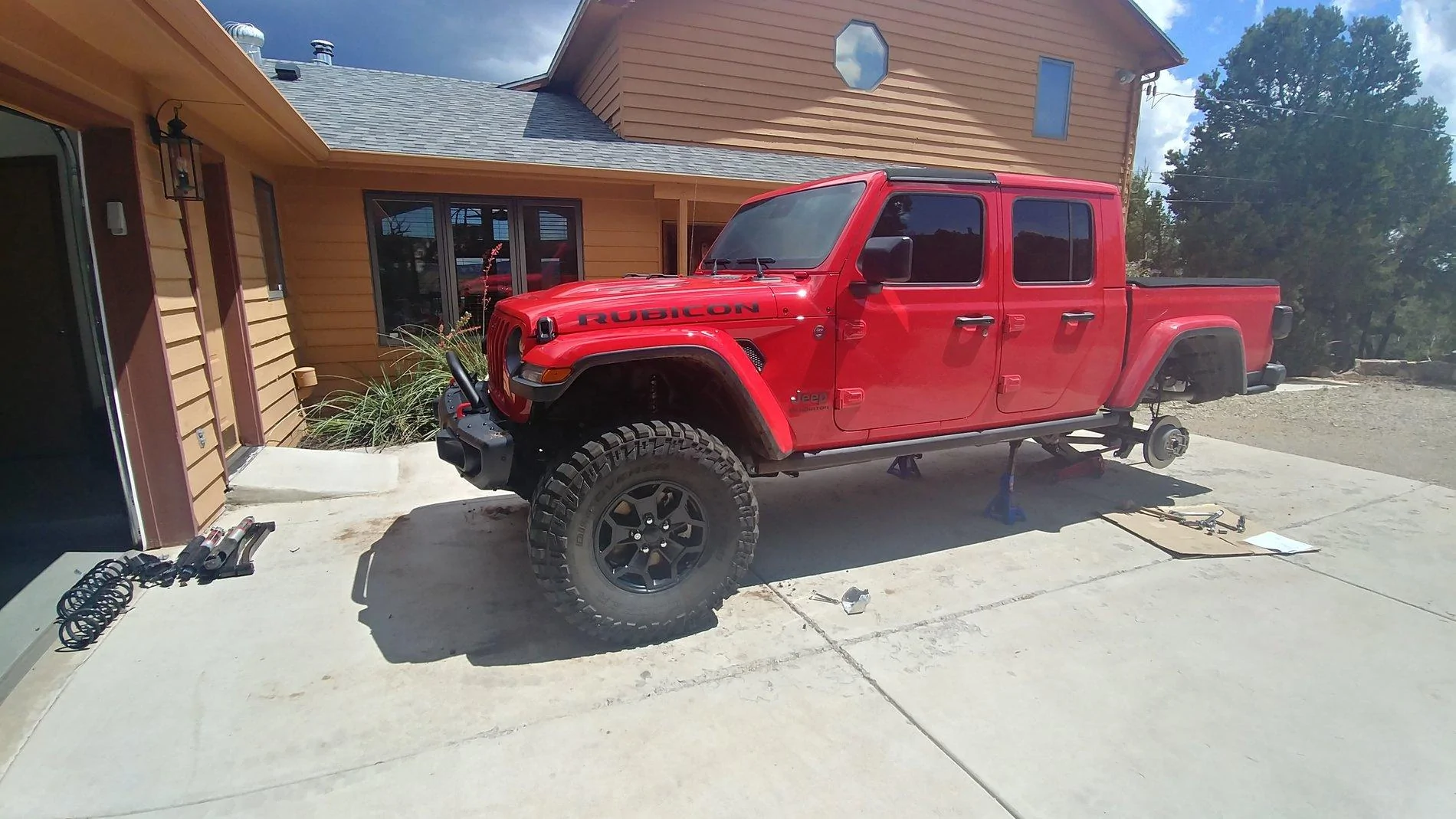

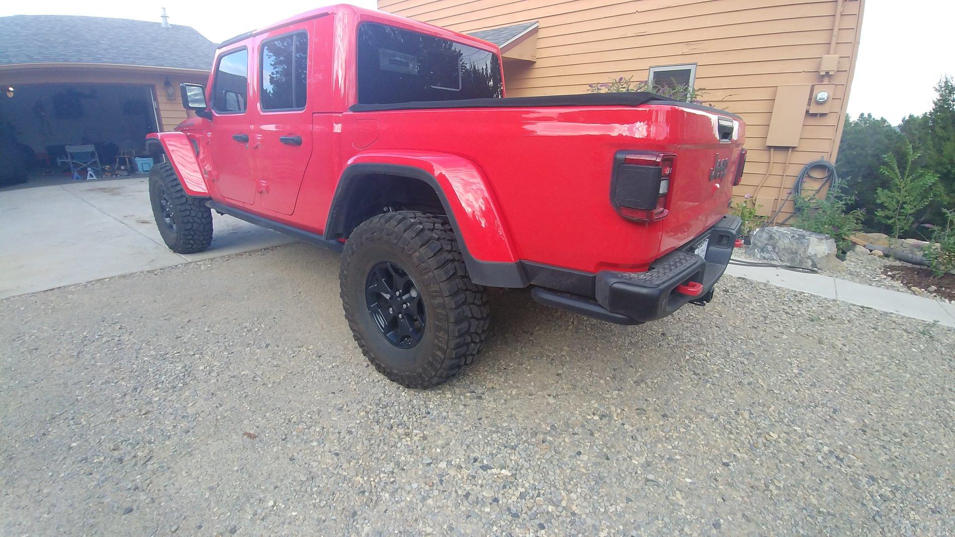

After installing mine, it came out to 2.5" but that was right after I installed it and it hadn't settled yet. I need to remeasure to see where it is now. I also installed a .5" spacer on the front to help level it out, but more for the added weight of the front bumper and eventual winch.

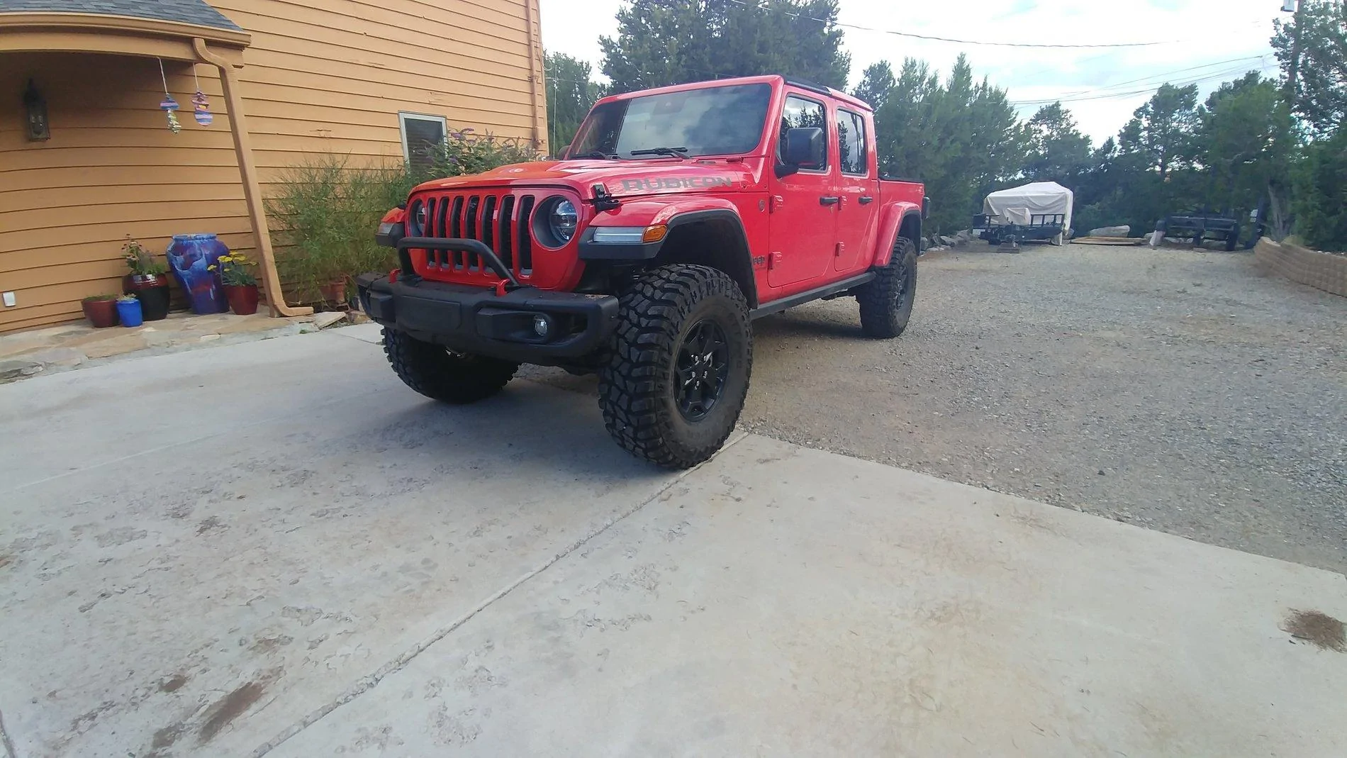

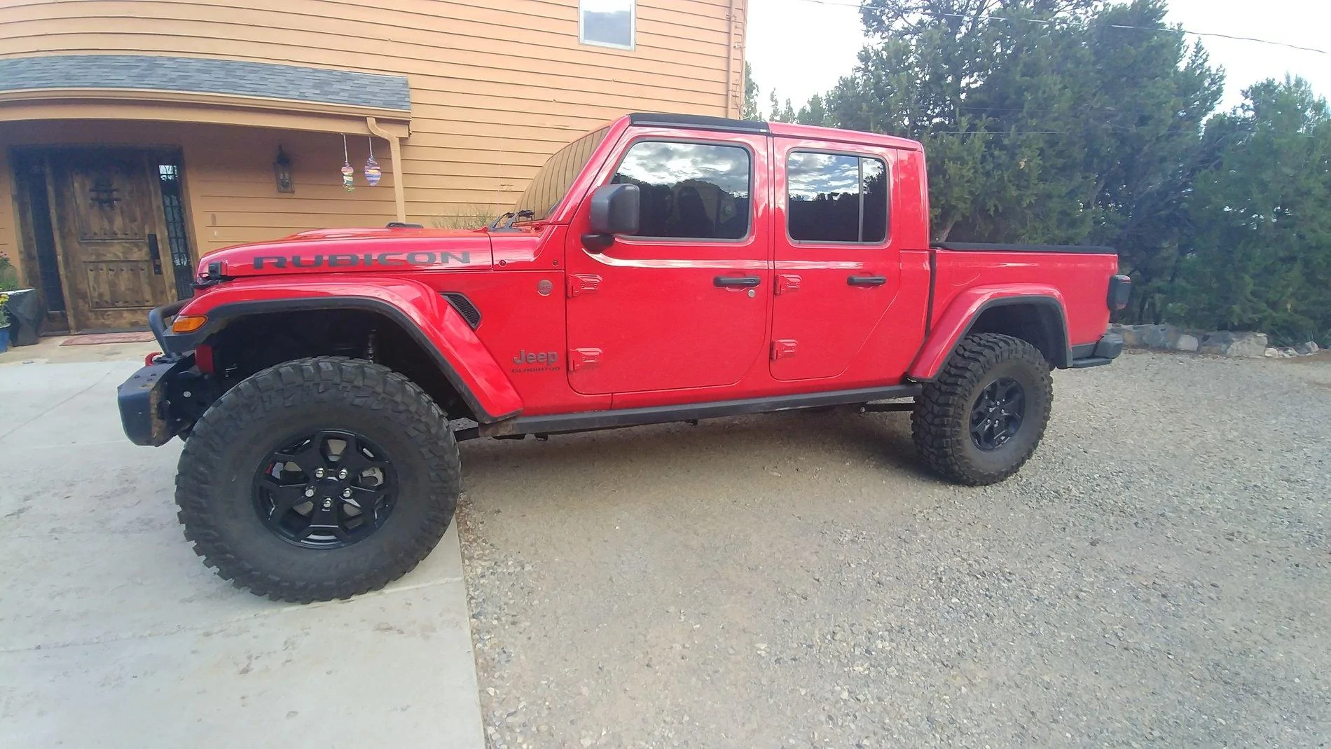

I just finished installing this kit. It gave me 3 inches. The bump stops in the front were a pain. I advise taking a wire brush to the threads before trying to put the nut on. Looks great, I am adding spacers behind the wheels to move the 37's out a bit when at full lock. I need side steps now, I'm thinking those motorized ones. Down side is they won't protect the paint from rocks and mud from the front tires. I'm searching the net for other options as well.
