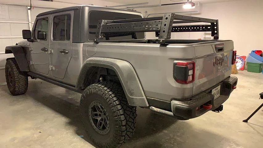

Jeep Gladiator Gladiator specific cross bars & bed racks now available! MAX Bed Rack 10x46 Side Vi

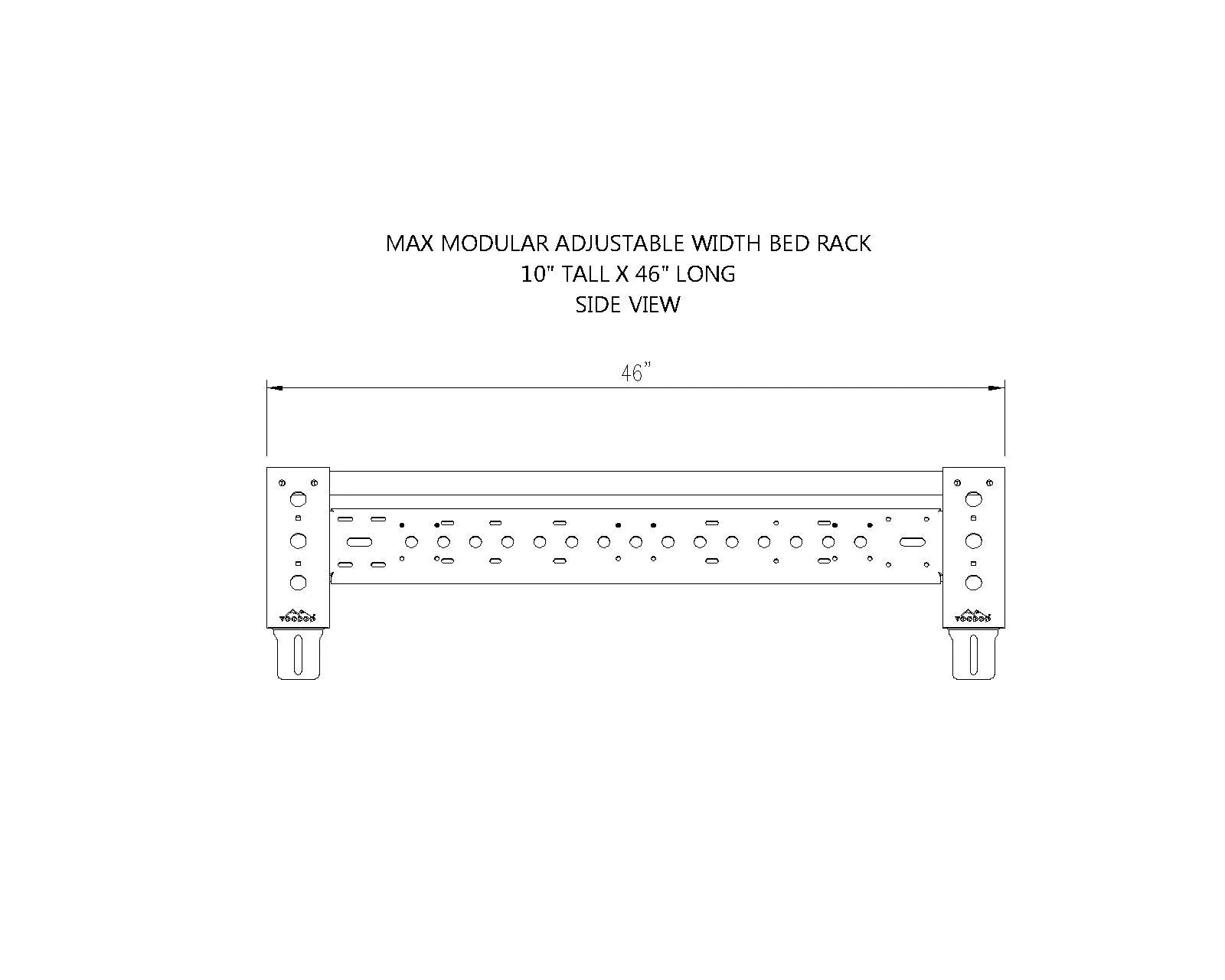

That's a bummer for those with the factory cover. Our rack is 46" long and it really can't be made any shorter without losing features.
If you look at our side panels, all those little holes provide certain mounting points for various accessories. If we made the rack any shorter, a bunch of those holes are going to be gone.
For now the only option we have for the factory cover is our Hi Rise Crossbars: https://www.kbvoodoo.com/shop?category=Truck+Bed+Crossbars
You would just need to make the rear brackets attach prior to the factory tonneau cover latch on the rail system and instead going straight up and making the partial square around the cover, have a flat peace go down the bed to where the original bracket would be then make the partial square around the cover
Jeep Gladiator Gladiator specific cross bars & bed racks now available! Rear Bracket
