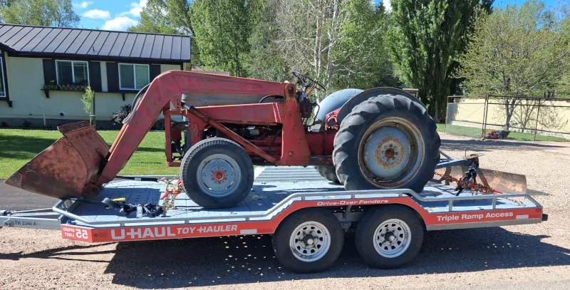

I did some measuring and I can use the open tandem axle U-haul trailer if i set my bucket on the front rail. With my loader and box blade its suspiciously long for its size šŸ˜„
Chris, if you look at the picture in post 28 this is what I did with the U-Haul Toy Hauler trailer (16' bed).
Total length of the tractor from front tip of the bucket to rear edge of the blade is 17' 10".
Position in this picture put the weight just right for a good tongue weight.
Good luck with your move!
***ETA Found a better picture of the tractor on the trailer***
Nice. I looked at those too but they were wildly heavy for their size.
I really need to make my future father in law get his junk off his trailer. Its just right for moving my tractor and doesnt cost a rental fee šŸ˜„
The tractor as sitting on the trailer is about 3,700 lbs. Your tractor is lighter. Should not be an issue.
But free use of a trailer means more beer fund. Maybe mention to your future father-in-law that you'd be willing to share the bounty of ice cold beer for the use of his trailer...
Yea mine and that trailer combined would come out to about 5800 pounds. Nice lil load. He doesnt drink but im sure he would find work for me, lol.
