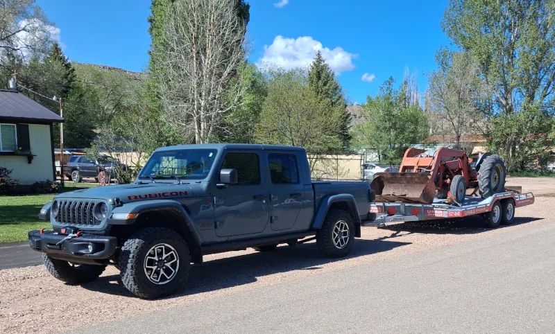

My vote (fwiw) is half ton.
I originally had the thought to tow a smallish 6klbs to 7klbs toy hauler. But the winds are a killer with the Jeep by itself. If I had to deal with the winds across the plains (it's a long way from Kansas to the Rockies), hands down it would be a half ton. That size truck has a perfect road presence for a 6-7k lbs camp trailer.
This comes from first hand experience towing with a '25 Gladiator Rubicon-X completely stock through the western side of the Rocky Mountains. As well as a trip from Eastern Utah to Missouri via I-70 with just the Jeep.
Case #1 (Success story).
Purchased an old Ford Tractor with a loader, and rear blade. Rented a U-Haul "Toy Hauler" trailer. All up weight about 6K lbs. Towed about 100 miles rolling over and around the benches of north eastern Utah. between 5k' and 6k' elevation. between 50 and 65mph. mostly 2% grades, with one short 8% grade.
Towed amazingly well. Trailer was pretty new with well adjusted surge brakes. No trailer sway, and the tow was comfortable. Fuel mileage averaged 6mpg with an easy foot on the gas and brake.
The only downside was the ride quality with an empty trailer. Very harsh and bouncy. Loaded the ride was very comfortable. Spring rate was fine, just needs shocks better tuned to the application.
Jeep Gladiator Gladiator trailer tow Jeep & Tractor
Case #2 (very poor driving experience across the plains without a trailer).
Made a trip out from Eastern Utah to Missouri, via I-70. Typical gusty winds through Colorado and Kansas. Gusts were pushing the Jeep all over the lane. Got tiresome quickly. Fuel mileage trying to run 70mph dropped to under 15mpg. Jeep was constantly shifting to try and maintain speed within a 5mph delta over the rolling terrain.
Coming back I kept the speeds down to 65 mph max. That helped with the noise issues, but was still getting blown all over the lane due to gusts.
Having towed a 14k lbs 5th wheel all over the U.S. with a short bed crew cab 4x4 1 ton, and having had a commercial drivers license hauling heavy equipment, I'm pretty comfortable towing.
If I absolutely had to tow a camp trailer with a mid size truck, it would be the pre-'24 Gladiator Sport S with max tow package. Great brakes, long wheel base, simple reliable port injection engine.
That wrote, I'd pull every string possible to move up to a half ton for a more pleasurable drive.
