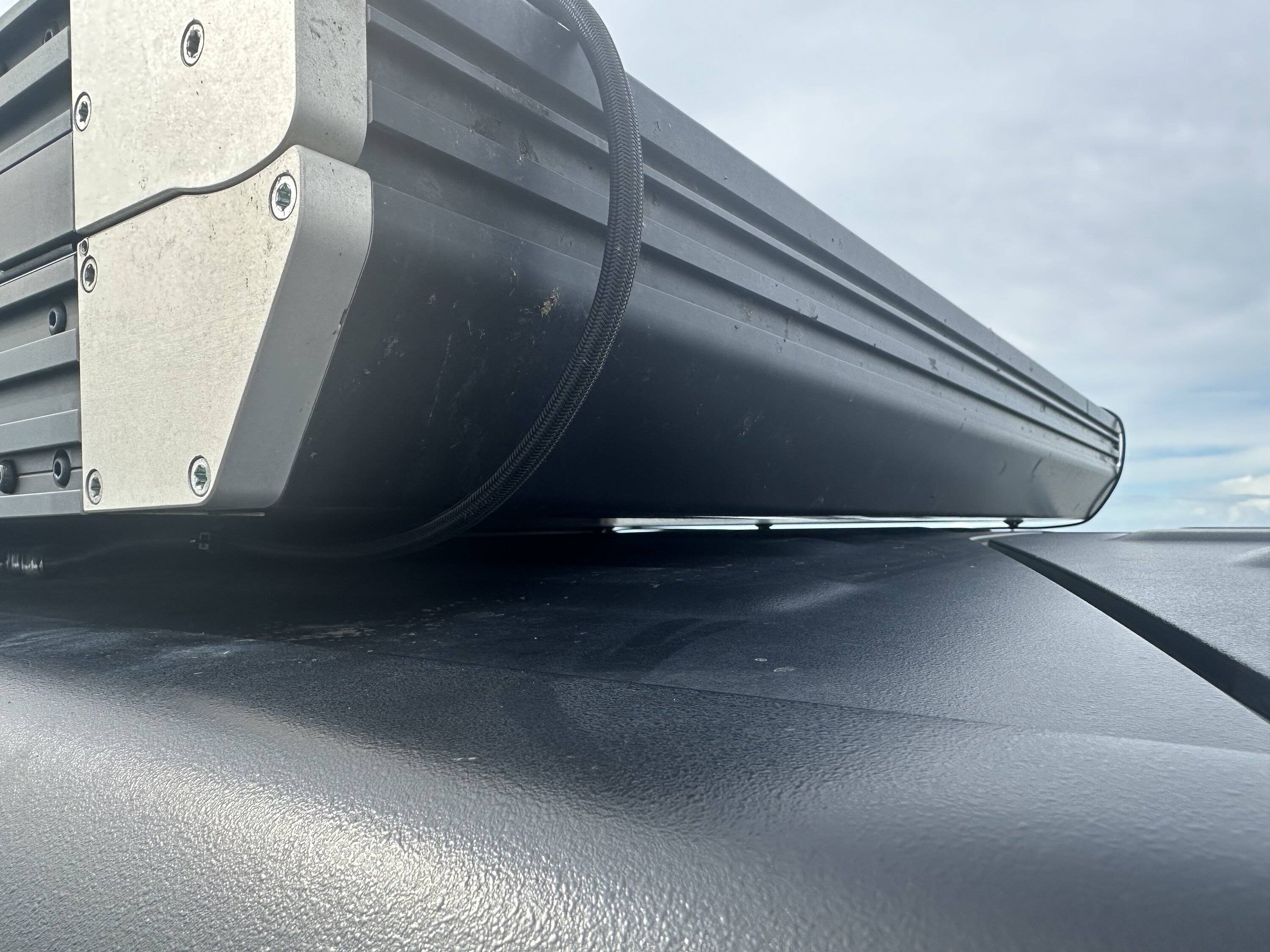

Does anyone have a measurement of the gap between the roof and bottom of the GFC?

It is tough to get a measurement of the gap, the roof line is slightly arched and then there are the raised ribs. The front edge towards at the center of the GFC sits about 5/8” from the roof. At the rib it is probably less than 1/2”. At the sides it is 1 3/8”.

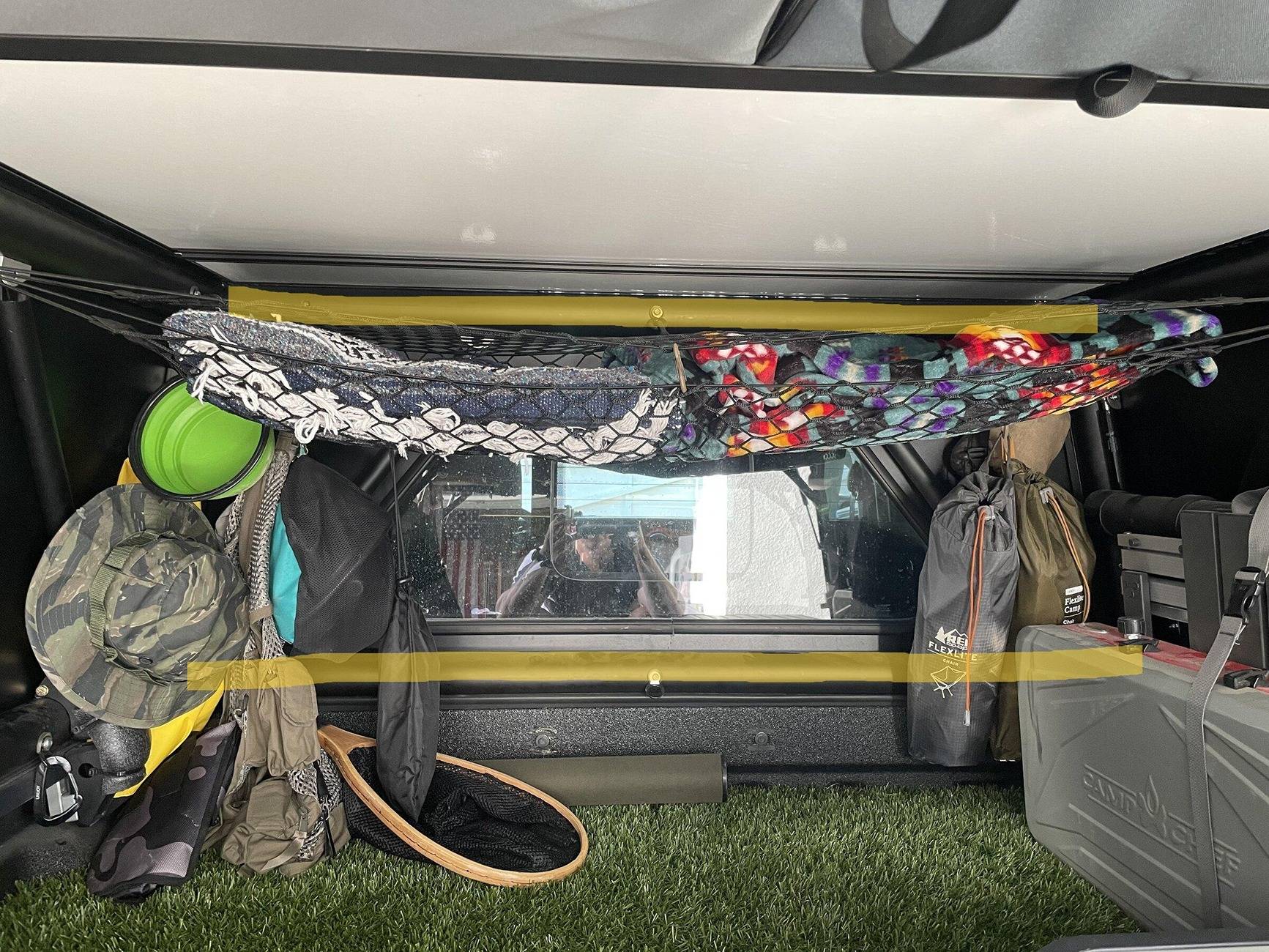

I’m thinking about buying a GFC but I want to make sure my mountain bike will fit in the back. Does anyone have a measurement from the top rib of the bed to the bottom of the sleeping platform?
I can grab one, but I can say I can fit my 27.5 P4 in the back with the bars rotated.
I have a bed mat in so its probably more in a truck with just a liner or paint. But Bed to top is 41". From the top of the bedside to the bottom of the inside of the cap its about 23.5".
Exactly what I need! Thanks!
