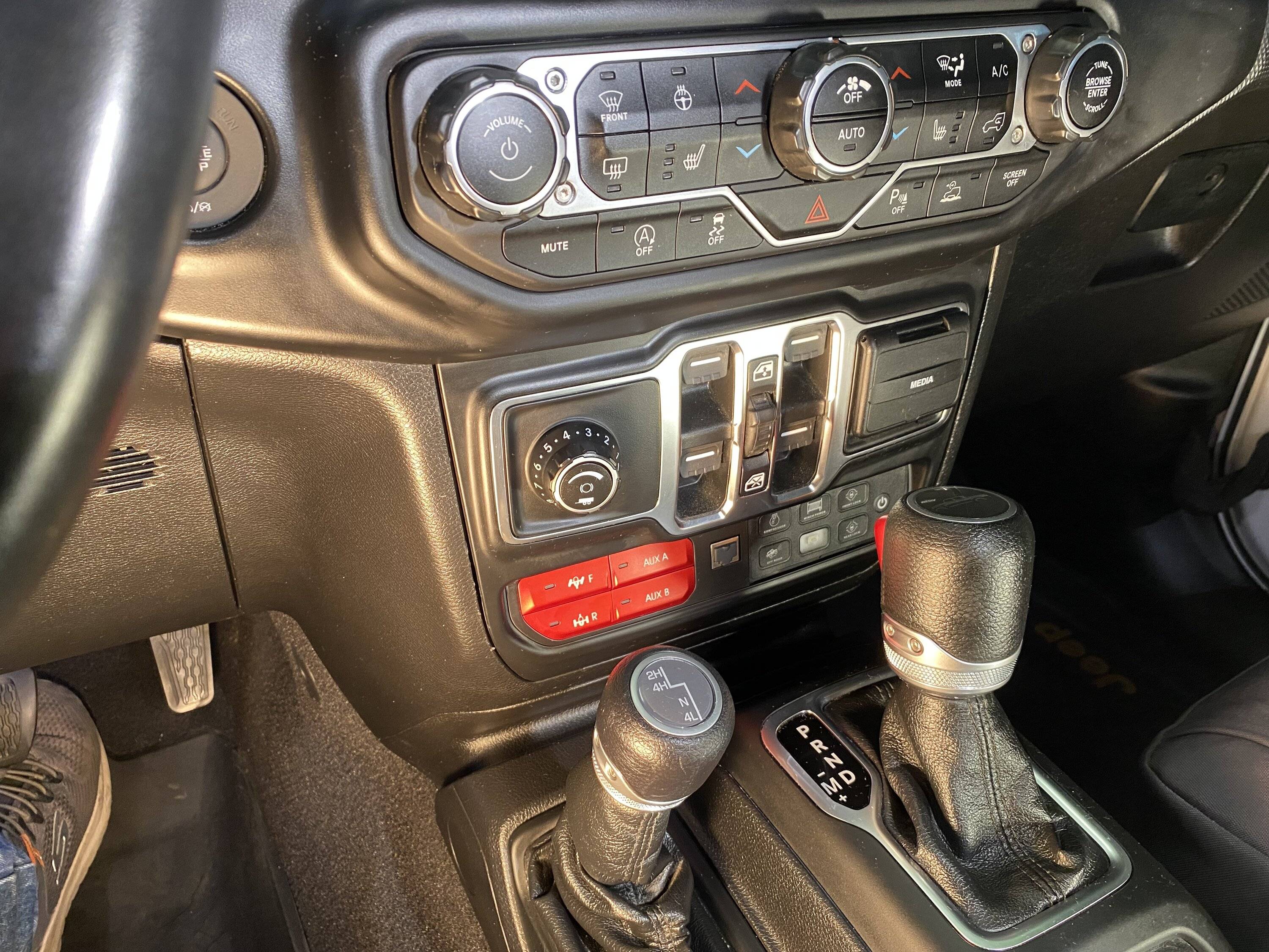

Thanks for all the responses! Here’s where Lasfit says no manual trans vehicles so likely I’ll go with Voswitch. I’ll keep you guys posted, and thanks again!

The issue with the manual transmission is the firewall hole that most companies tell you to use is the hole for the clutch pedal, that you don't have available.
With my Voswitch, I didn't use the hole for the clutch, I dropped the windshield and routed the control cable through there and down under the speaker grille cover. To me it was much easier and faster. It doesn't leak either. I did the same thing on the other side for my ham radio power cables.
If you do it that way or make your own hole, you can use anyone's switch setup.

There are other ways to get wires thru the firewall. Any switch or switch panel will work.
+1 for LasFit. Awesome product.

Loved the factory look of the Lasfit and the optional safety feature (will only engage when in 4-low when wired to allow this feature). The switches do not require the safety feature to be activated.
That setup looks nice!
