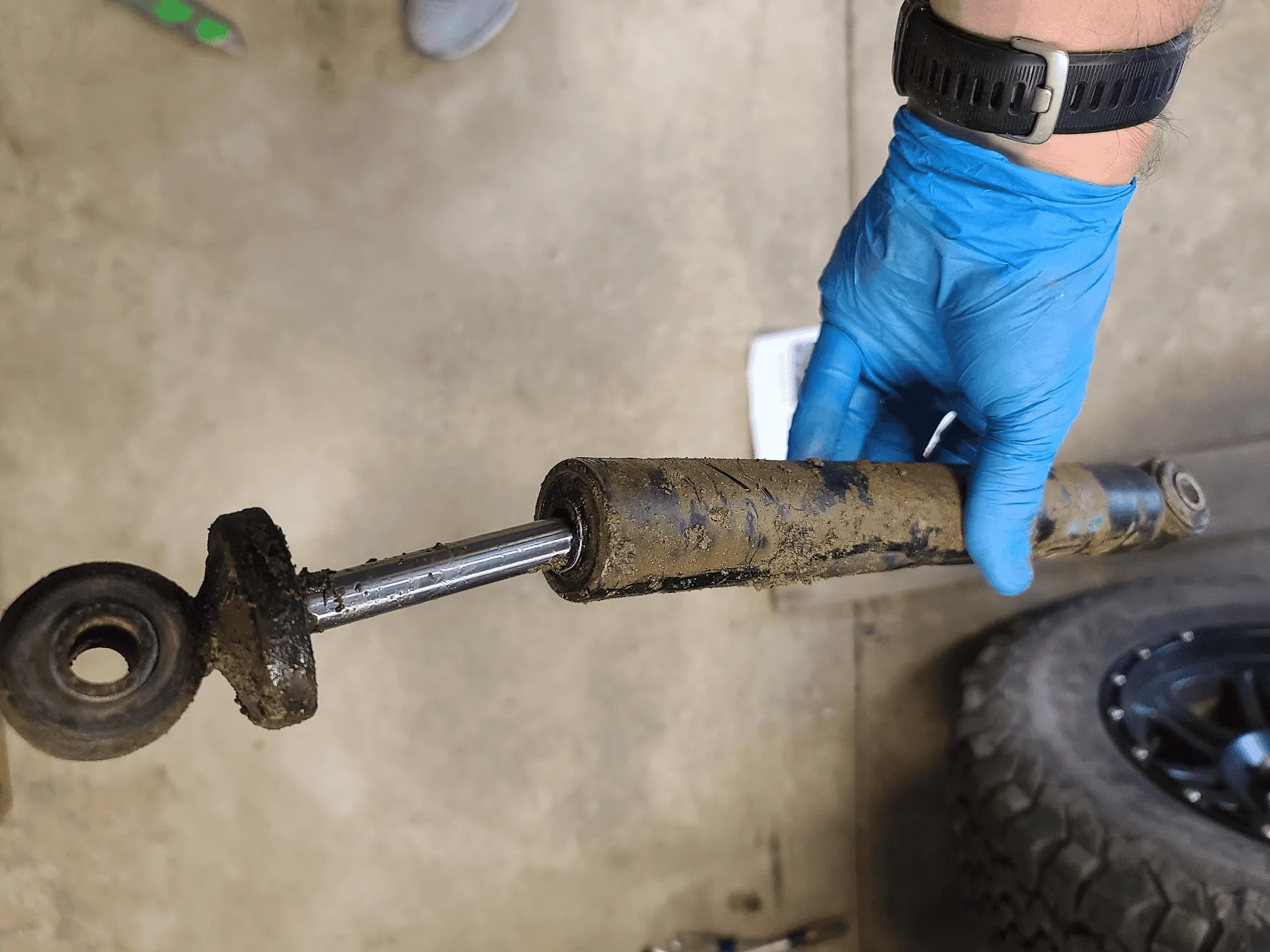

I didn’t notice any leaks, but I’ll have to look again. Do you think I could have damaged the steering box internally?
Mine is really just 'sweating', but to me that is a leak since it should be a sealed unit. My Mojave has a 1inch spacer up front with an ARB Stubby and a WarnM8000s and 35's. So as far as I am concern that's pretty much stock!
Mine isn't leak
Try removing one end of the SS and see if you can compress and un-compress it by hand. If it moves with little resistance it's shot... you could have smacked it on a rock and lost fluid.
Or done this... but this one was pretty obvious
I did something like that to my stock Mojave stabilizer! Replaced it with a Teraflex Nexus 2.something adjustable. I was barely able to steer to get off the trail!

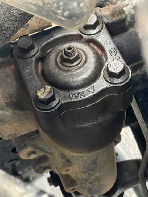

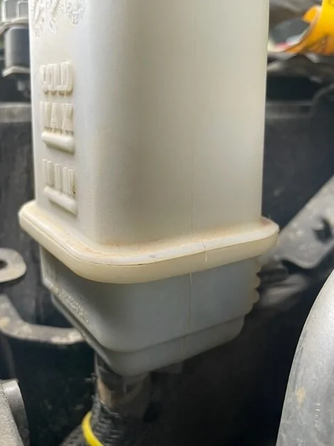

Speaking of Steering Box problems. I was wondering if this looks like a leak to you all or is it just the "sweating" Bjeepz was talking about?
Jeep Gladiator Guess I shouldn’t have forced it (steering). IMG_3515
Jeep Gladiator Guess I shouldn’t have forced it (steering). IMG_2967
40,465
53,924
I don't see anything at all - nothing looks wet or oily.
To what are you referring? Where? Can you point to it?
The fluid is below the minimum mark - is that what you are meaning?
Oil doesn't "sweat" - there's either a leak or there isn't. And if there's any dampness making something look slightly damp, collecting dust, that's not going to make a noticeable drop in the level in that reservoir.
Was that reservoir ever at the max or minimum marks? If so, how long ago - how many miles?
Did you look in the area of the power steering pump? (it's electric - these are electro-hydraulic power steering or EHPS)
Not really enough information to go by in your case.
You are showing a low fluid level, but don't show or say anything else.

I was more looking at the actually box in the 2nd picture because it looks wet and I haven’t messed with it at all. I would hope the reservoir has been full before, but I didn’t check when I got the truck.
