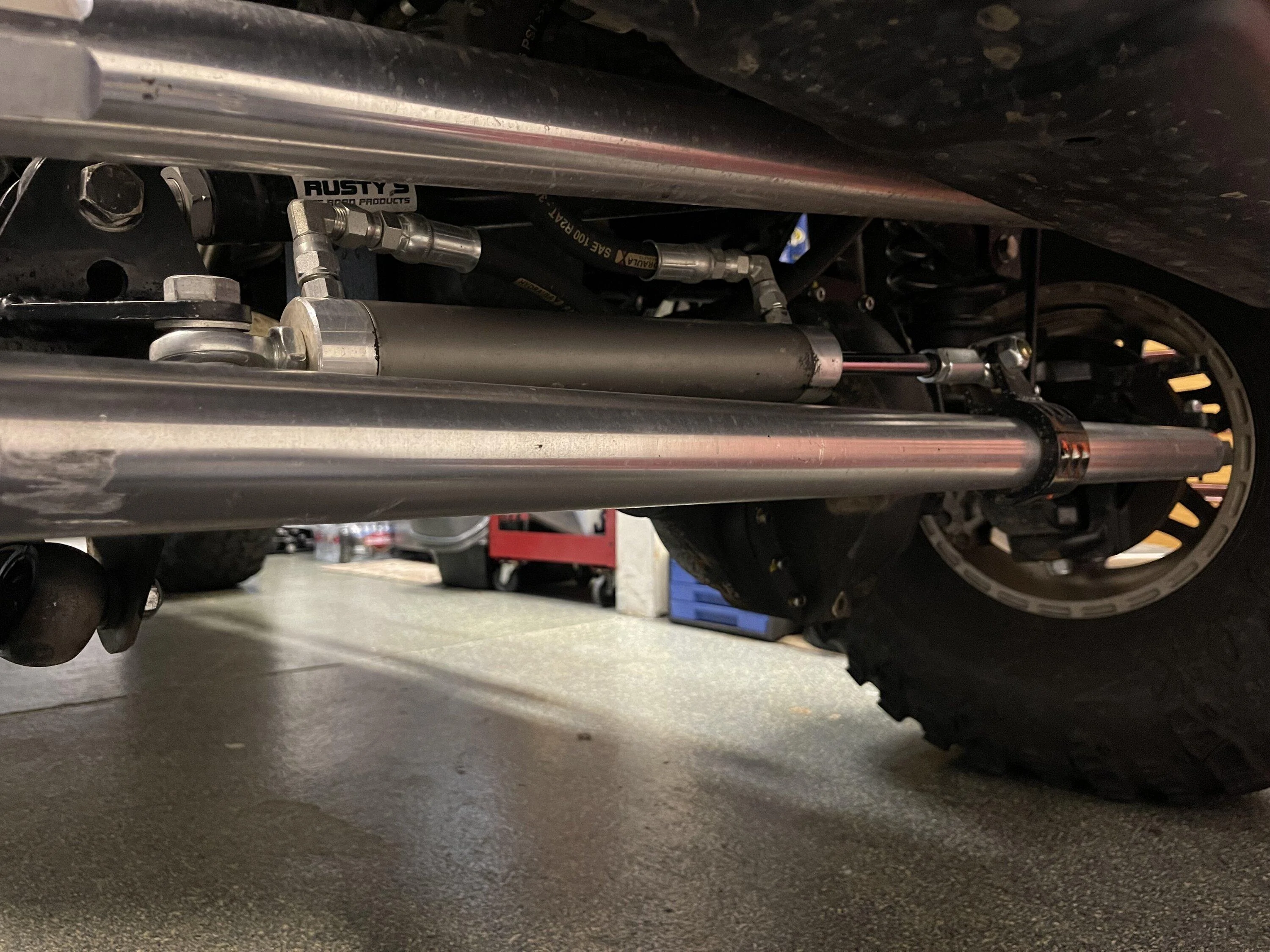

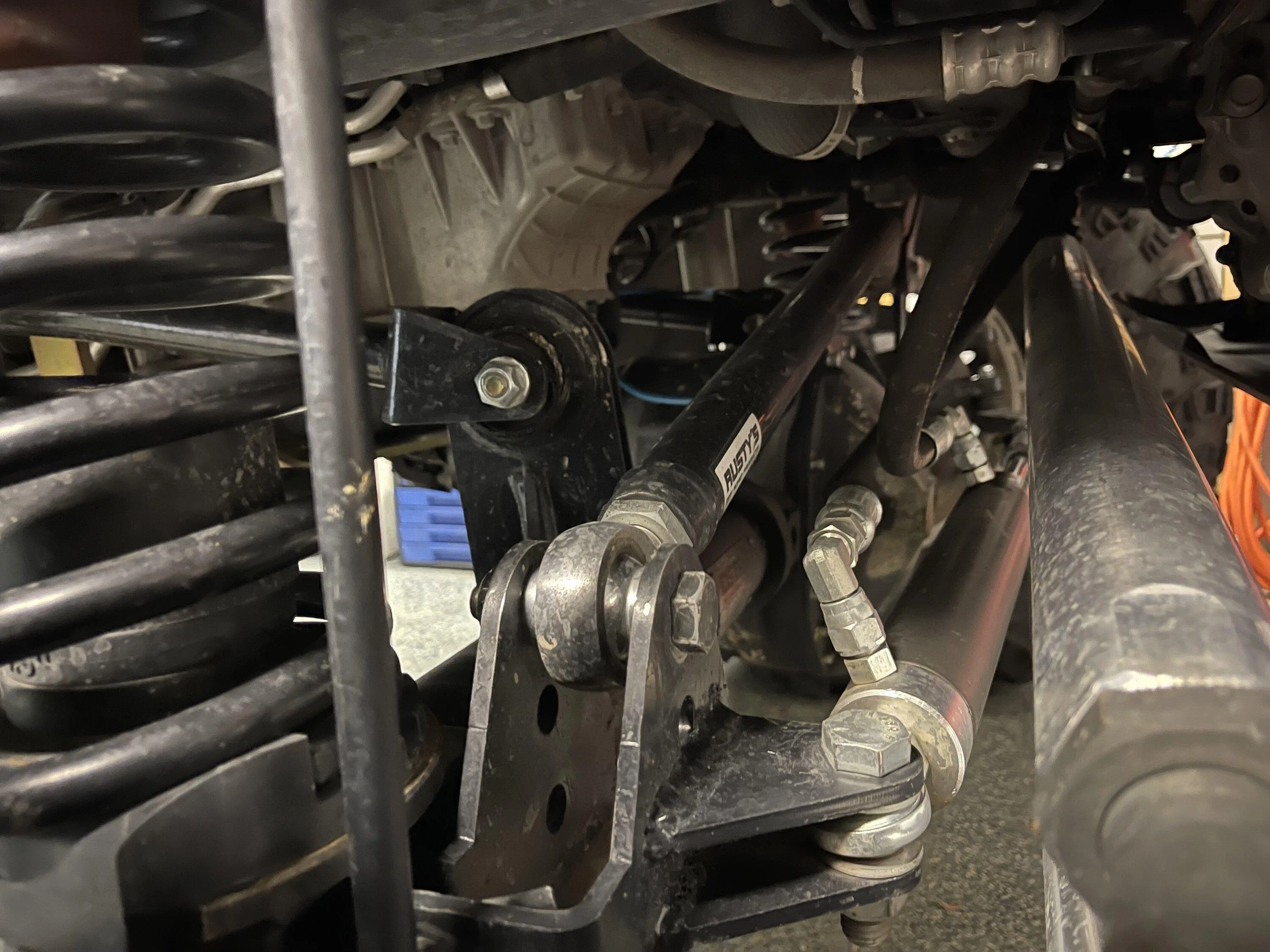

Thanks. I may give them a call. Do you have this system? Can you share some pictures of it installed?
