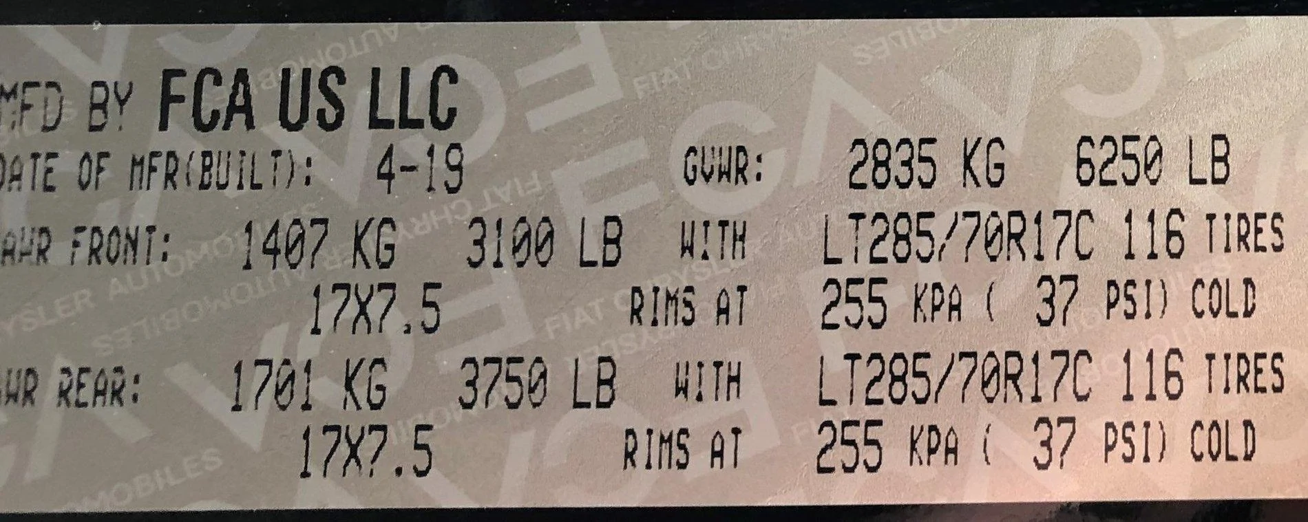

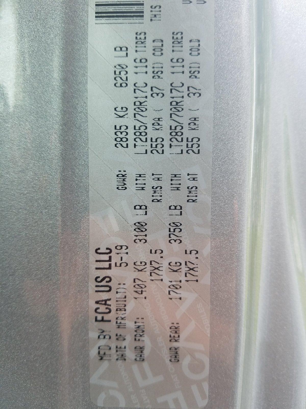

If you've got a Rubicon or Overland, can you post a picture of your door jamb sticker GVWR and GCWR. Google gives a vague number between 5,800 lbs. and 6,250 lbs for GVWR. I'm trying to get a better idea of how specific models are rated and the door jamb decal is the only way to really find out. It's not in the owners manual either, oddly.
Rubicon:
Jeep Gladiator GVWR door2

Thank you, sirs.
6250 - roughly 1150 payload = 5100 lbs. curb weight which is right on the money.
Very helpful, thanks.

Thank you, sirs.
No problem, i am curious to see an Overland sticker.
Whos got an Overland?
