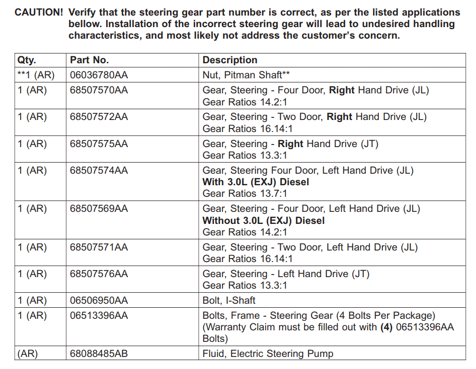

So this just in…. Dropped it off yesterday for service today. Left instructions to call me first thing. No call. I just called and service advisor tells me they are putting in a track bar. I explain that the wrong box is installed and he tries to fight with me that it isn’t. “Same box for both the Wrangler and Gladiator” he says. OMFG how can they be so incompetent? I begged him to look up the part numbers. I just left for a 2 week vacation this morning. Maybe @JeepCares can help?
They've got to be kidding! All they have to do is ask their parts guy to look it up.
Totally different wheelbase, different ratio.
Apparently you don't have another dealership in close proximity or I'd dump them like emptying the waste water tank from your camper.
Can't that moron READ?????? It's clear as 2nd grade reading class the differences, spelled out in the TSB itself.
Too bad you can't email him this list - and the caution at the top - there are SEVEN freaking different steering gear part numbers! Only ONE is correct for a left hand drive JT. One out of 7.
