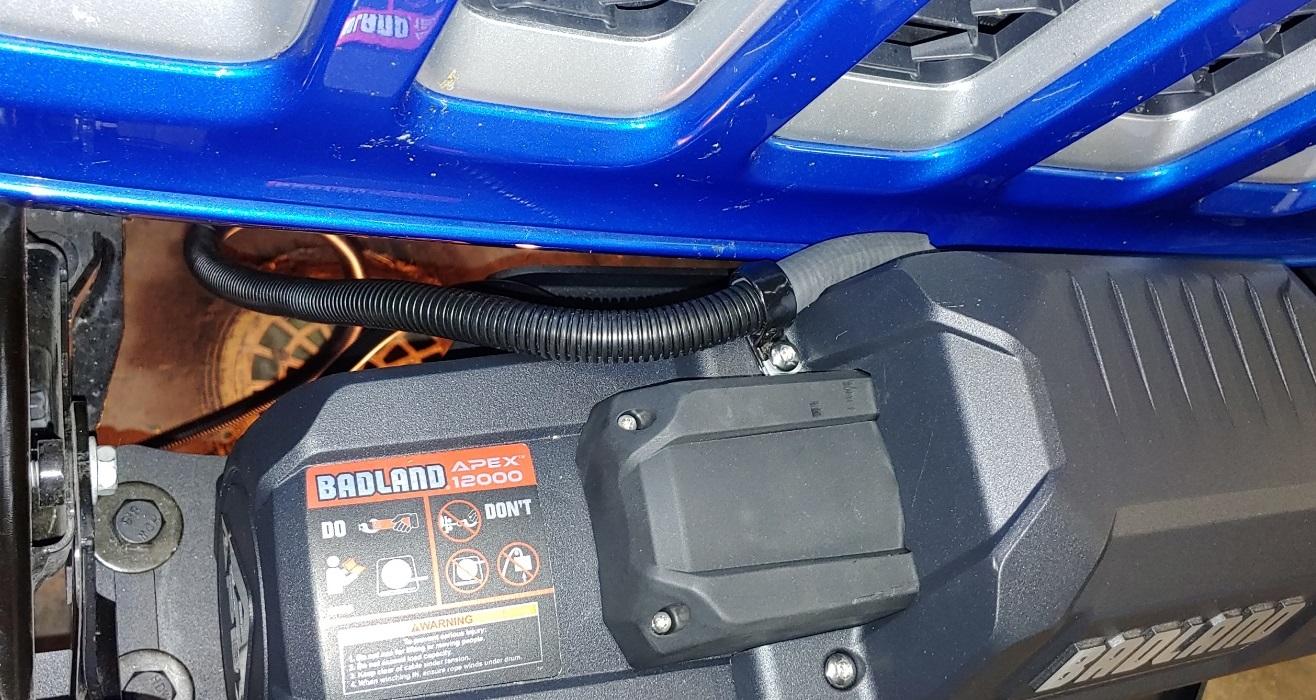

They may not be 85 pounds but they are HUGE.
Got mine mounted and tried to put the bumper on and it won't clear the top housing. I'll have to shave about 3/8" off the edge of the bumper to clear and the winch is as far back as it will go.
Winch is pushed back hard on the mount, and there's barely clearance between it and grill so it's not that.

Yes - and, granted, it's a product made in China, blah blah blah and I do have a couple of "complaints" but they are minor in the grand scheme
I'm taking pictures and making notes and will post a thread on my experiences with it, MY mistakes, what I learned, how others can skip my learning steps and more.
Right now, though, I have a QUESTION related to this and other winches (as opposed to wenches, no need to ask about that)
WHERE are others routing the CABLES for this winch, or even others, IF THEY ARE NOT relocating the box on top.
After a couple of quick mods I have plenty of room for the electrical box on the top of the winch, but I would like to know - where is everyone running the cables up to the battery????
There's almost no open paths up to the top from where a winch mounts. I could see a couple of "idea" places, but I'm not totally impressed with those paths.
I want the cablres safe, tucked out of the way, not in the way of any future plans, etc.
I WILL be using a cut-off switch, the one that's supplied with this winch but that won't matter as all I am looking for is - what path are people using to get from A (the winch) to B (the battery area) ??
I am also going to have to get creative with the clutch lever - without the bar, it rubs on the top of the bumper - WITH the bar - you can't get there.........
