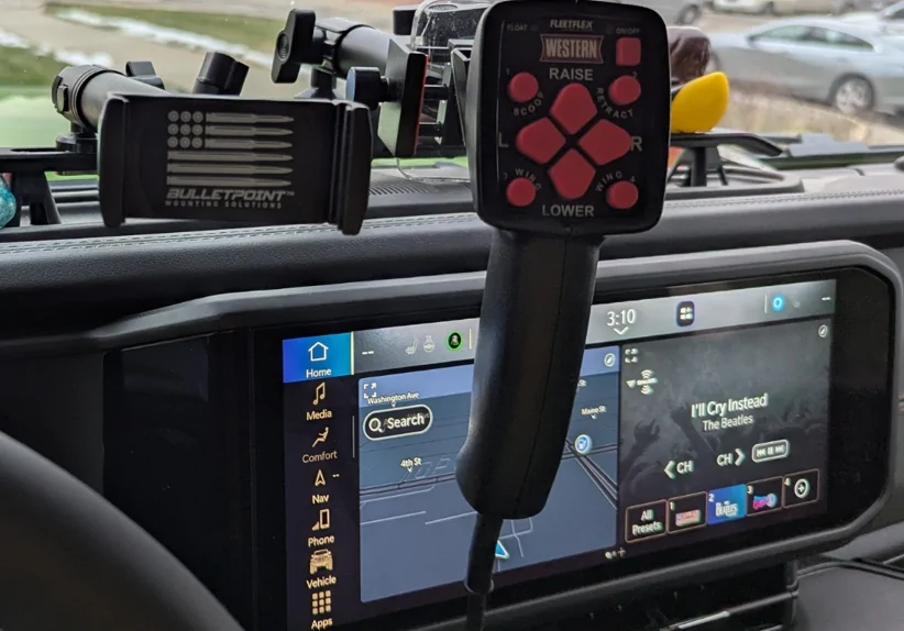

Occasionally my map side (I have map on left, widgets on right) goes black on startup. A reset works, of course, but then I noticed that if I switch headlights from Auto to On and then back to Auto it fixes it.

Anyway, I tried it again after it has been sitting a couple of days, and it's all good.
I'm betting it was due to an OTA update. These get very different updates from pre-24 models. They get map updates, among other things.

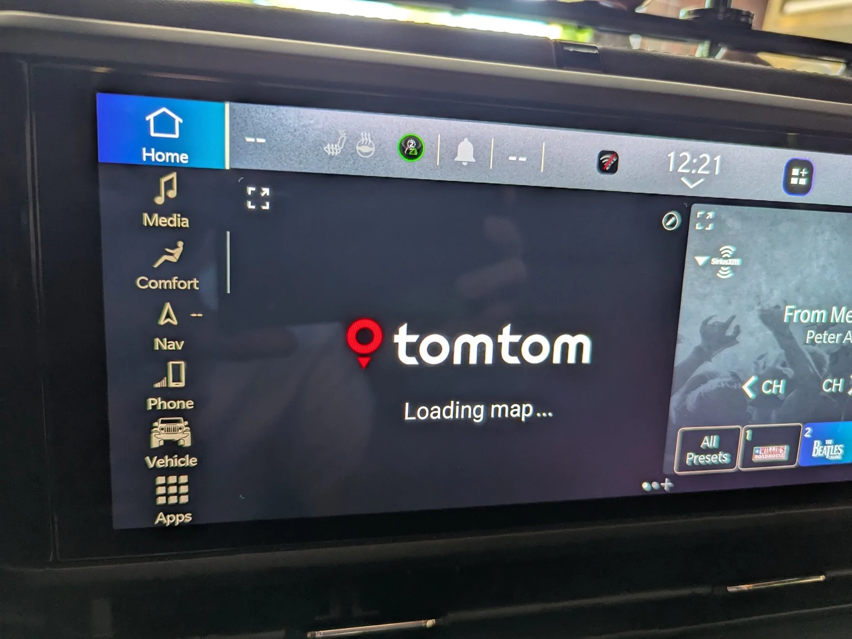

Normally, when you get one of those, you get a screen that stays like this for a couple of days, then settles back to the regular home screen. The NAV works, but the home screen won't show the NAV display after a NAV update.

Sounds like a number of folks had this happen to them yesterday. We also had it happen in the middle of our cross country trip yesterday afternoon.
Stopped one time for gas&snacks, but when we started the truck, the screen dumped into this behavior. Soft resets didn’t help.
Through hard resets and a lot of cussing, we got it to where CarPlay (nav) and the reverse camera would show up, but without any of the normal menu top/left bar functions. It stayed like that through a couple more gas stops and finally came up working after the last one, 8 hours later.
Really annoying, along with the forced OTA updates that lock out the entire screen and cameras without a choice to delay it until it’s safe/more convenient. We sat parked at a gas station while it started that process at a pump once. Fortunately we were not pressed for time then.
I doubt FCA/Stellantis is trying to fix these issues — they’ve been around for at least a year. I’ve started to think it’s just Uconnect5 and we completely skipped looking at Ram trucks in our consideration for a HD/SD tow vehicle purchase because of it.
All I'm saying is the xm in mine sounds like the GE alarm clock radio I had as a kid, but everything else, even FM, is better sounding. But I hear you on the cost cutting measures of Stellantis.
Unless you NEED those incremental map updates, try unplugging the cellular connection from the back. It won't void any warranties, or prevent it from starting. You just won't have new bugs or delays...or ads as some people have been reporting.
