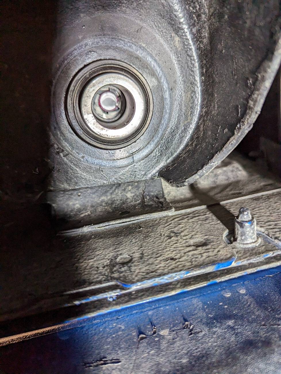

Jeep Gladiator HELP! Broke body bolt PXL_20230323_204226188
I've done two Jeeps - a JLU and my JT, and it's exactly like other Wrangler owners said - always that left front (not the far front in the engine bay, but the front of the 3 you need to loosen).
Some were easy, some were really stubborn. The left front I had loose enough to get the bracket in place between bolt head and big washer, and as I started to tighten, it snapped.

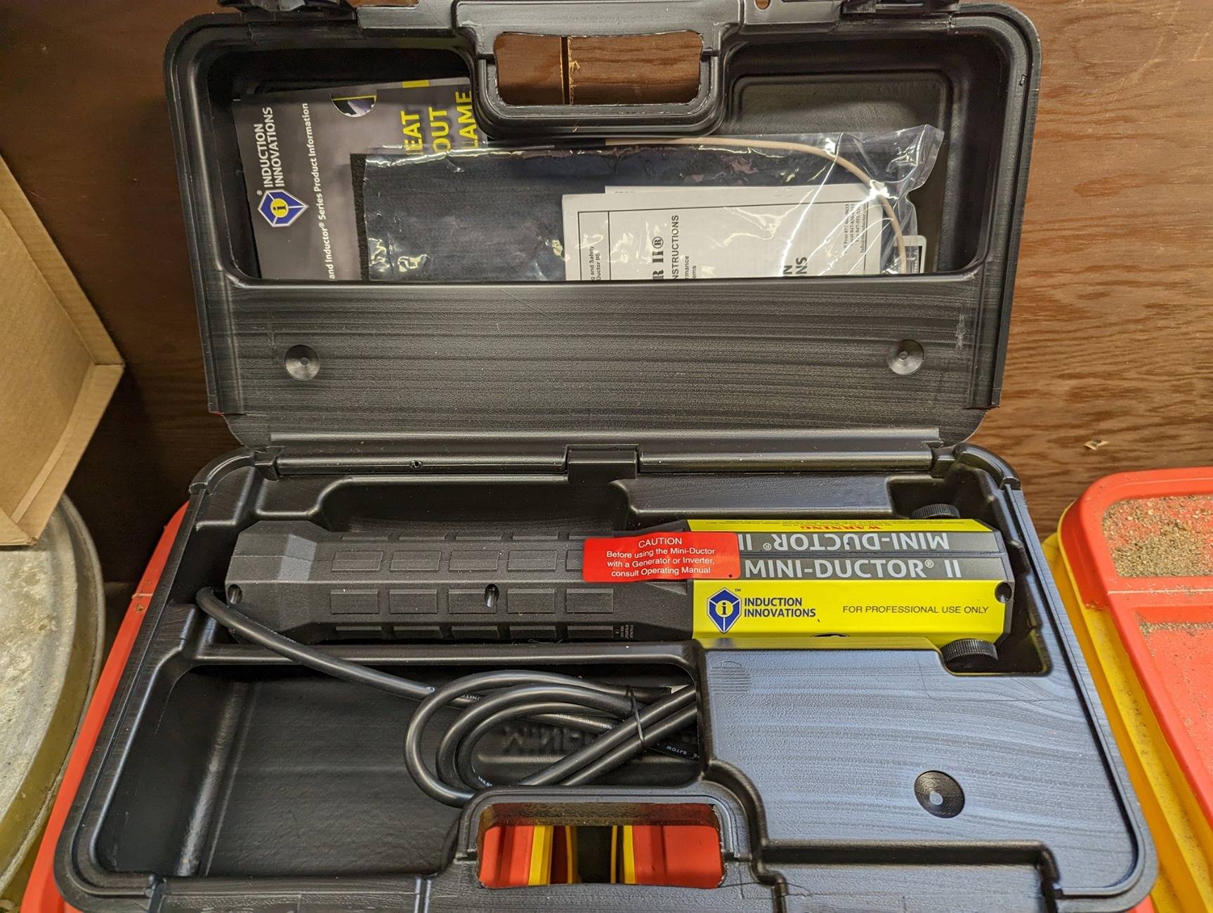

I then did what I should have done before even putting a wrench to it - bought the induction heater.
Even FCA's own documentation shows and says - use an induction heater on the body bolts. It's in black and white in their own "how to remove the body" documents.

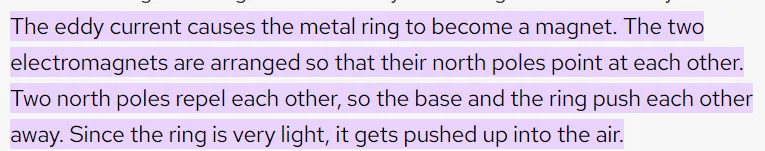

From WIS.EDU physics department -
Jeep Gladiator HELP! Broke body bolt 1719778649266-1d
The video below is a much smaller version of what our teacher used. The coil he used was as big around as the magnetic coil on a 1980 car AC compressor clutch. And the aluminum ring was larger and shot up hard to the ceiling.
