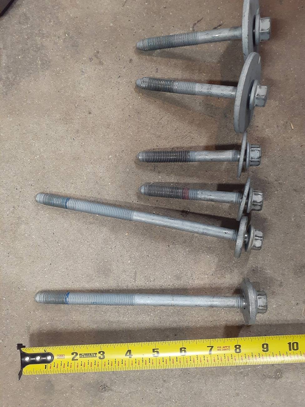

I read all the reviews with the snapped bolts and went with a torch. I would have chosen to go with the inductor if I had one on hand.
Same as OP. Heat up, small 18" breaker bar to limit torque. Small turns. Then more heat. Back and forth. Then when it was going better, more heat and the large breaker bar.
Couple times it make some sounds that made me think it had made a mistake. But in the end, I got this nifty collection of oversized bolts. LoL
