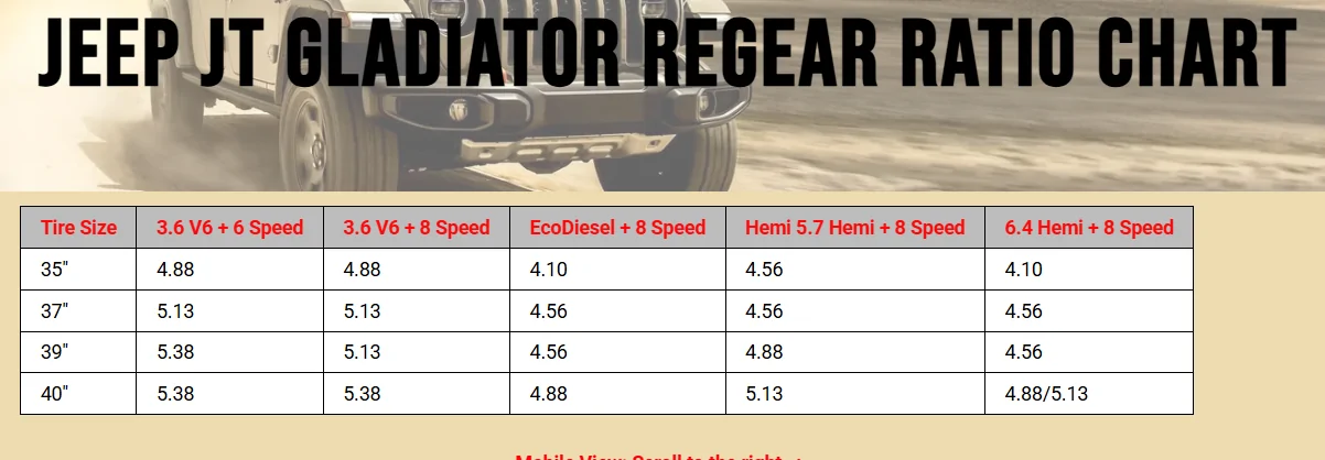

I have a 21’ JTR. Currently it’s in 37 ko2’s. It really isn’t bad at all drivability wise. I see 8th, sometimes it’ll hunt a little but I don’t think it’s that bad. Having said that I do think it could be better, and a little more resistant to hills and wind. I do tow on occasion. Over the summer it’s a small utility trailer and mower about 20 miles once every week/or every other round trip to mow my other property. We also do occasional camping over the summer and I pull a 1500lb popup camper. Usually 2-4 times a year. Tire wise I won’t ever go above 38’s and may stick with 37’s since there aren’t many 38 options I want to pay for outside of milestar. I live in NY, 900ft elevation and it didn’t change a ton around here.
what do you think would suit me better? 4.88 or 5.13

Well if you’re going to be driving in Colorado in hilly terrain I’d go for the 5.13. That is assuming you may want to go to 38” tires at some point in the future too. For flatland driving you can go 4.88. But you also said you’re going to be towing so go with the 5.13.

5.13’s if you tow, 4.88’s if you don’t.

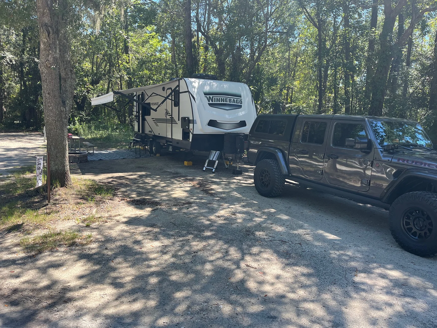

I tow a 7000 lb travel trailer with 35’s and 4.88. I would think you would be fine with 37’s and 4.88 with what you tow. 5.13 would be more than I need. 4.88 allows me to see 7th gear towing heavy loads

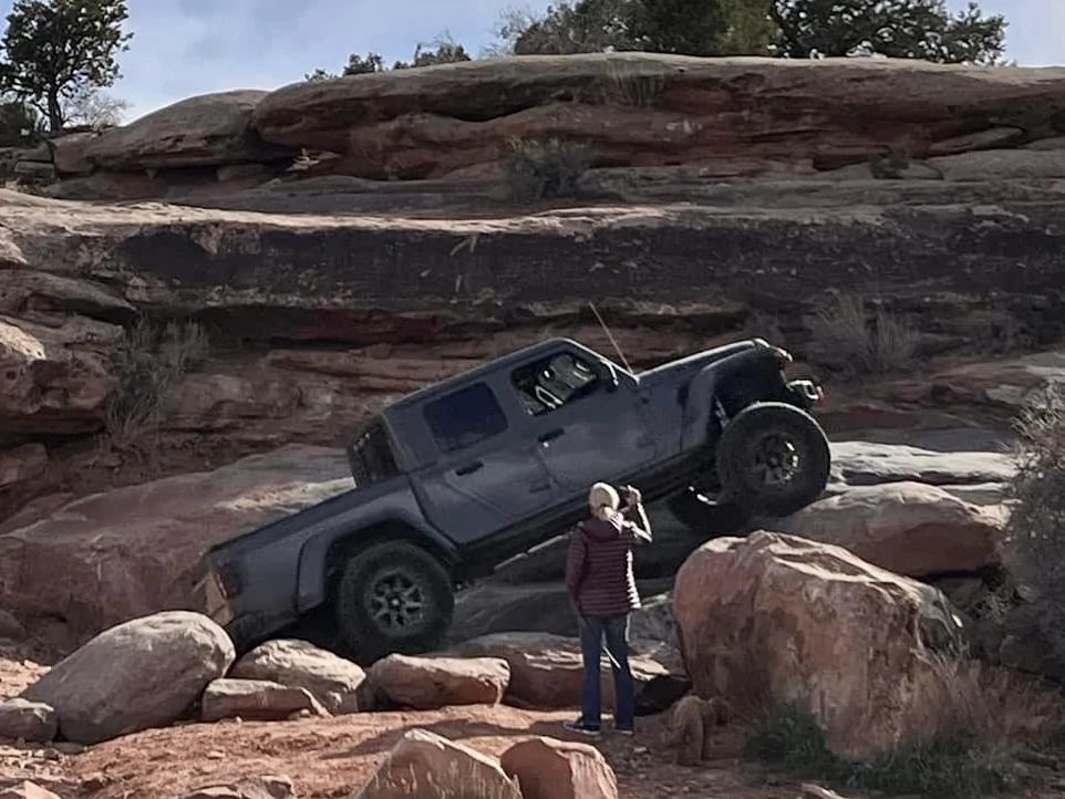

Jeep Gladiator Help me decide 4.88 or 5.13 for my use IMG_0265
MaximusTX
Sep 15, 2023
701
1,004
TX
This is what my local shop Exodus 4x4 recommends
Jeep Gladiator Help me decide 4.88 or 5.13 for my use 1766931958585-z7

I’m back and forth. Day to day I almost feel like the 4.88 would be better. It’s mostly a driver and is quite lightweight (all things considered). I would like to get it offroad more but who knows. With 4.88’s I feel like it would drive great how it sits now. I feel like I just need that little extra oomph to make it perfect. But my concern comes when one or a combination of these happen:
1. I switch to a heavier 37
2. I switch to a a 38
3. I tow
4. Road trips where the speed limit is 75-80
it seems diameter has the most affect for gearing but I’m sure weight matters some. A 38 of course would be a bit larger. Towing while not an every day thing does happen on occasion and I don’t want it to suck while doing it, but I don’t want it to suck daily driving it because I made it better for towing. With 5.13’s and 37’s at 75 you’re at ~2500 rpm which is quite close to the 2700rpm where the hi lift cam kicks in and I’d like to stay out of that for extended driving.

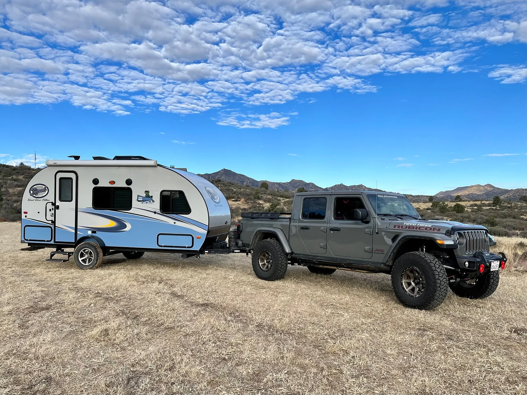

I have a 2021 JTR on 37’s, and re-geared to 5:13. I also tow a 3600 pound camper plus gear. I wheel hard and often travel with and without the camper through the mountains. I would absolutely recommend 5:13’s when planning to tow and/or pull grades through mountains. If you plan to tow and pull the camper through the mountains you will not regret 5:13. Your daily driving mpg will take a slight hit, but you’re on 37’s so expecting good mpg’s is unrealistic anyway. I get about 16-18 on average, 10-12 when towing. Smiles per gallon…
Jeep Gladiator Help me decide 4.88 or 5.13 for my use IMG_3966
Jeep Gladiator Help me decide 4.88 or 5.13 for my use IMG_1856
