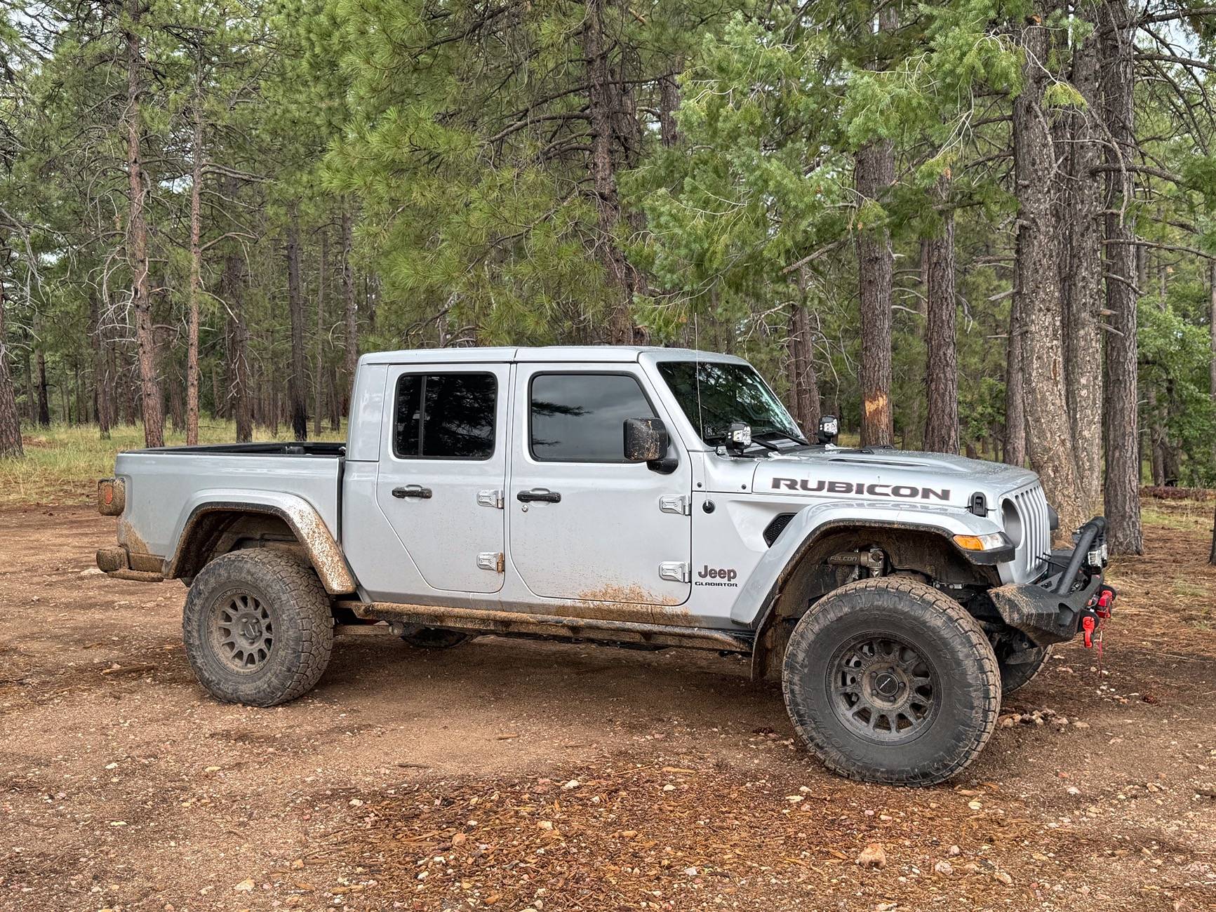

IMO - you are leaning correctly. Clayton 2.5 overland!! <<thumbsup>>. If you want some longevity - especially as it's an older vehicle with some miles - I'd opt for the steering options as well. you're probably due anyway. But beware, the stock wheels will probably not fit. Plan on replacing them with the correct backspacing / offset.
Below - Clayton 2.5" Overland +with steering replacements. Using the upper end Falcon shocks. 35" tires with Method Beadgrip wheels with a -12 offset.
PS - this setup will easily fit 37's as well.
