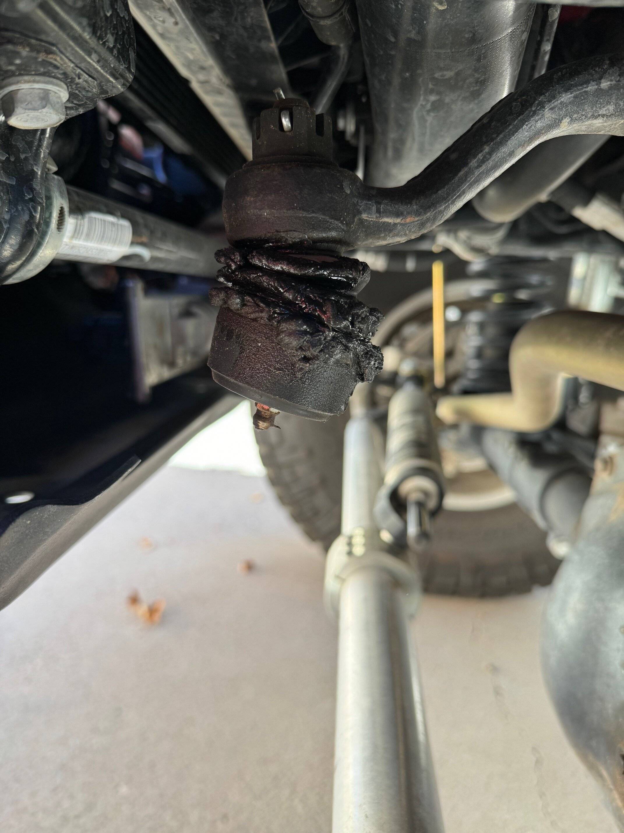

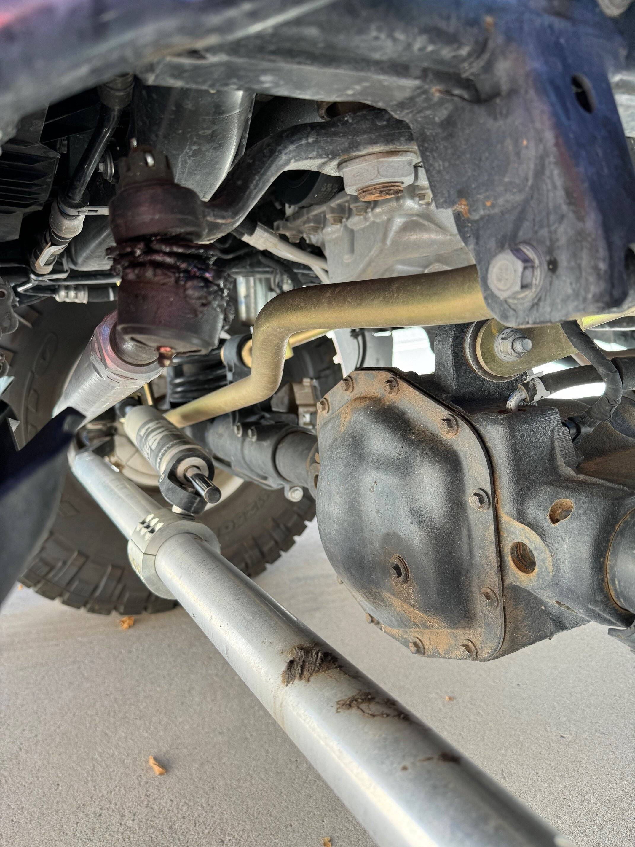

About three weeks ago I noticed a glob of grease on tie rod. I looked at the drag link and noticed the boot was covered in grease and that's where the glob apparently originated from.
Jeep Gladiator Starting to track down a wobble/shimmy stering 1
Jeep Gladiator Starting to track down a wobble/shimmy steering 2

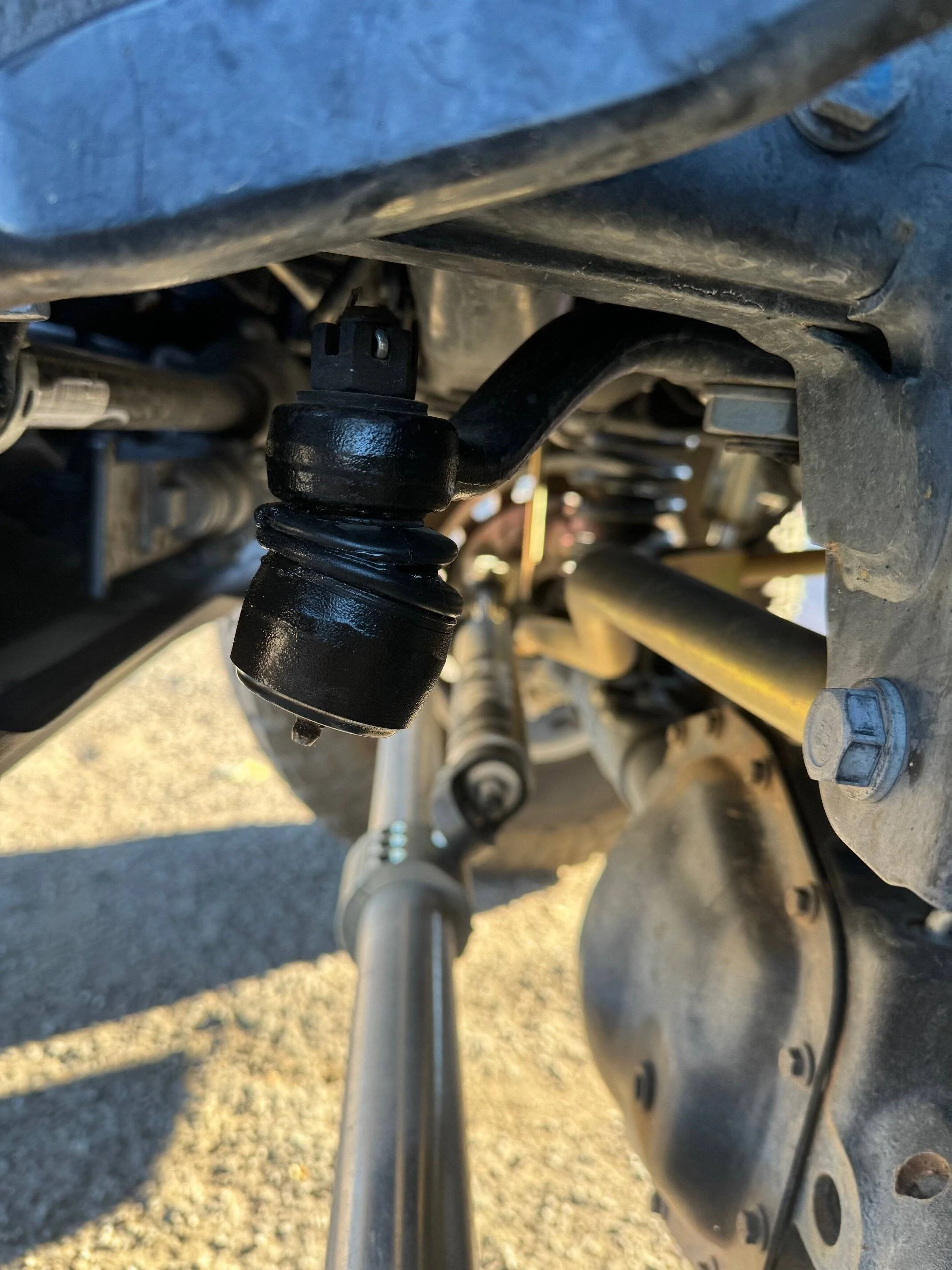

I wiped up the grease and noticed that the boot has split (can sort of see it in the top left of the "clean" picture below):
Jeep Gladiator Starting to track down a wobble/shimmy steering 3
My question is, does the angle look correct here? I'm not sure if the joint needs to be more parallel to each other and maybe that's why the boot split, or maybe the shop just filled it with too much grease? I have no idea if this might have been the cause or if it just looked off to my untrained eye?

I'm not going to suggest a cause, but general rule of thumb I was taught in college alignment/front end/suspension classes - try to keep any joints even with each other. In other words, if one end of a tie rod has the end sitting perfectly level, the other end should be as well. Otherwise you potentially limit the travel - one will hit the side while the other has room to move.
Possible it was "over greased". We always greased to the point of an unsealed joint showing the old grease coming out, then wiped up, cleaned up the grease, and semi-sealed boots - not open on the bottom like the umbrella type shield - we greased until the boot started to swell and just barely started force grease out. This ensured new grease in, dirty grease pushed out. With extreme movement, heat, vibrations and so on, the grease can be forced out. Hard to really "over grease" because the idea is to get new, clean, good grease in and the old dirty out of the way. A good suspension guy will clean up the excess grease.

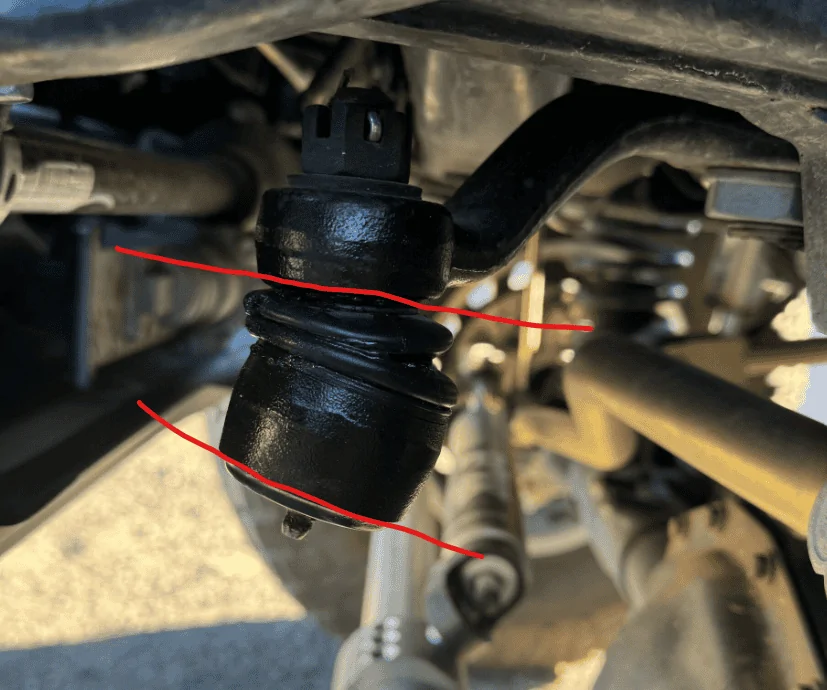

I'm bothered by this angle (pic below), but not being under and looking at both ends - looking only at this one, it seems to be rather severe.
If the other end is level and this one at this angle, that would bother me even more.
If both ends were angled like this, not so much, but still, if I draw a line down through the center of the tapered stud and down through the joint, this seems off.
I'm only offering things that "bugs me" and am not suggesting any cause. If it was my truck, I'd do more looking and digging around.
I'd look for play.
The grease could be the result of that joint being "hammered" by the extreme wobble. The the joint is being smashed back and forth, left and right, against the "stem" inside, forcing grease out.
Check for damage at that joint.

I just checked my lower ball joint nuts and they were tight. My drag link joint that connects to the pitman arm is not canted like yours though. It is parallel to the pitman arm joint. Hopefully your shop figures something out for you.
