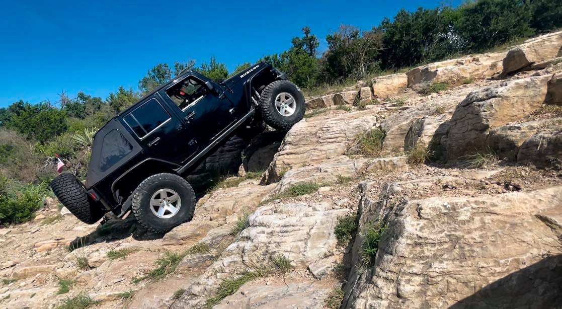

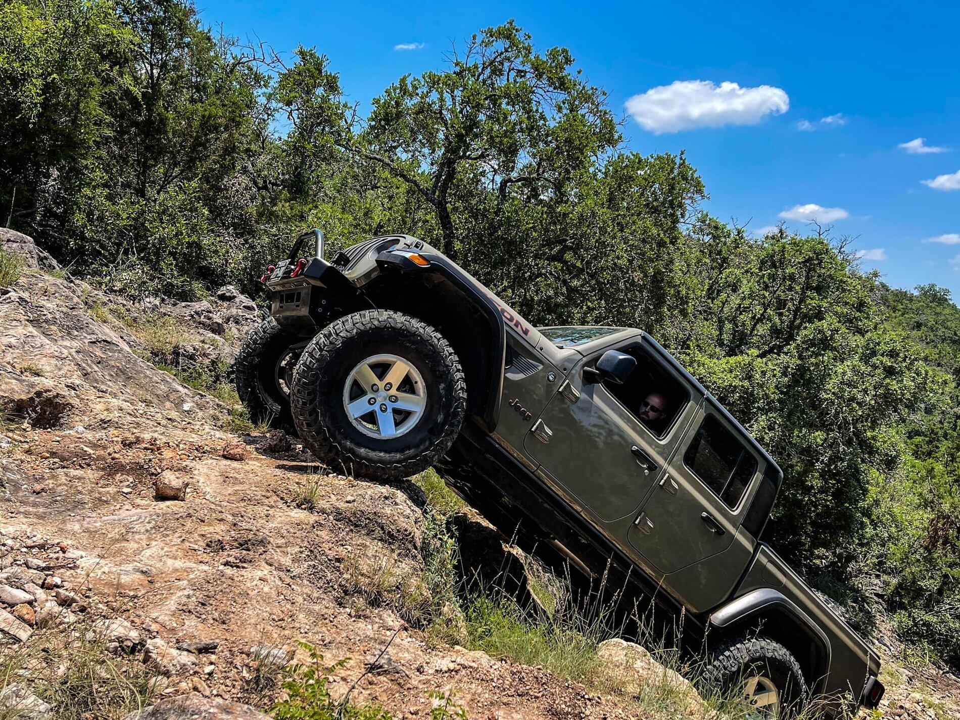

Meanwhile I actually wheel all year long with people doing it and have never seen a failure. I wheel on 39s with my JK and JT (2nd and 3rd gen D44s)....and while I opted to upgrade the JK housing to a Pro Rock (stock one was fine to that point, I just opted to do it)...I STILL have the stock 2nd gen D44s guts (stock axle shafts). In 11yrs they still haven't broken. Both Jeeps have 5.13s. But cool video link, I guess.
Hold your breath...I'll check back in the thread if I prove myself wrong, lol. I'll be out on the rocks Friday...I'm sure everything will fail.
