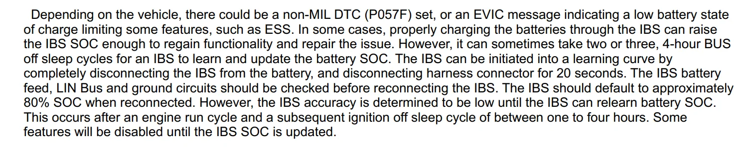

You had it on a NOCO the entire time - depends on what charger it is, the batteries may not have been "fully charged". Most don't do a great job of floating a battery once charged, and not all have the push to fully charge. They are "get by" chargers.
Best bet would have been to use a charger of at least 5 to 10 amp and start a fresh charge. IF yours charged then went into a float mode - might not have been enough to keep them up.
It generally "relearns" in a few hours.

ALWAYS fully charge new batteries before installation.
Voltages that low - meh, not a great sign for either battery.
Frankly, I'd put two NEW batteries in instead of one that's been that low and has any age on it with a new battery. Not a good mix
The relearning isn't a big deal. It will have learned so fast it's not worth telling people - hey, we're in learning mode and who the heck is even going to know or care anyway?
Two new batteries and be done with it.
Charge both first, then install.
Allow a few hours (not days, hours) for it to relearn.
Get a batteryminder type of device that is made for maintaining batteries - too many chargers charge fine, but for maintaining while sitting - not very good.
