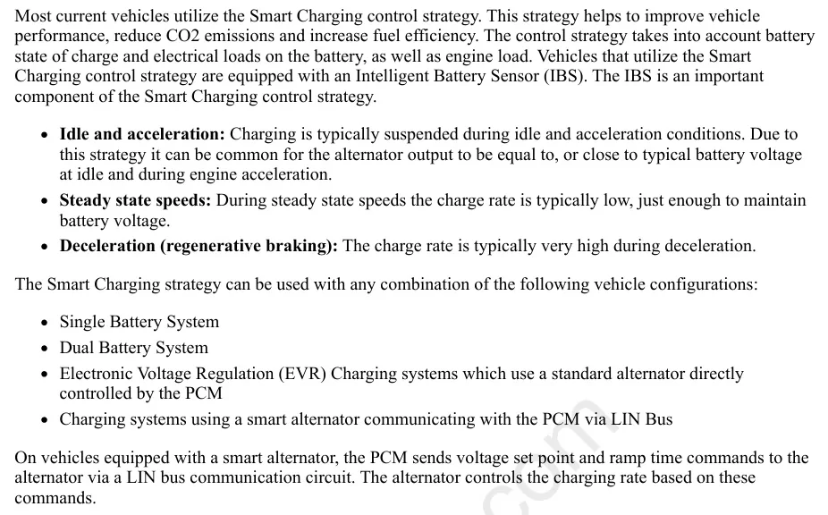

A voltage display at idle and normal cruise of roughly 12.8v indicates your battery is fully charged and in good health. A constant voltage reading of around 13.5-14.5v on these new smart charging systems would indicate either the battery is low/in need of charging, battery health is questionable, or the electrical loads on the system are high so the BCM and PCM is setting the target voltage of the alternator high to meet the elevated demand. See this excerpt from the service manual:

Stop getting hung up on the varying voltage. Very normal. It will range from 12.6 with fully charged batteries when it's warm and the engine is under load up to 15.0 when the batteries are low and/or it's cold and there's little engine load. They do not regulate constant voltage -that's old school methods, those days are gone gone gone.
I've seen 12.6-12.8 on long trips when the temps were in the 80s, and I've seen 15 at other times. .
