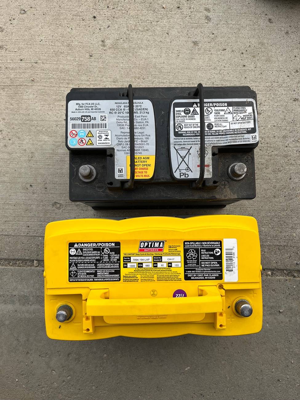

How I look at having the ESS on all the time would be unnecessary wear and tear on the starter. This is why I just push the button and shut the ESS off. I did upgrade both batteries but then I just know to expect to swap out the batteries after 3-5 years. The batteries are in a constant state of draw and charge when running or draw to run the modules when the engine is off.
My Mopar batteries didn’t last that long but the factory main is pretty small and the space can handle something much bigger and better.
