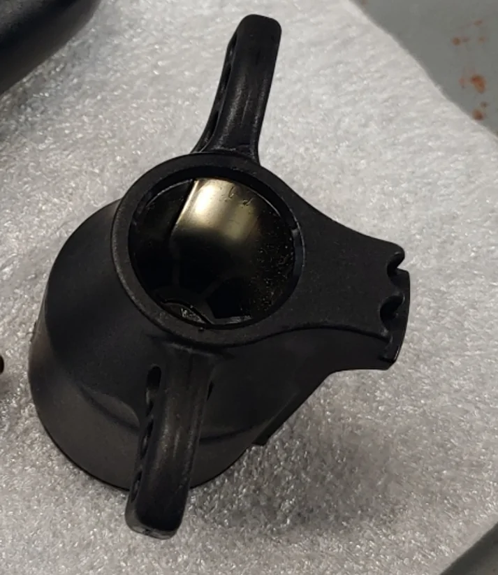

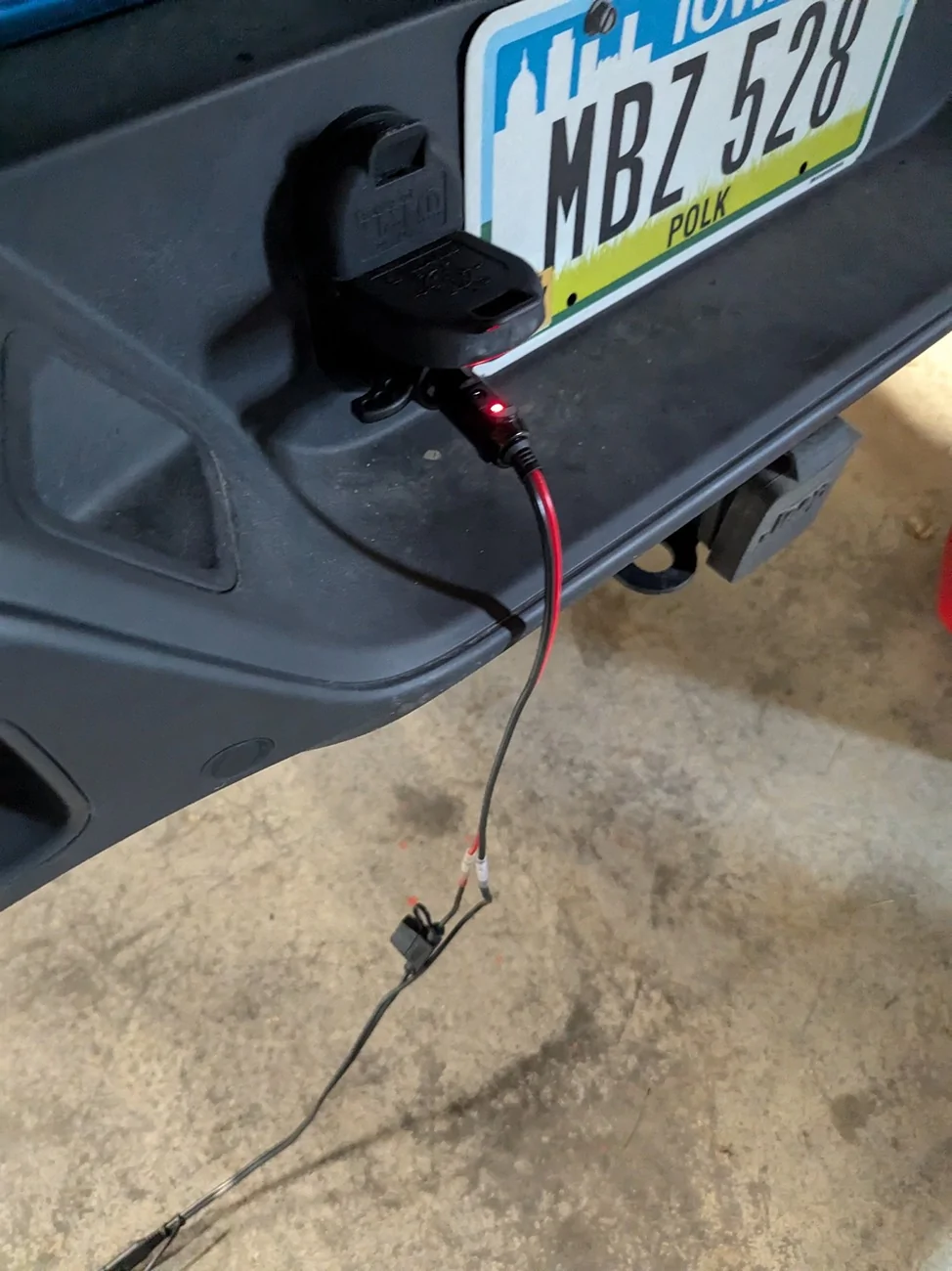

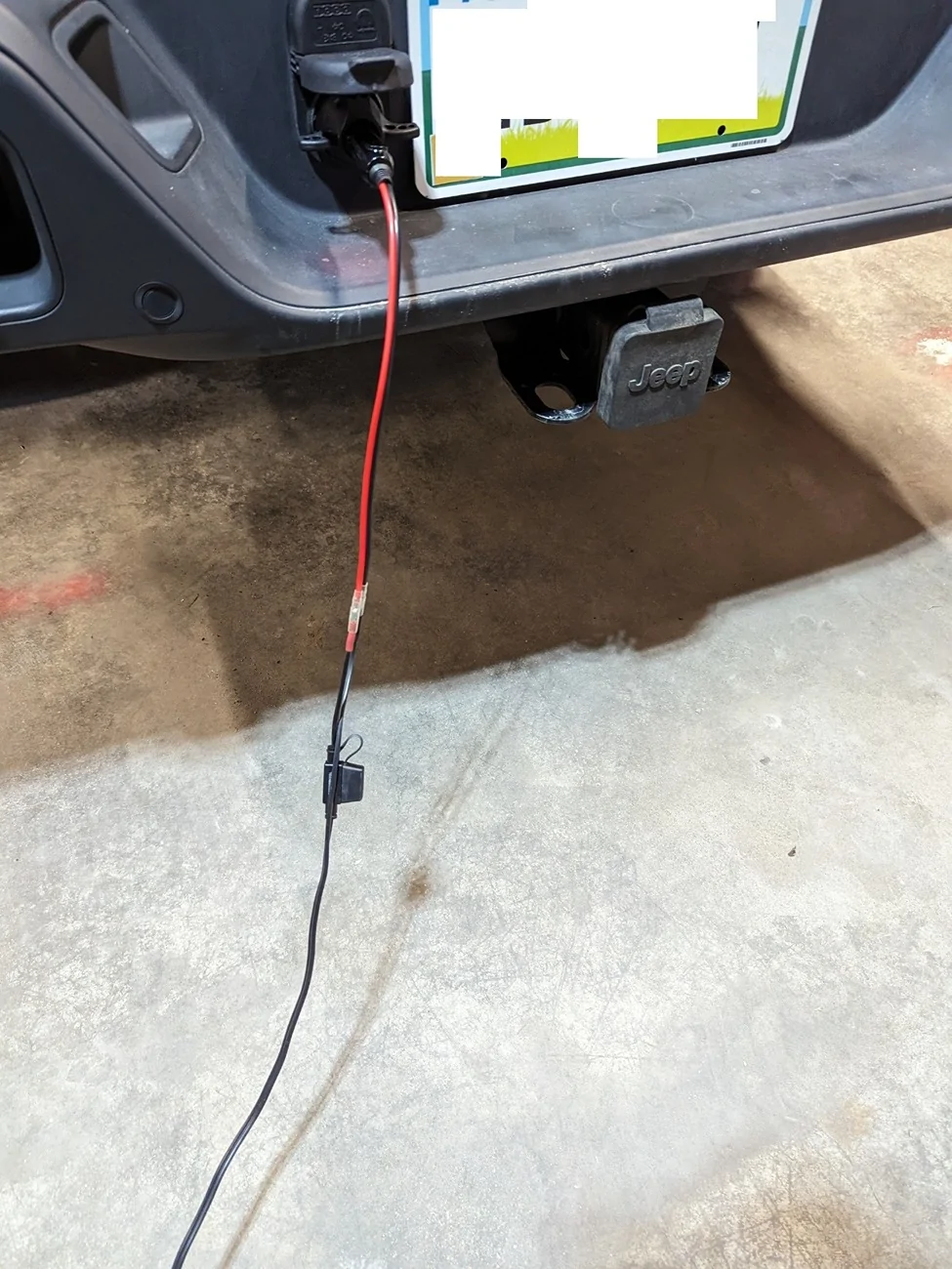

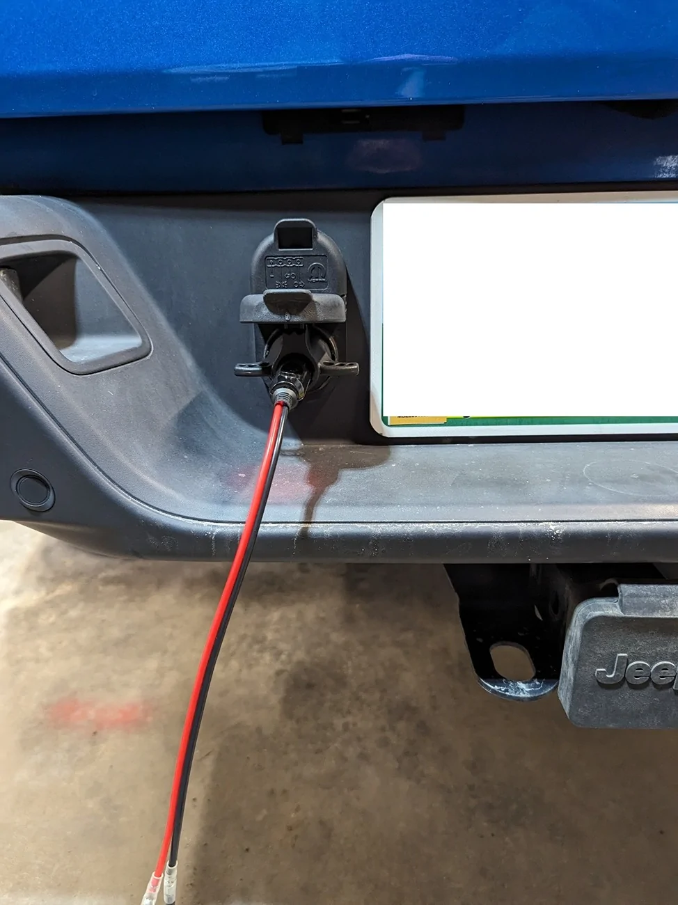

I'm restricted to just sitting around after surgery, and oxycodone has me in a good mood (if not a bit sillier than usual) so here goes -
You can get adapters that turn a trailer plug into a 12v outlet. That's what I used for convenience.
Then I made a connector with a 12v plug to put on my battery charger cables.
Two reasons - my mother called me the absent-minded professor as i was growing up as I'd take off out the door for school without my shoes and socks on............ forgetful.
I figured if I forgot to unplug things, the plug would pull out of the 12v outlet adapter plugged into the trailer plug as I drove out of the garage. You can do whatever works.. and if you need more info, we can do that, too.
This method means it will charge both batteries, and goes through nothing but fuses to get to the batteries. No need to open the hood

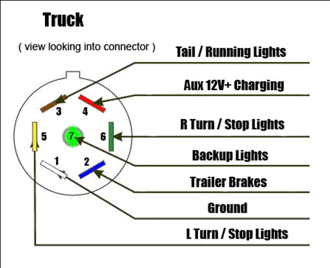

This is the view looking into the connector in the rear of your Jeep. It's standard stuff - so if you flip up the cover and look in, this is where things are -

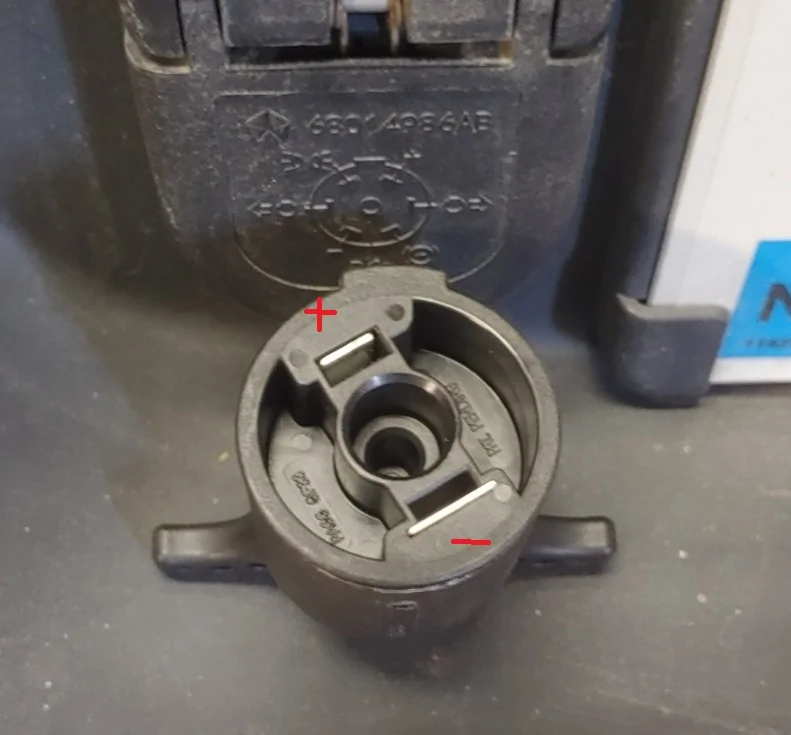

And this is the adapter that plugs into the trailer connector and turns it into a 12 volt outlet sort of like a cigarette lighter would be -
