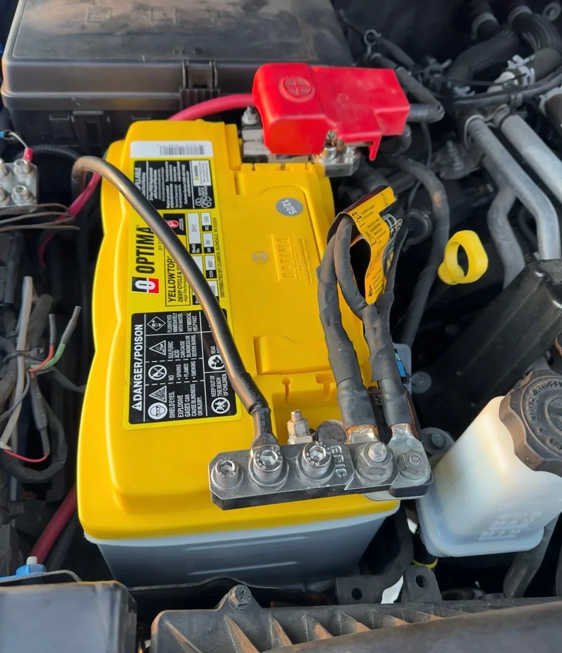

I just did mine today. Truck would not start without jumping it so I bit the bullet and grabbed an “Odyssey Alternative” and pulled both the main and the Aux. I have had great luck with Optima. I taped up the pos and neg of the Aux and pulled Fuse 42. So far no codes or lights.
Where do you get the extra buss bar from?
EPIC Adventure Outfitters, they are in Canada so shipping took a little longer. Super happy with it as it gives all kinds of places to install. Mine could still use some cleaning up.
