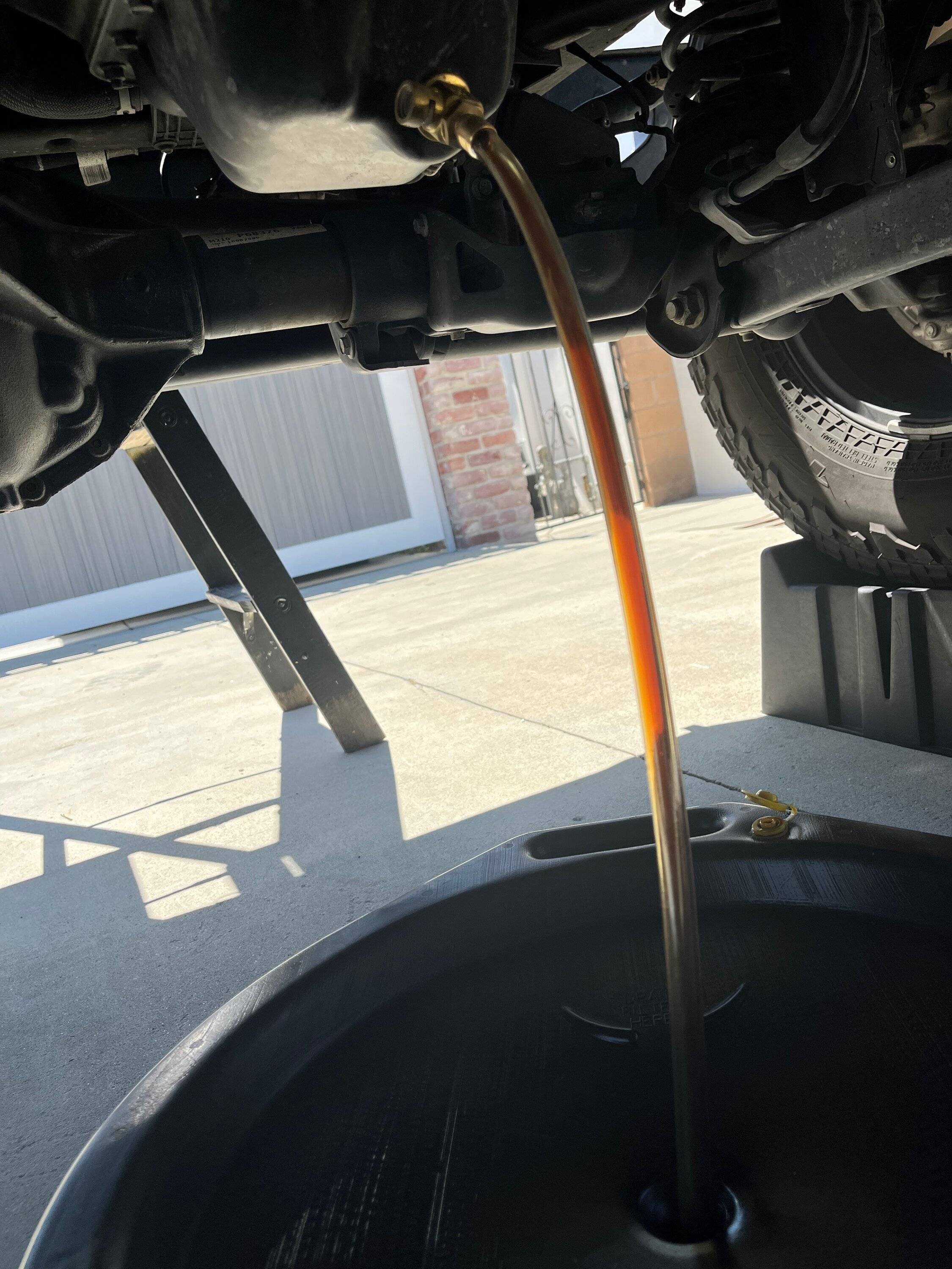

Resurrecting this old thread because I changed my oil today. I intended to change it at 33% life remaining. One thing lead to another and it got down to 25% and I KNEW I needed to change it....I didn't make it. Today it indicated 17%, yikes. I used Mobil One 0-20W and I've been using Wix filters since I owned my last truck, a 2014 2500 Denali.
Anyway, reading my records it turned out to be over 11,000 miles between changes. I'm very uncomfortable I let it go that long. The last 500+ miles this past weekend was on a round trip drive of over 5 hours each way in 24 hours
Jeep Gladiator How many miles do you change your oil? IMG_9708
....if that is of any interest.
Last change I installed a Fujimoto valve and it made the drain SO fast and clean. There is a clear tube on the valve in this picture. I literally didn't get a drop of oil anywhere other than into the container.
From now on I am thinking I'd better change at 50%. I use to make the changes at 4 to 5,000 miles.

Why yikes? That oil really looks GOOD.
That computer tracks more than any of us can when determining life. Granted, that's high, but it's not a yikes for me.
Since most of our trips get things good and warm, almost no short trips where it's not very thoroughly warmed up, and no short runs, little stop and go, I'd not feel bad going well over 5,000 miles.

Seeing how low that valve is below the pan is going to give me a nightmare tonight. No way would I use one unless it was protected by a skid plate.
