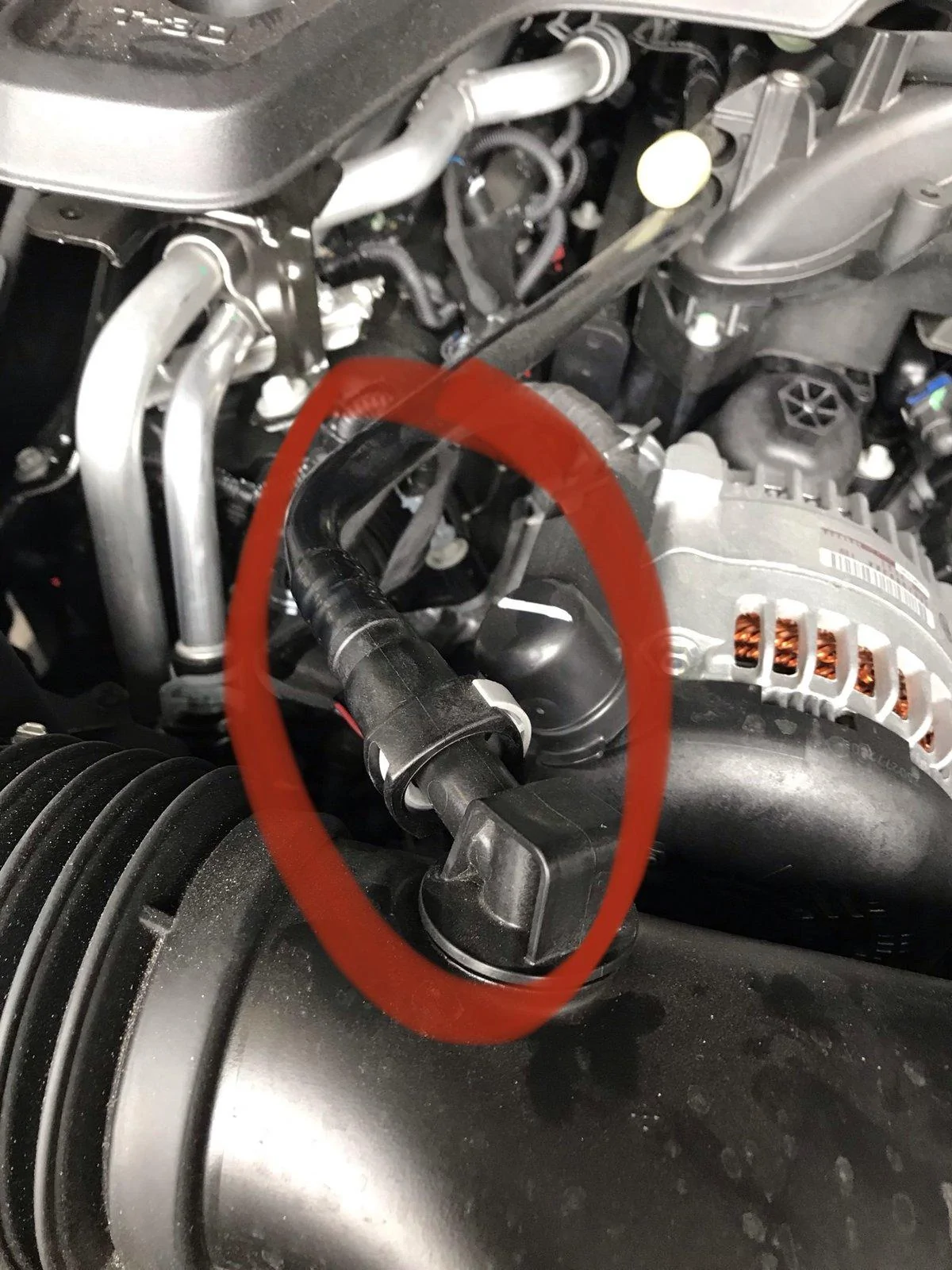

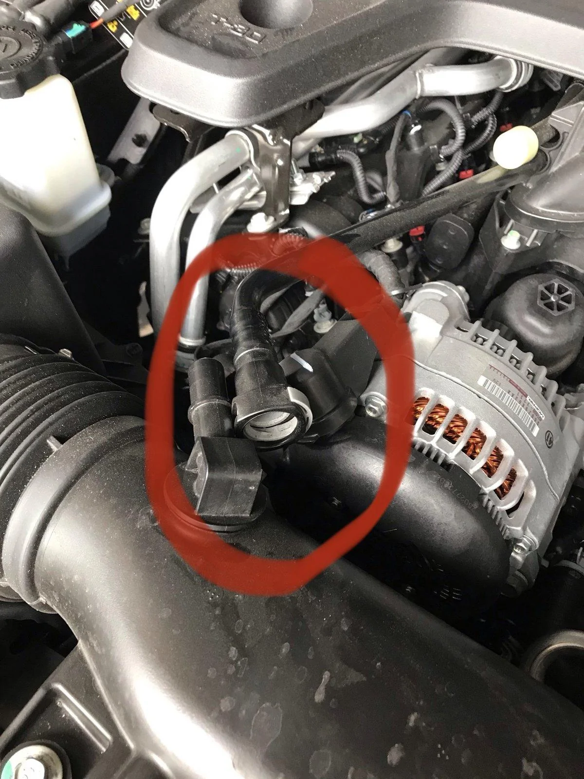

Just had my first oil change done at a local Jiffy Lube. Truck is right at 6,000 miles. Manager there immediately pointed it out to me that the PCV hose was not connected. This had to have been factory sloppiness. It’s not a big deal, will hardly affect the engine performance. But still pretty bad to have a new truck get shipped out without this being connected. Y’all might want to check your trucks to make certain they are connected.
Damn, that was the factory. Luckily I opened my hood the day after I bought and my hose was disconnected. I plugged it back in and sent my salesman an email about their PDI skills.

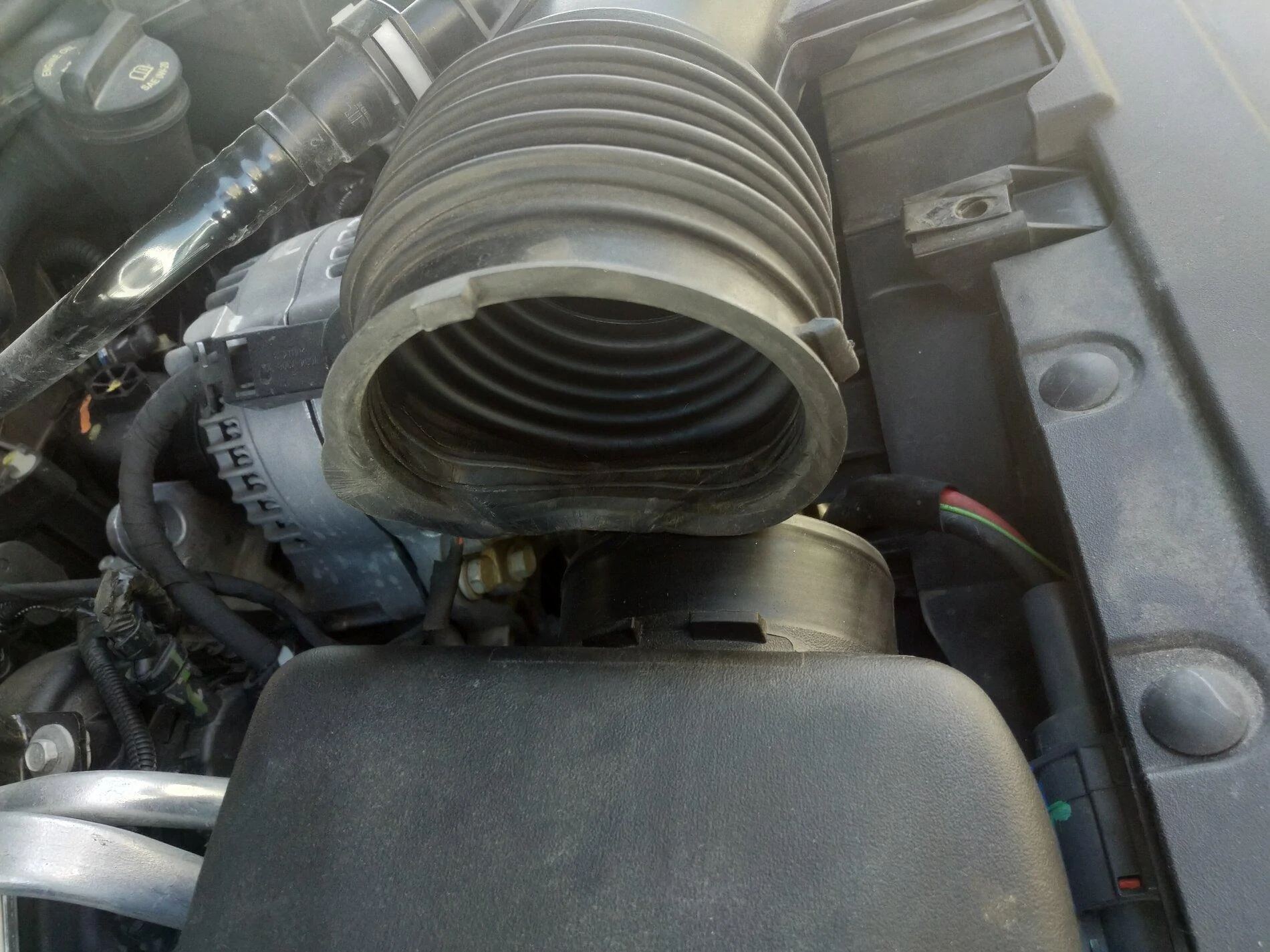

I hadn't noticed until I was installing my winch a couple weeks ago, the dealership on their last oil change didn't seat the air inlet back on the air filter outlet completely, and then cranked down the worm gear with the tube being deformed. It's before the MAF, so the JT had adjusted and I never noticed any difference, but it had a small opening for unfiltered air to get in. I only have 1 more free oil change in my Jeep Wave package, so I'll verify they don't mess up again after the final one is completed.
